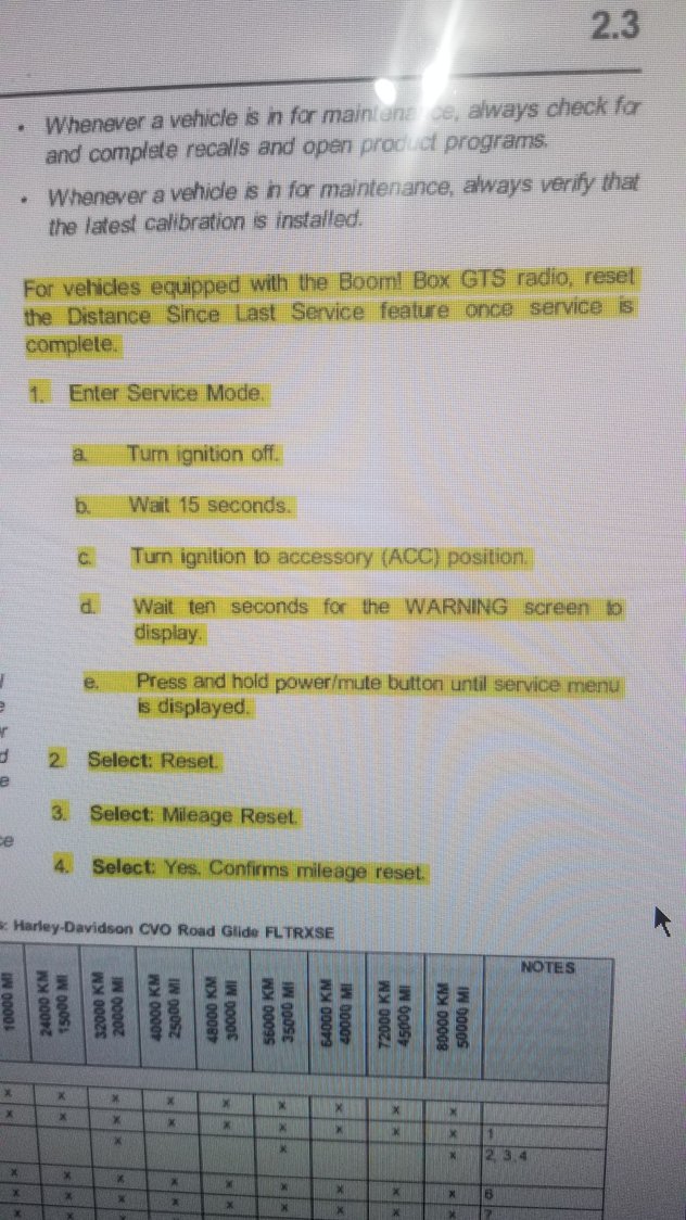

Step by step instructions are in your CVO maintenance schedule.
Old Jun 22, 2021 | 09:34 AM
Harrybeerbelly's Avatar
Harrybeerbelly
Joined: Nov 2017
Posts: 123
Likes: 47
From: Cleveland
OPE ... see attached
