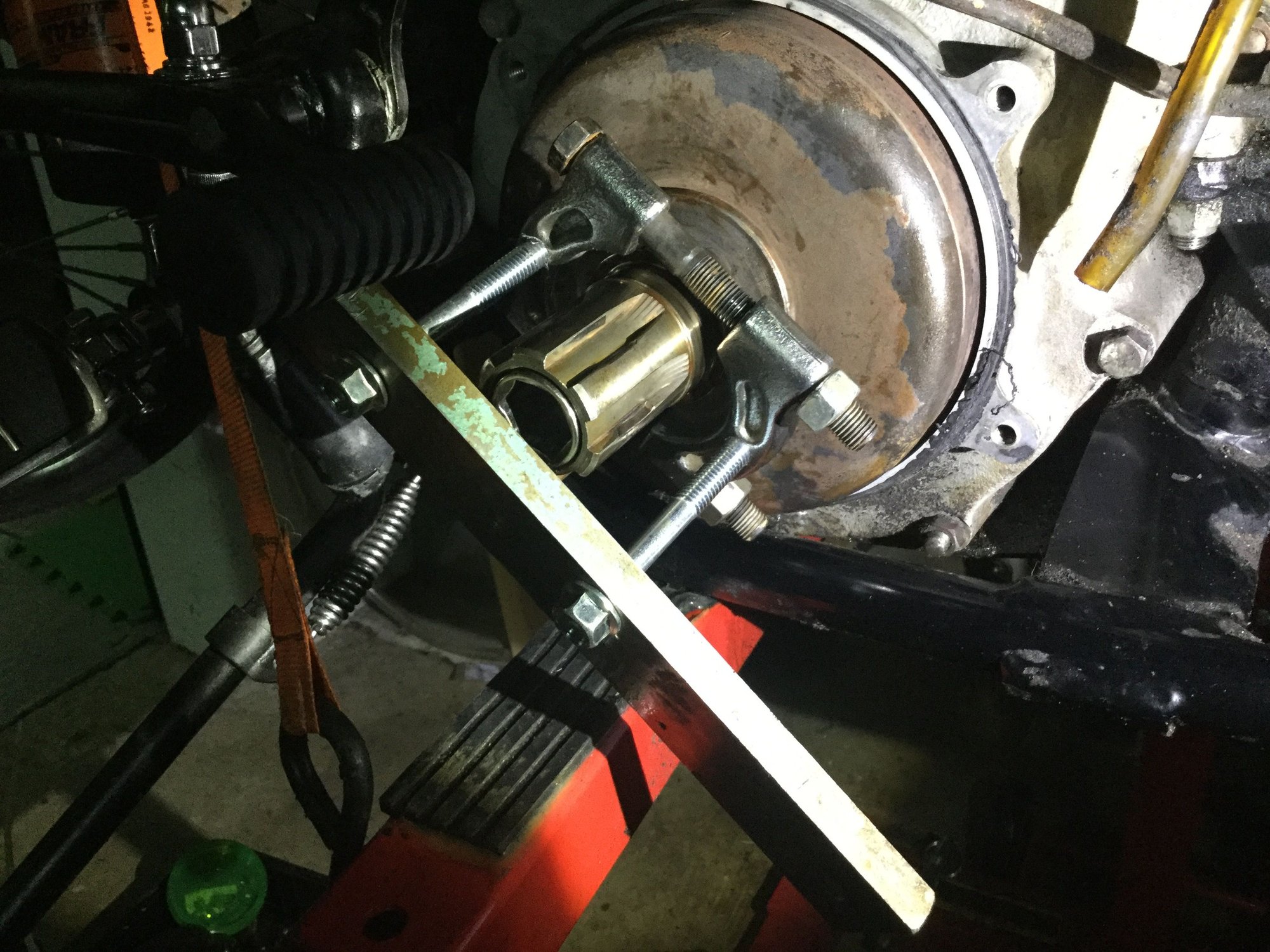

The compensator shaft should be torqued to at least 100 ft.#'s. It's on there. After I took off the inner primary, I took a bearing separator, drilled a couple holes in some bar stock and, voila!
Here's the only funk: take the largest socket that fits inside the shaft, put the drive end to the motor shaft. You need a socket that sticks out a 1/2-inch or so. That's what you push against.
Heres the setup:

Remember or take pictures as it comes apart so you know where any shims go back in if it comes down any farther.
The clam shell puller with a tee bar adapter and you push against the end of the crankshaft in the dimple or as has been posted . I have those chip when guys tried pry bars or chisels to work them out with so heads up.
