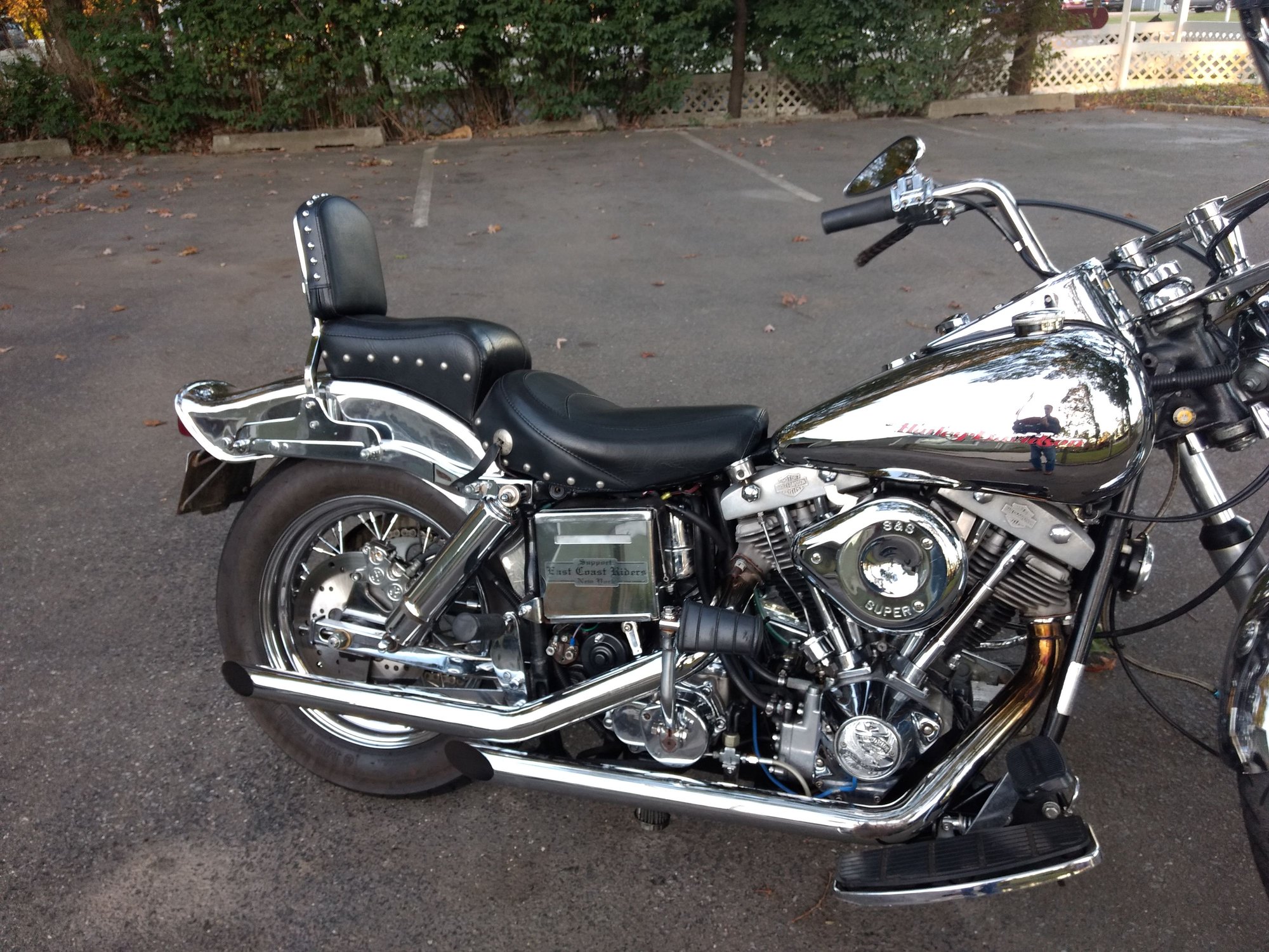

I had a Lapera on my 77 super glide and found a real nice Mustang on Ebay for a buck thirty... Nothing like a Mustang seat.... I know it's not an FL but Just giving you the idea of a better look and Feel...
Mustang

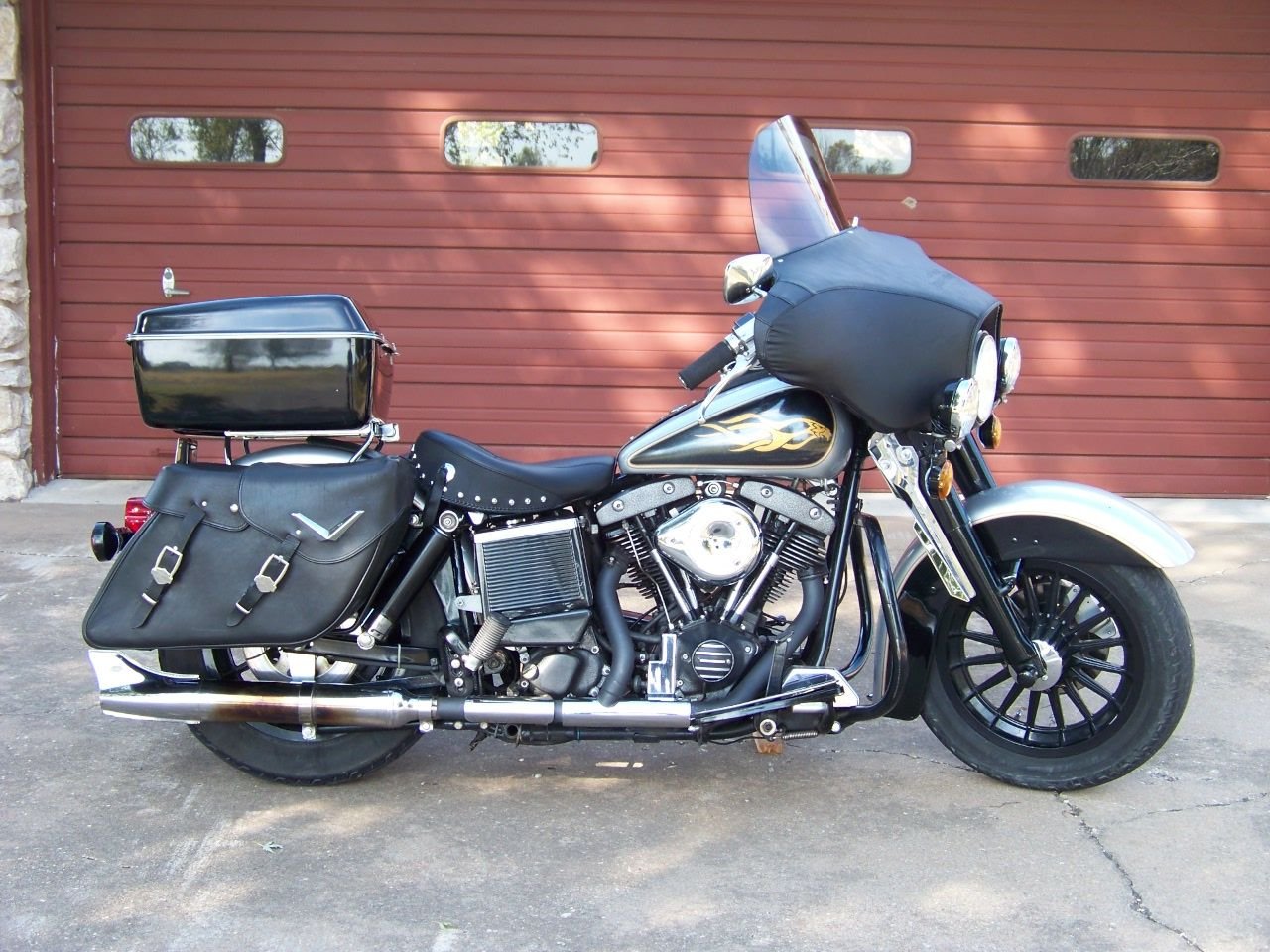

Mustang wide solo is comfortable and looks good. I had an old style solo on it when the bike was blue. On long rides the seat would cut into my thighs. The tractor seat was mounted on a pogo, but had springs on the back.
1980 FLH

I meant to say that the seat was NOT on a pogo. The pogo mount was solid to the frame but allowed the seat to pivot up and down in the back.
1980 FLH[/QUOTE]
