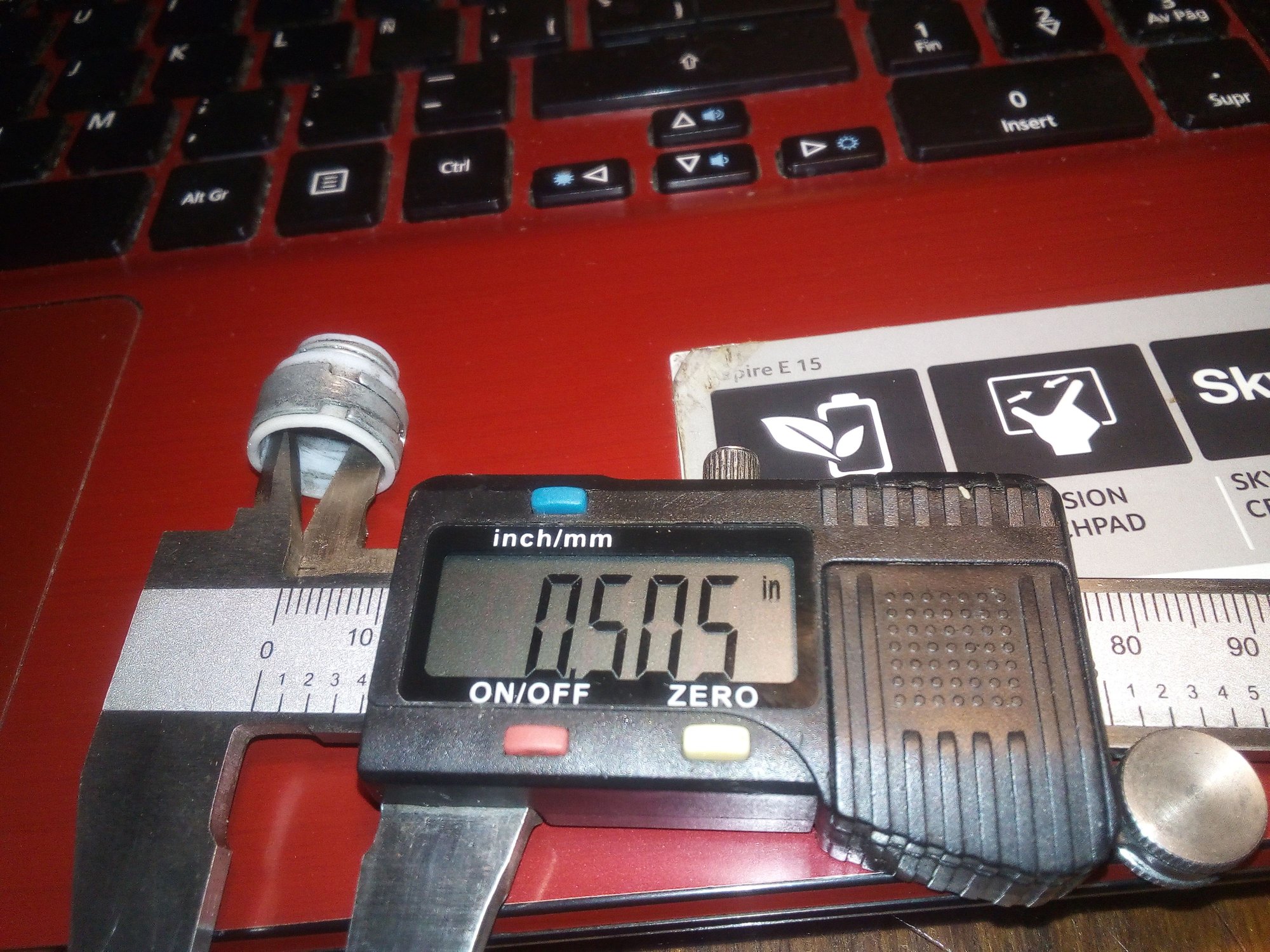

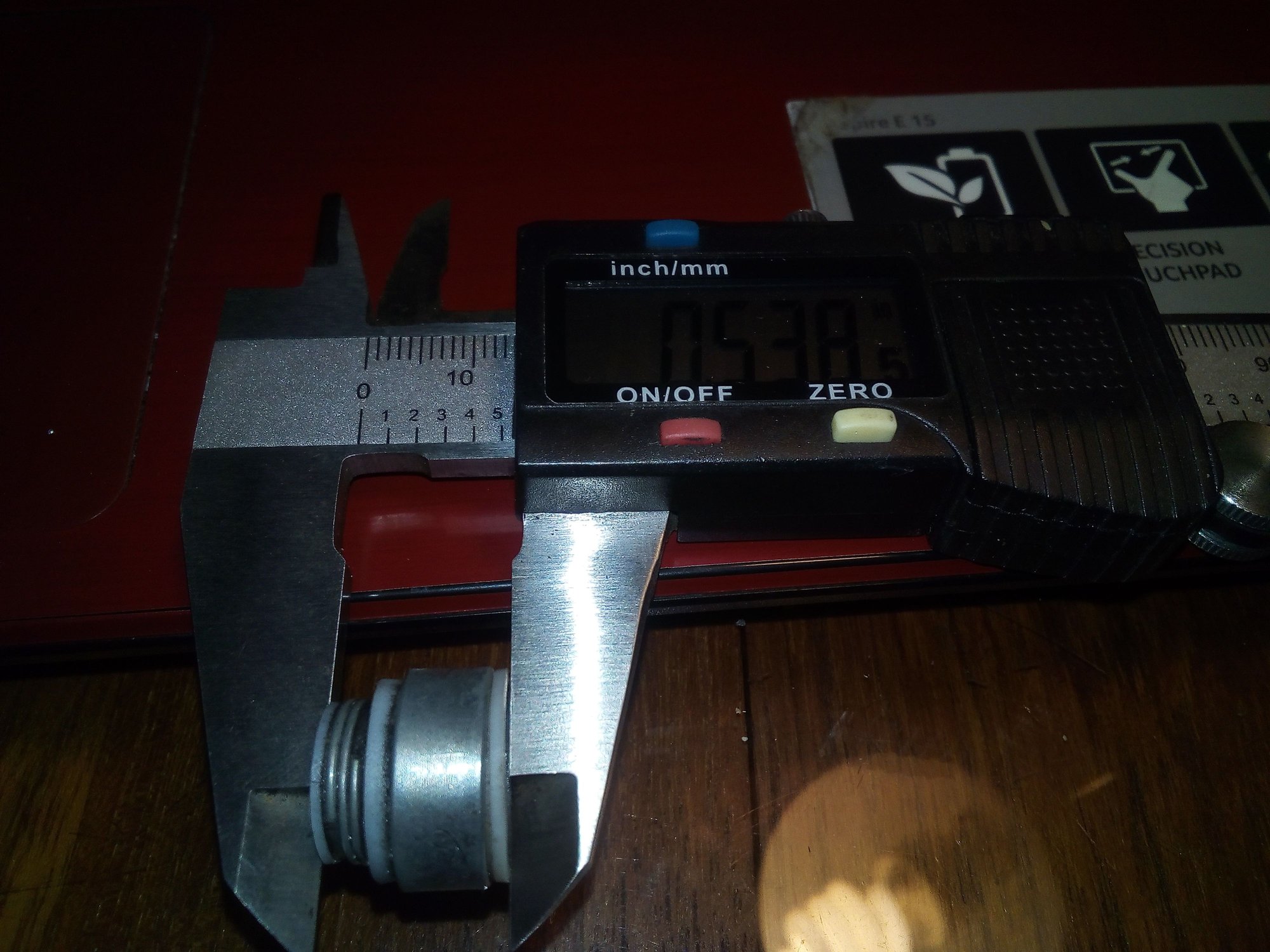

checking the Cometic head gasket kit buy to rebuilt the top end of my 80" 1979 shovel, noticed that the valve seals donīt match whit the olds
the heads are in the machine shop to fit new valve guides,self made like the old ones, definitely, I have new guides but I canīt find the seals, i looked for this in KPMI catalog and donīt appears, the only inscription in the seals is "CORTECO",, any suggestion? measures in photo attached

that's an old crane seal they had used years back - it is automotive BBC 3/8 stem - .500 guide top
79 was a transition period and 625 is the regular top for the seal and the Harley late seal is 625 to fit it - but its tin from most - we use the rubber seals today and a auto machine can help with that 500 if you want to stick with what you had
