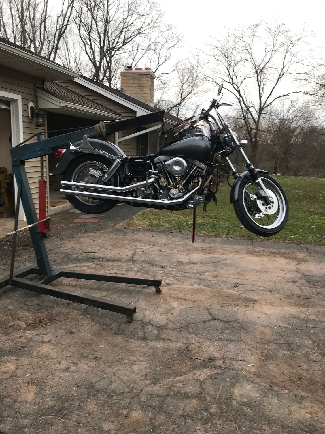

Got things started on the "FXS", LOL. Put the battery on a charger to check it out. Got it fully charged, 13.9 volts. Put it back in the bike and hit the starter, dropped to 5.3 volts. New batter coming. Pulled the carb and opened it up. WOW, gummed up bad. So bad, the check ball in the accelerator pump circuit would not separate from the spring. Every thing is nasty. Rebuild kit coming. The gas smelled like 20 year old turpentine. Had, (operative word is HAD) an in line fuel filter, opened it up and the "stuff" that is on the element is stringy. LOL
Soon as I get the parts, we will see whats up.
I'm not going to change the jets at this time. Owner said it ran real good up until it didn't. I'll wait and see how it runs after rebuilding the carb to determine if rejetting is needed.
More to come.

For ***** and giggles I took the cover off the cam cone to see what was hiding in there. Still has the points and condenser system. If I acquire this bike, it will be converted to electronic system. I have the Ultima digital system on my Evo and have had absolutely no issues in 20,000 miles and 4 years.
What is the "standard" to use on shovels? What works best?
Thanks

Given the condition you found in the carb and filter, what's the inside of the tank look like?
