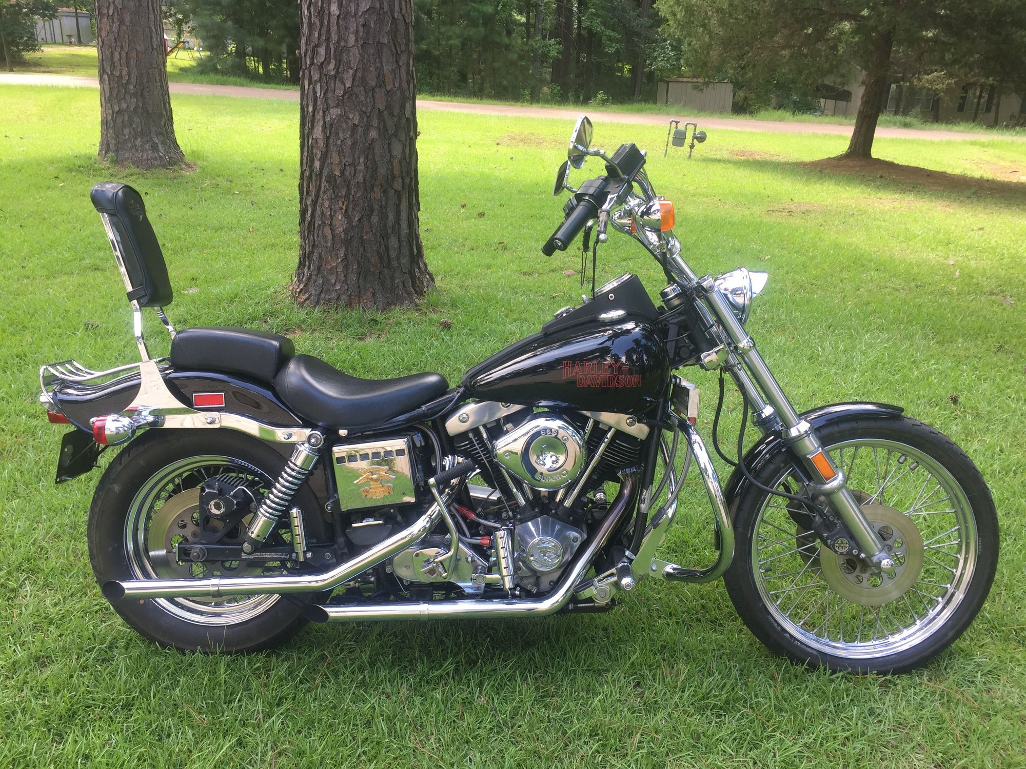

Shovelheads are getting rare but there still a lot of them around. Look at NADA value for that bike in its original condition. With a salvage title and chopped the scoot is far from being worth 10K. I have a extremely clean 1983 FXWG in 97% original condition the NADA value in excellent condition "meaning bought new and hardly ever rode" is $18,750. In very good condition it is valued at $11,025. Its a different animal trying to sell older bikes it's a matter of finding the right person who wants that bike.
Good luck on you decision.

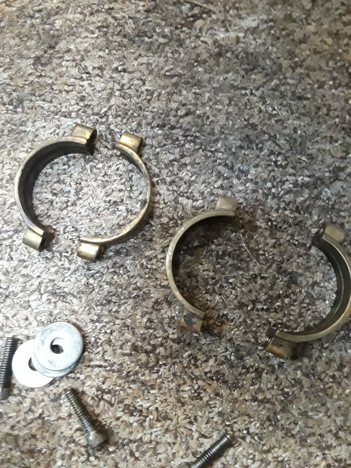

Anyone ever seen or used these intake manifold clamps? Never seen them before myself.

The old brass ones are the only 2 piece clamps I will use..Oring intake only...what's with the washers???
