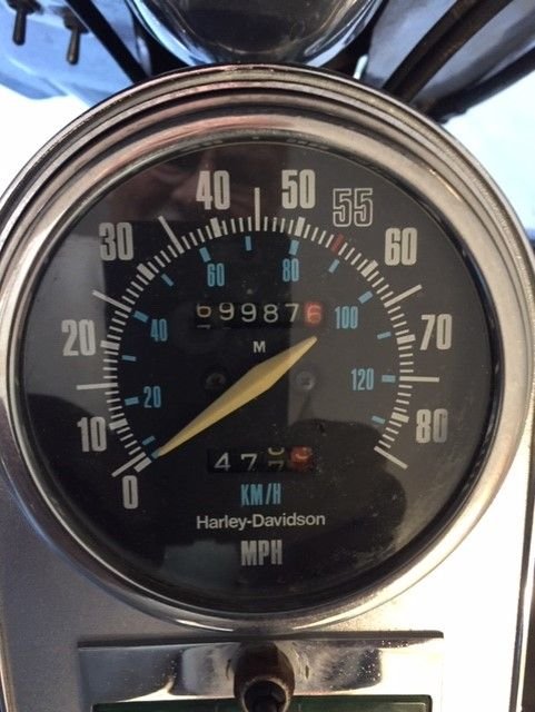

Mileage at the time I picked up my 1982 FLHC belt drive. Amazed how well it cleaned up and ran after being outside for several years. Typical 80 MPH speedo used at the time.

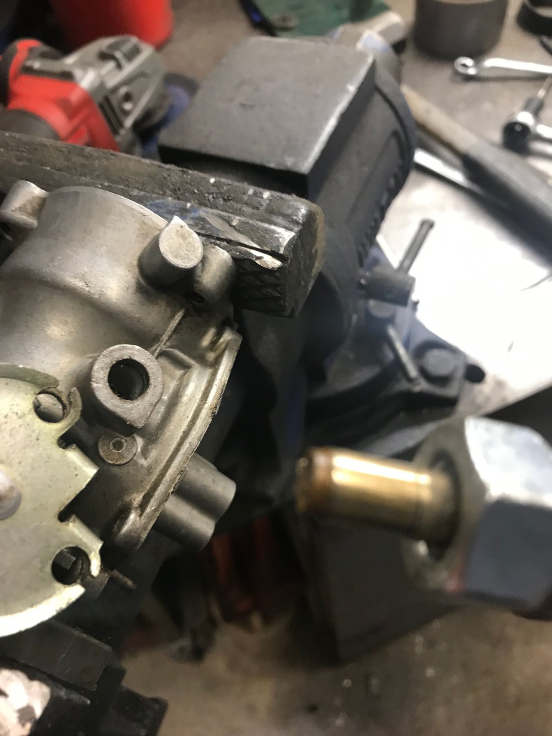

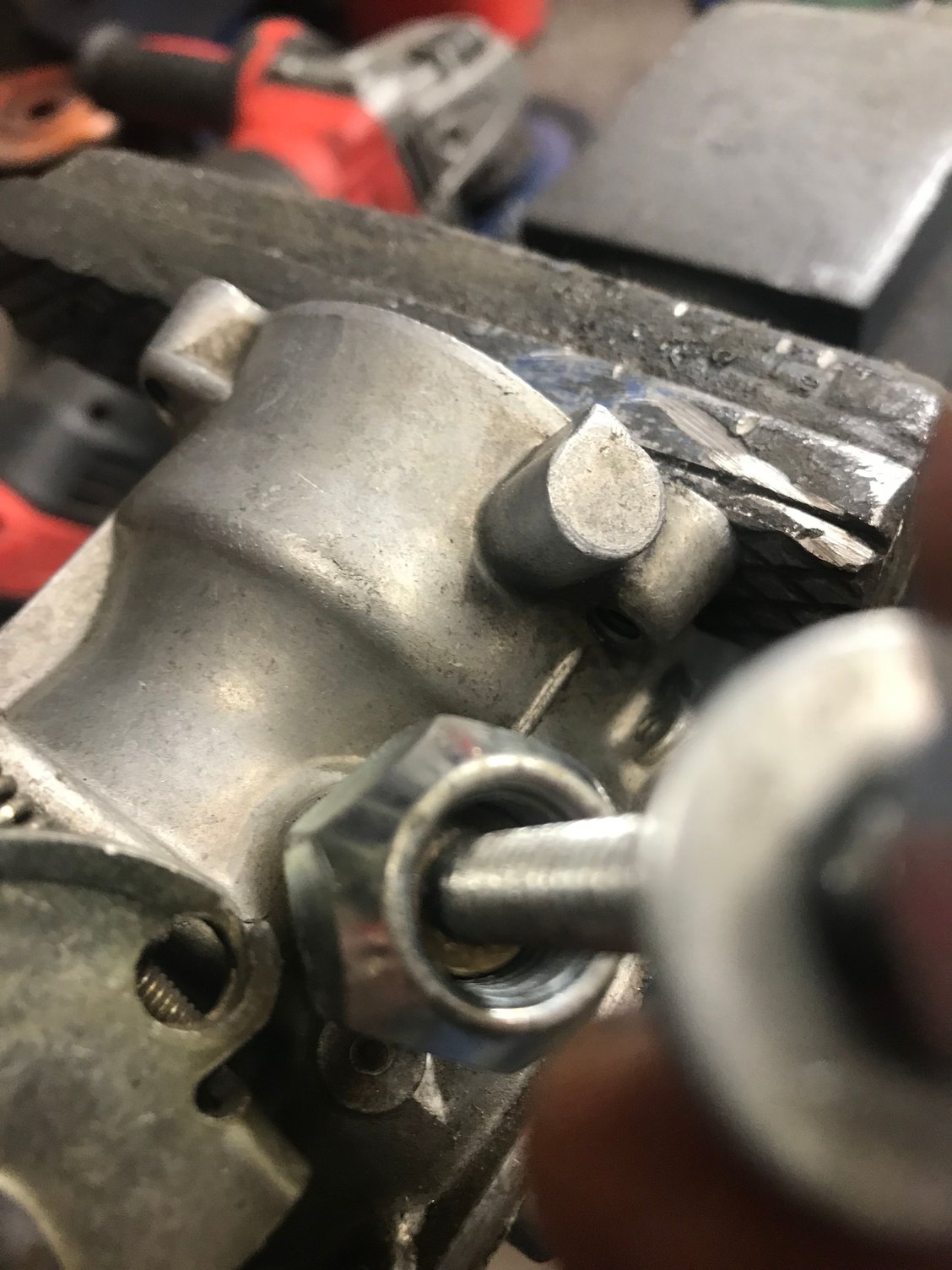

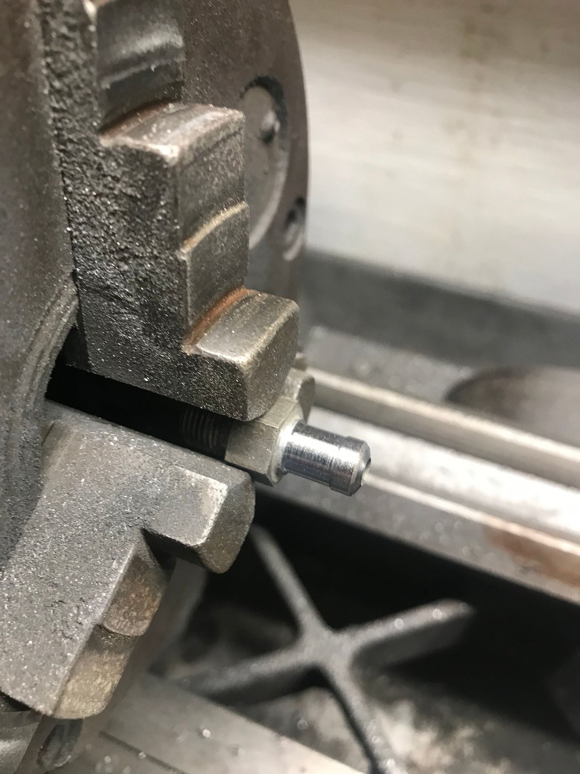

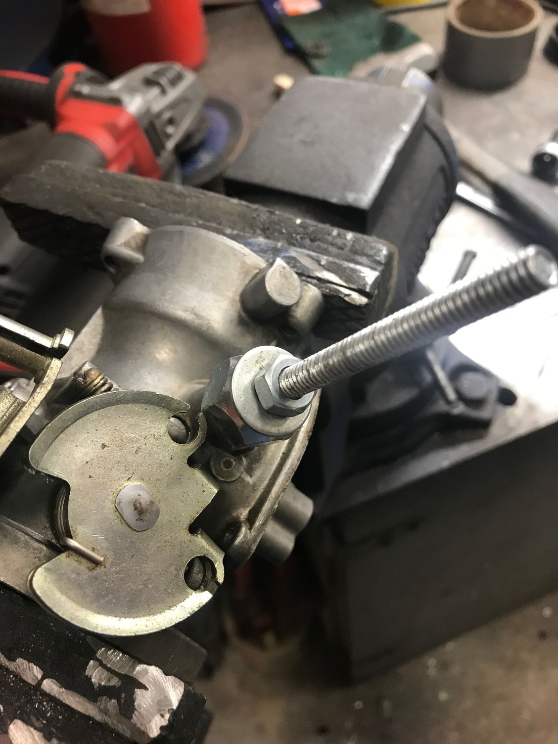

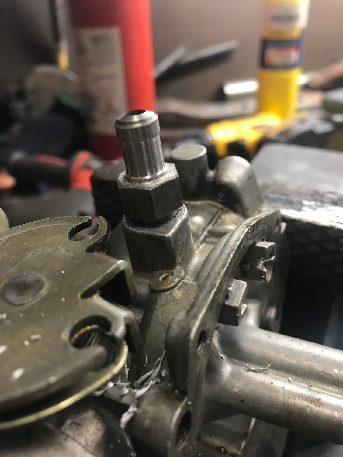

Tipical fuel leak out of plastic nipple....no problem. Tap 1/4 20. Pull brass out with 1/4 20 all thread and lug nut..Drill and tap for 1/8 npt Grab junk fitting out of scrap box spin it on lath turn nipple down to 3/8 for rubber fuel line. 15 min and fixed. To think we used to do this on the bike in a hurry when I was a kid........than guys made lots of money make no a kit to do it on CVs too.
