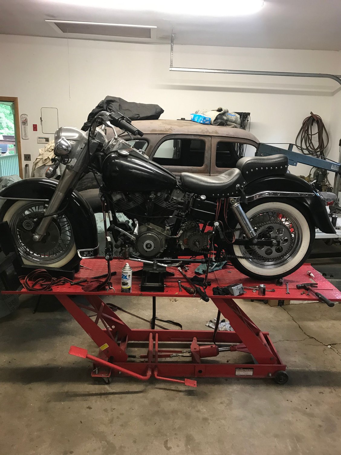

Well the ole b.tch got its turn on the table tonight ......now cleanup these parts . Swap,wheel bearings and brake pads..new battery. See how far we get tonight
see how far I get tonight before I crap out. Lmao....

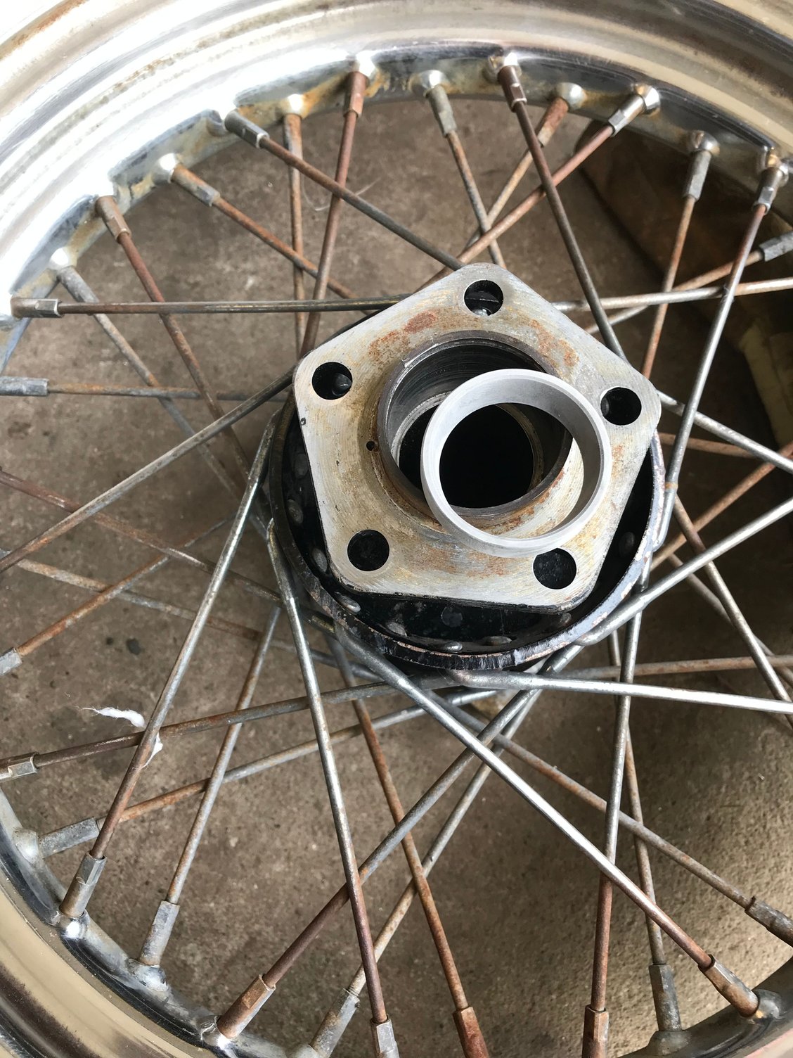

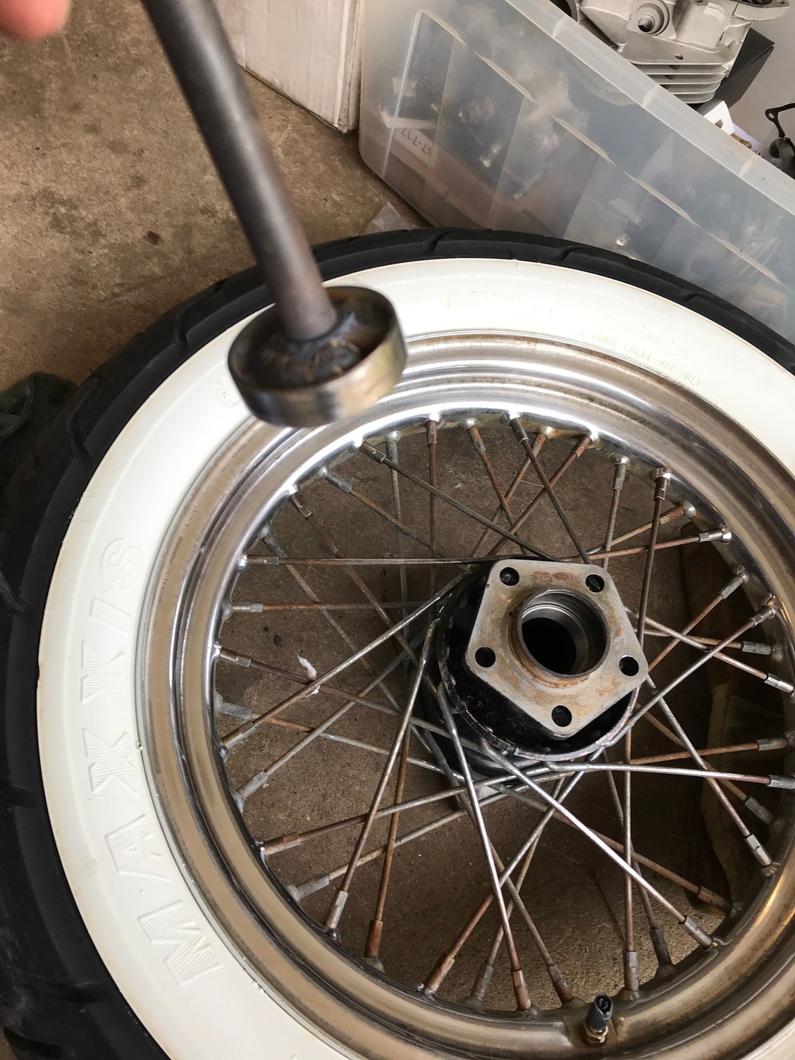

I am sure most know this. But simple seal and bearing race drivers made in just a few min. Weld washer and bolt on to old bearing race than spin on a grinder ,flapper wheel...I have lathe. 2-5 thou off makes a good driver if your sockets don’t fit.. I freeze all my bearings,bearing races.... they slide in 2-4 hits. Also if you have a welder. Weld a washer into a stubborn bearing race that bang it out quick while hot....comes out easy. Do all neck bearing like that so no damage in neck...l
And yes there is a block of wood under the hub...lmao

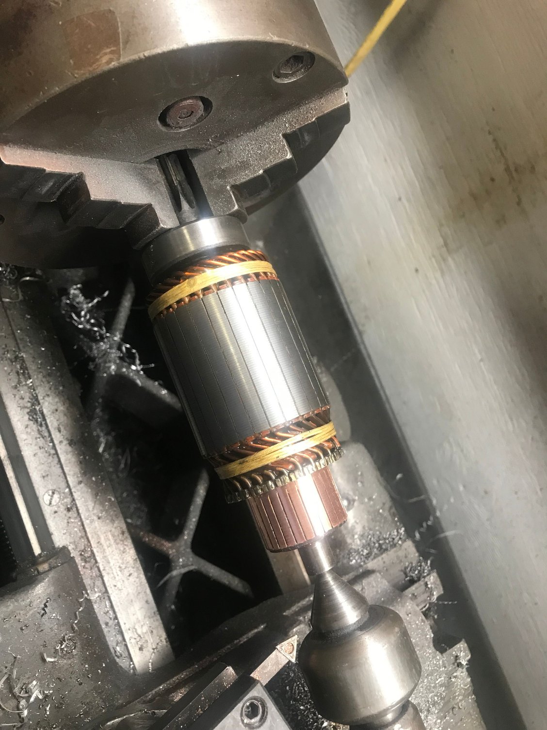

Why is it the tiny little clean up jobs get bigger lmao....... figured better cleane oil tank out real good. Junk all the oil lines. Next thing I know I hand the oil pump out...drilled and tapped hole for chain Oiler and primary chain Oiler and plugged since I did away with those. Plugged primary oil return in motor..figured all set. Nope looked at the starter had to wonder what was inside lol. Yep it needed to be rebuilt. Cut the arm.. At least I had the brushes bearings and bushings....cost a whole 8- 12 buck to rebuild ......I guess I need to stop now and just slam it together ...... lol
Gonna ride this SOB before Friday is over ...lmao
