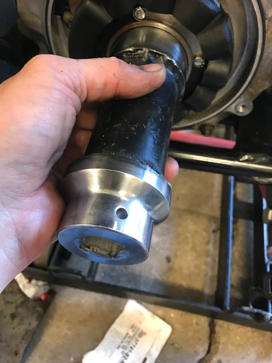

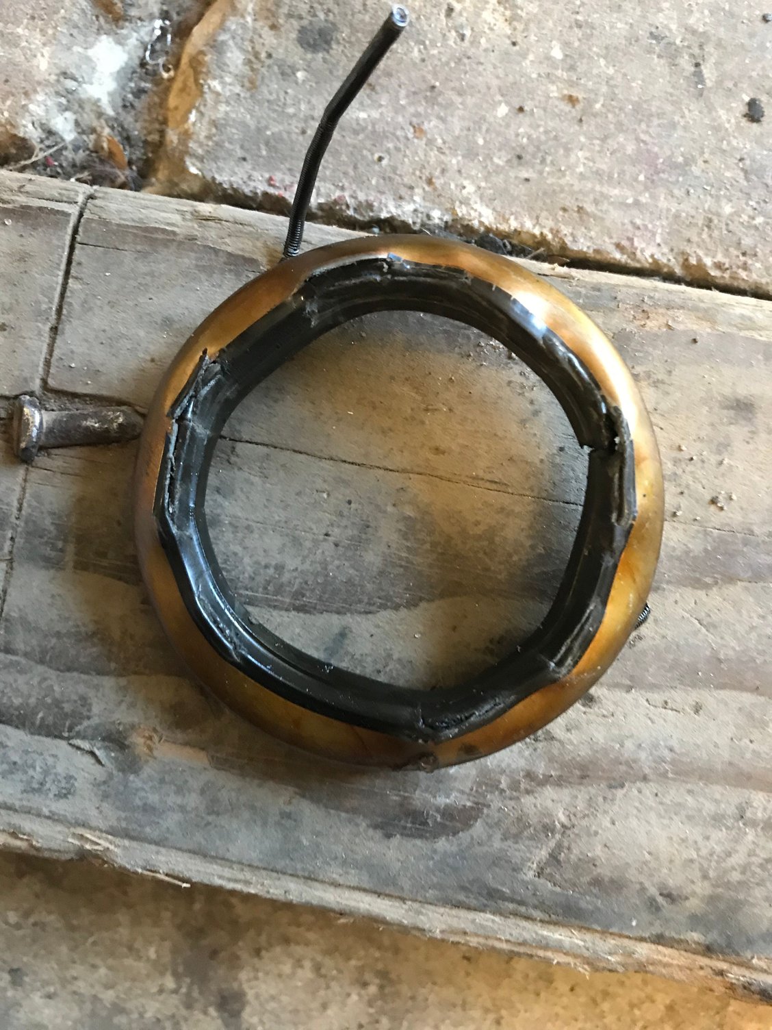

Most will know this. But I have changed a bunch of crank seals. Everybody tells me how hard it is. Or use screws ...BS...I have always used this method to remove seals on peterbilts,Briggs and Stratton’s Harley’s. Never failed. Screw driver around inside edge all the way around a couple times NOT even trying to remove . It eventually shrinks outer ring and just pops out. Don’t touch the soft case and try not to pierce seal..Cleanup spacer if not grooved .( or replace..just measure thickness some suck lately) Than years ago had to make this 1 7/8 clutch nut remover socket in Ohio helping a friend. SOB if it if it didn’t fit the engine case perfectly ( tractor supply). Kept it and brought it home . Ones I made in past never fit. Snap on Mac and sears. Took a seal down to tractor supply the other day with a friend. Sure enough it was the same. So we made him one( good friend).
Oh well out to shop see if we can’t start putting **** back on instead or taking off...lmao
