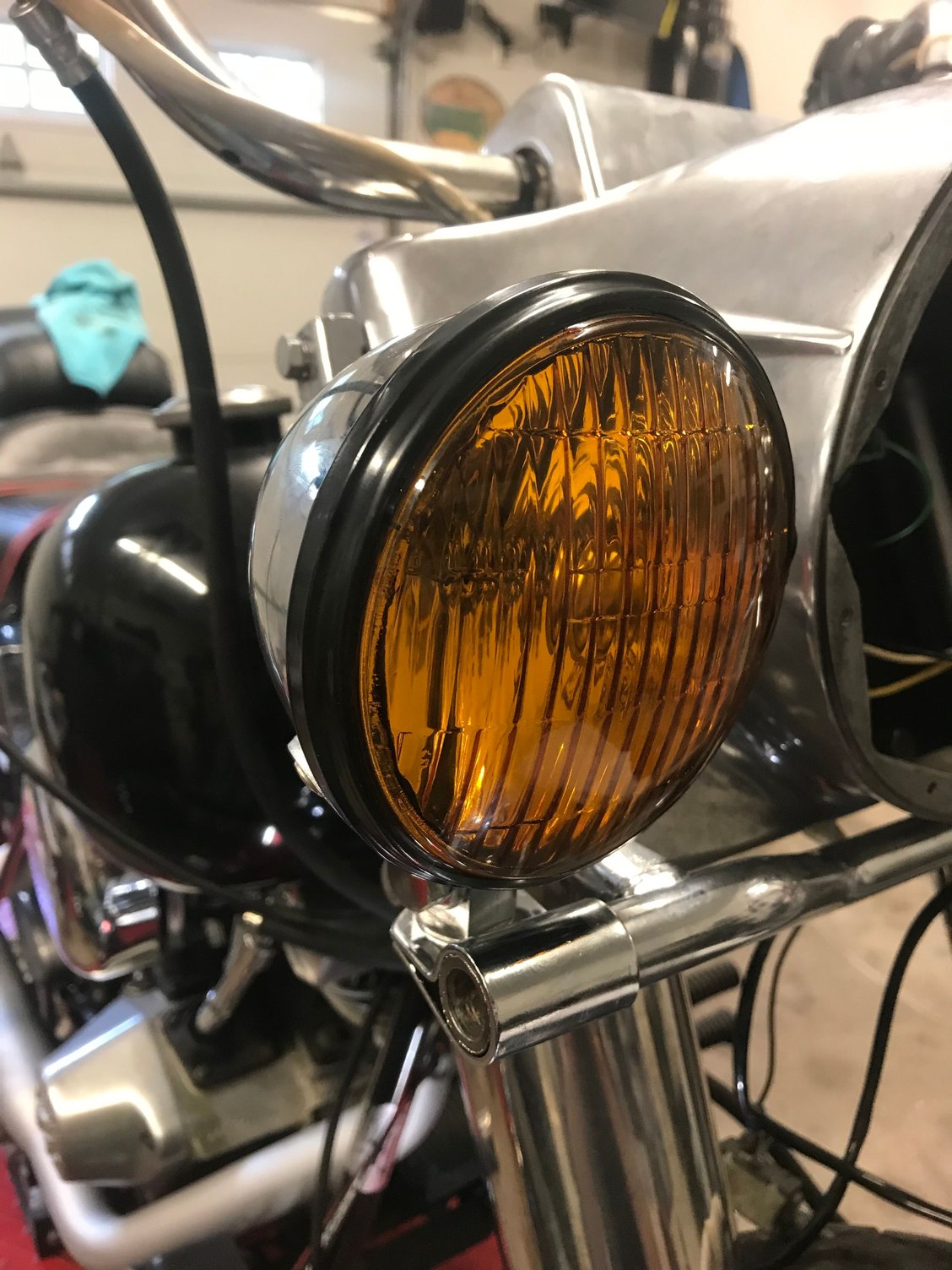

Well i finished it up last night.....now torn. Looked in paint cabinet.....have all the material including the clear. But all i have for base color is...seafoam green...yuk. Cant spend money on this pig.....little trick if you have had damn passing lamps turn a little and not line up...black tape. Than put the chrome on....they stay lined up for a long time. Maybe ill leave fender off and toss bike in shed till........Hey it runs good .....maybe when the 77 sells lmao

Thanks John.... here is the drill mark i make in bottom of passing lamp towel rack......i have a used bracket i use as a jig.... the allen screw lines up...no twist
