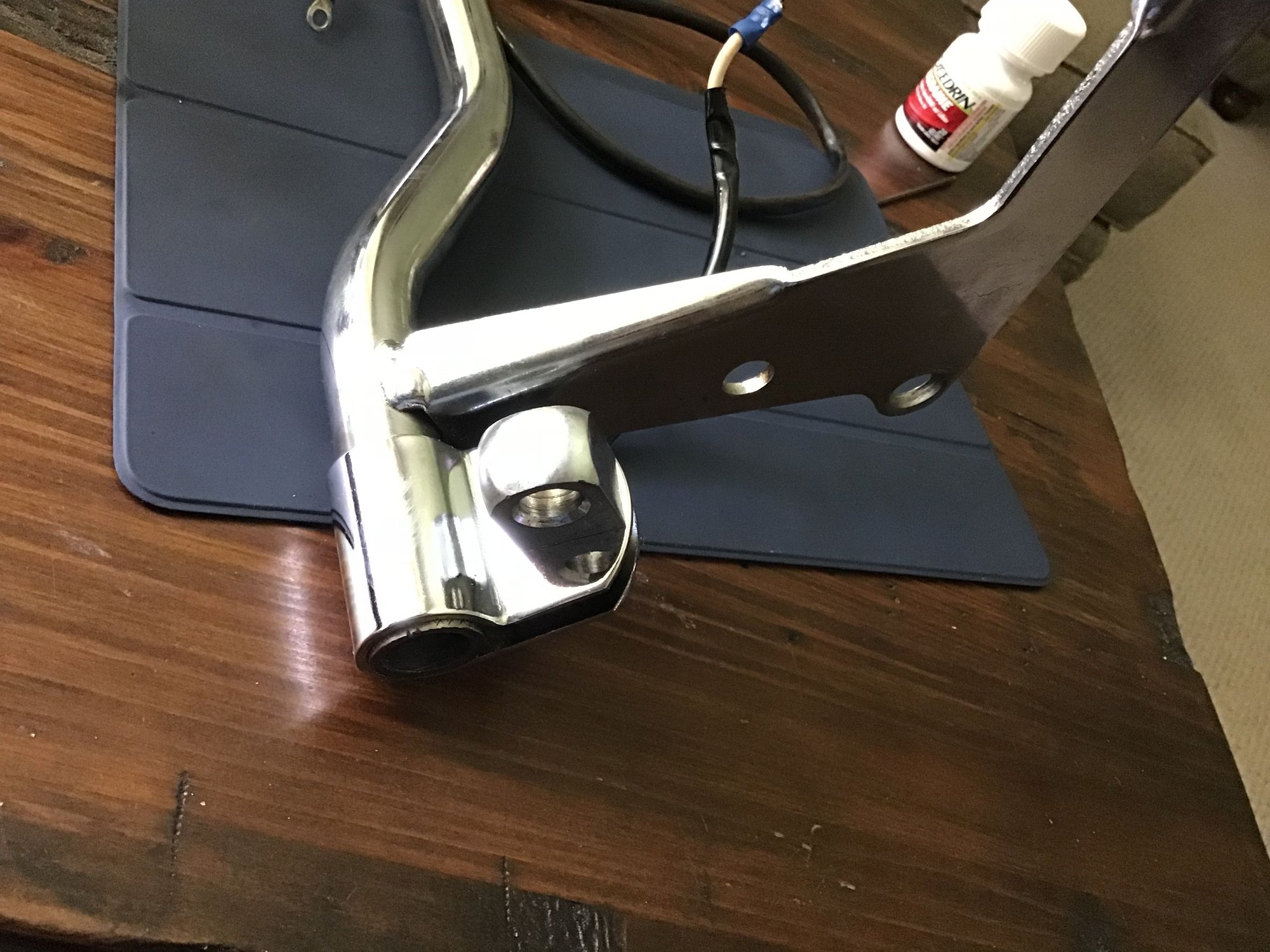

So when done you have an exposed set screw?
Yes.. why I put em n the back side... Not all that obtrusive If ya use short ones...

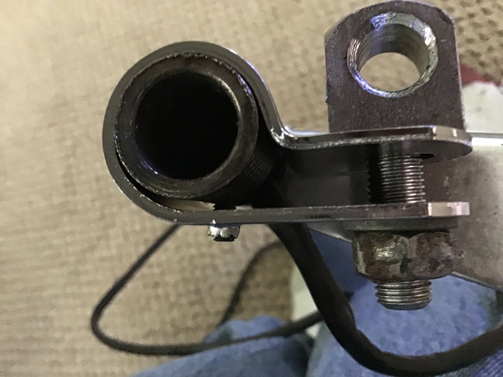

Not on yet as doing neck bearing and rebuild fork tubes.... but you can see i run the allen screws on bottom. When done i leave screw out....put lights on and adjust. Than have one allen that sharp on end...screw it in to make a mark in towel rack. Next i scratch a line under top of bracket.....tig weld a nub.... put it back together with allen bolt lined up with indent in towel rack. Tighten it down till upper flat stays level and hit nub i welded on. So basically i have 2 places it grabes on. I use chrome lock nut if no signal lights like this one will be...

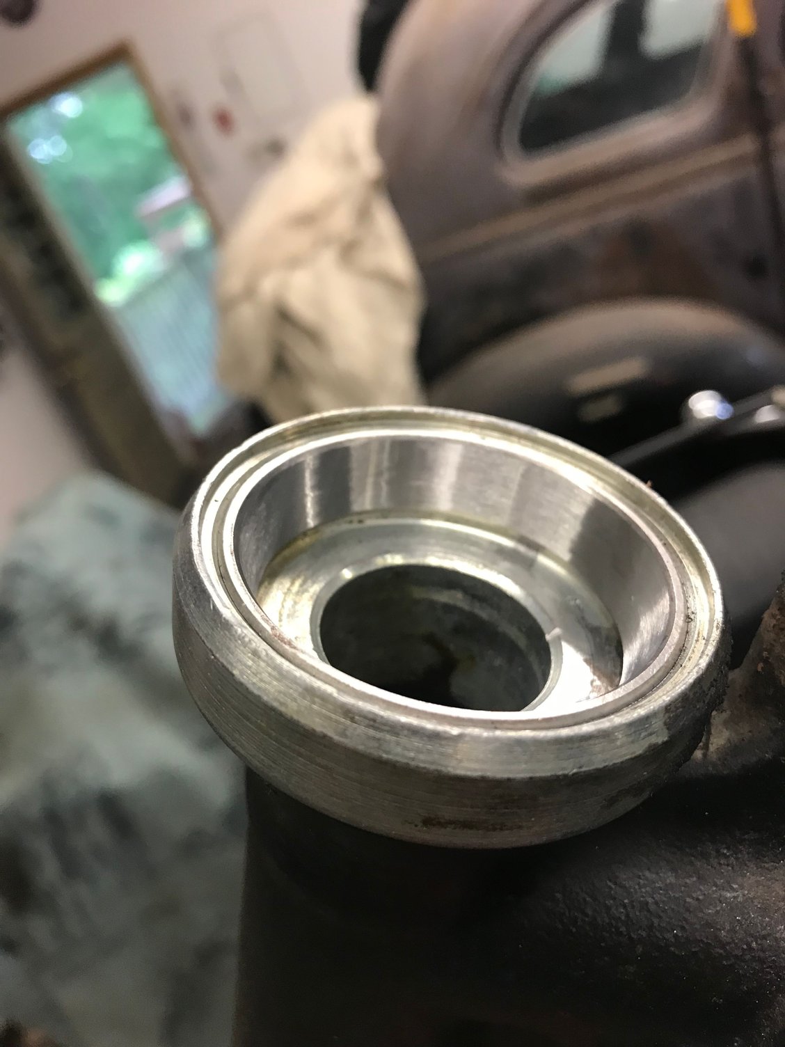

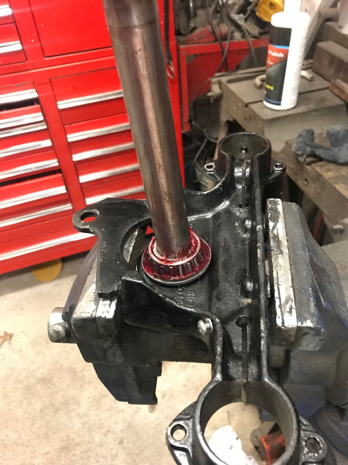

Nice new neck bearings now..( tractor supply)..this ole iron probably will ride better than some of the everyday stuff i work on. You cant believe how many newer bikes that the dealers have just done that the bearings are not only wiped out..,but dry.( than they try to adjust bearings that are junk ) My favorite homemade tool for installing lower stem bearings. I never remove cups from frame unless damage. Freeze bearing races they fall in place 2 taps....... forks tubes and new set of cow bells that started all this lmao..... need to finish up tonight need this lift again in morning. Now what weight oil am i going to use in forks........
