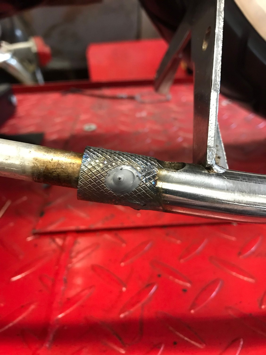

over the years that type of spot and blinker holder design was changed, because you could not stop the assemblies from walking around while riding
I have seen many home ideas and screws is one of them , but some of those the wire ran inside the tube to the center for an exit and the sharp screws made sure it was shorted
the flat tab bracket that holds them in place has a detent for a set screw and that was Harleys idea to keep them from turning - it didn't work well
we have this glue I found that is clear and it hardens only 1/2 way and even applied thin it does the job - holds wires in place under fenders kind of thing and much more
I have in past used the urethane used on new car windshield to work well on clean under fenders for wires. But its black.
can you say what you use John. I keep 15-20 of these new tabs in stock. Mostly just adjust ***** punch thru hole and drill indent into bar. Use longer allen screw...Cut thin brass shim stock for between tab and bar on underside. But those lights are heavy and bounce a lot. Think gluing would be best. As always many ways to skin the........oh crap he is sitting here watching me

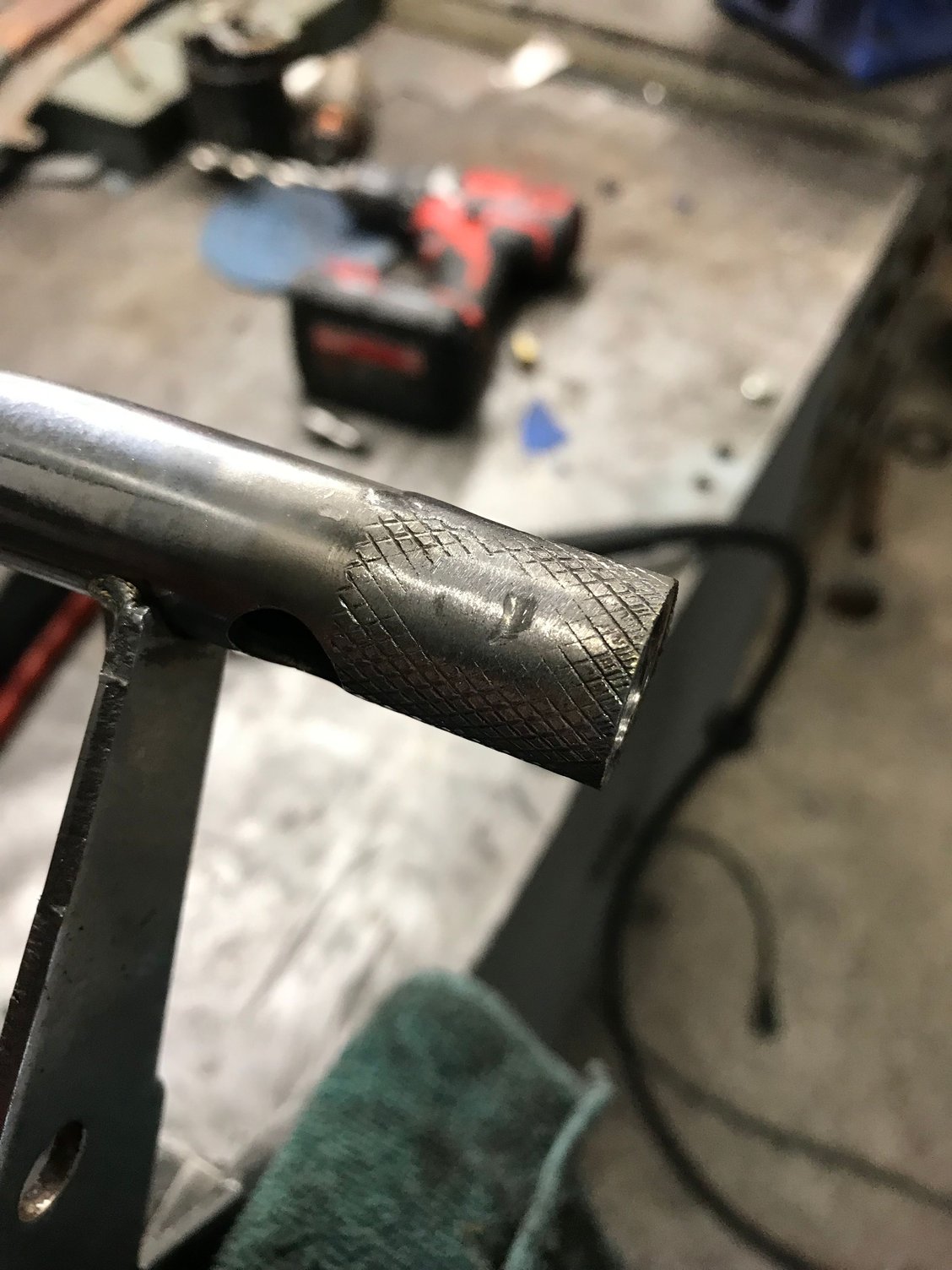

2 things i learned working on guns and motorcycles . Some people should not own dremels or drills....WTF the PO was doing to these passing lamp brackets i have no idea. U think after the first sheet metal screw didnt work he would have firgured another way. Guess i should be glad he didnt have and arc welder ...lmao. Put a collar on for heat sink and tried to save chrome...solid aluimn bar in middle so no sharp welds screwing up holes for wire....run a same size drill through after...good as new. If this crap is boring just tell me to STFU.......i have been helped so much in past...just sharing how i fix stuff i cant buy.
Hey can you post up some pics of before and after on this upgrade? What is holding it in place now? I have the same problem, my left side light bounces all over, and I have 2, not 1 but 2 rivets that appear to be holding it from rotating, only being somewhat effective. Not something I am looking to fix today, but on my list to get straightened out. I had no idea this was a common thing. Thanks.
