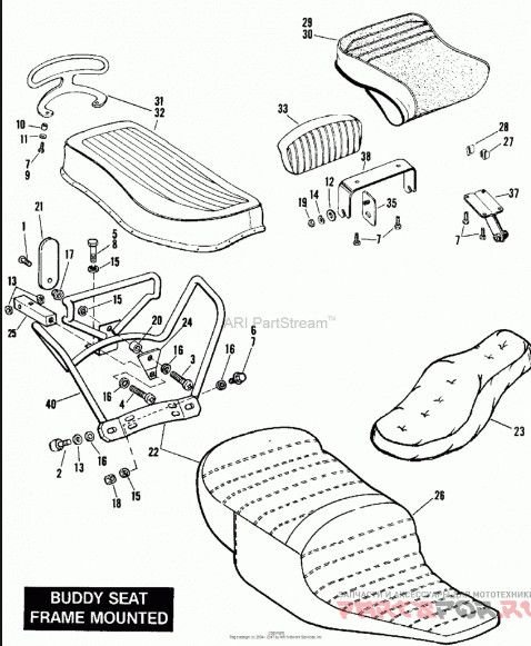

Thanks for the reply. Next question is I have what appears to a "frame mounted buddy seat" see pic below. The research I have done shows the 1979 FLH came with the bear trap setup. I have no idea how the front of this seat mounts. It has two tabs in the front but nothing to attach them to. any ideas?

Number 23 is a Frame mount seat... the other appears to be an FLT seat... also frame mounted..
a bear trap looks like this
The curved part clamps to the Frame crossmember.. the leftmost mount bolts to rear fender, and the clevis looging Part [right top] is attached to the Pogo Stick...
the Fugly Seat bolts to the two flat plates...
BTW I never thought that the Comfort Flex [Beartrap] was ever anymore than an option???
But... IDK Maybe the Frame mount seat was the Option... I didn't care for "Garbage Barges" back then!!!!

When I look at the description # 23 is just a rain cover the actual seat is # 26. That is the current setup that I have, not the bear trap mount that you posted a picture of. This was obviously altered at some point , so I'l l get the rear fender mounted and see what I'm dealing with.

Never seen that seat frame mounted on a 4-speed... but, I ain't seen it all...
this
is a Comfort flex on a 4-speed FL
Do yerself a favor and just go with a Good ole Frame mount seat
either like this
or the SuperGlide style if you dont mount a Rear rack, nor Pizza box...They sit back farther...
