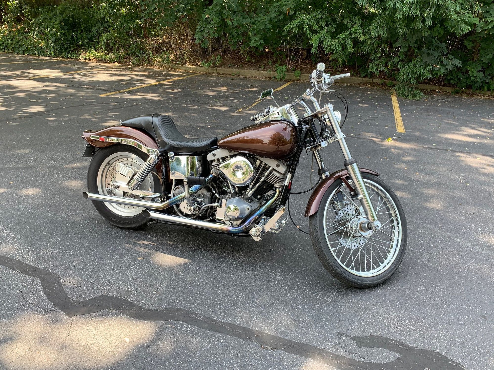

Thanks in advance for the help. Been on the forums for a while (I own a 2009 Dyna Low Rider) but this is my first post in the Shovelhead section. So I have my cousins 1971 Super Glide (at least that's what he says it is), I'm just learning on these engines so bear with me. The bike has been sitting in his body shop for 5 years and hadn't run in all that time. So I took it to get it running for him. Drained the gas, cleaned it up a bit, new battery, changed the oil and rebuilt the S&S E carb. It started right up and ran fine except after shutting it off it would pour gas out the overflow unless I shut the gas valve off but it would start right up if hot. Ok, no big deal, bad float/needle not seating, so I changed the float. Again, when cold, starts right up, rides no issues but now if I turn it off, it's hard to turn over and won't start until it cools down for just a few minutes. I'm guessing with the fact that the only thing that's different is the float that it's somehow related but I don't see why or how. It doesn't seem that the float is adjustable or how that would effect hot starts.
Any help would be appreciated.
Thanks, Steve

If that is a '71 or '72 FX it sure has underwent some extensive surgery!!!!
