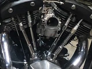

Ok I am at work so I can’t get any pictures outside of a zoomed in version of my “daily progress” photo. I have taken one everyday since I started.
I will get more in the morning.
Old Sep 15, 2020 | 10:37 PM
TwiZted Biker's Avatar
TwiZted Biker
Joined: Mar 2009
Posts: 66,110
Likes: 51,394
From: Niles Canyon Ca.
Well from what I see those are oring tubes at the tops, if you trying to use cork with them no wonder they won't fit.

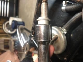

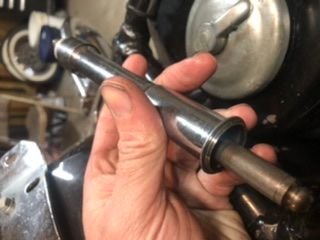

Old Sep 27, 2020 | 07:13 PM
SAVAGE_SHOVEL's Avatar
SAVAGE_SHOVEL
Joined: Apr 2020
Posts: 125
Likes: 10
From: Connecticut
I went with O-ring bottom, cork on the top that’s what was on there. Not that it’s right but it didn’t leak and is not leaking. Life has been trying to give it to me ever since that weekend so I apologize for not continuing with this but here is what we are working with for components. What “should” it be.
thanks guys.
Old Sep 27, 2020 | 07:29 PM
johnjzjz's Avatar
johnjzjz
Posts: 12,878
Likes: 5,449
From: la la land jerzey
they changed the lifter blocks as well when the went to o rings BTW
Old Sep 27, 2020 | 08:48 PM
TwiZted Biker
Joined: Mar 2009
Posts: 66,110
Likes: 51,394
thanks guys.
O-rings top & bottom.
And those push rods are junk, those cheap solids kits were a pain in the *** as they are noisy, hard on the lifters & blocks because of the angle they run at and tend to rub the inside of the push rod tubes.
