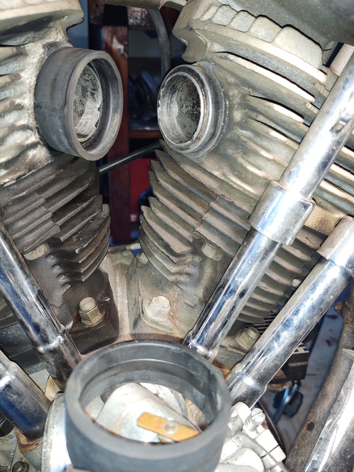

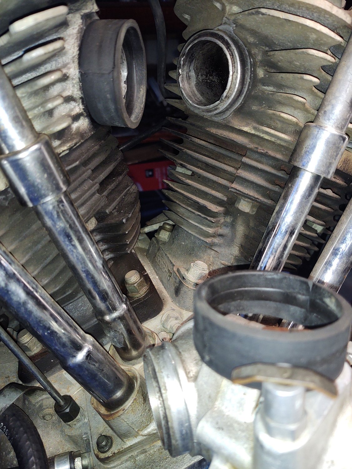

Here is the intake Racepress. You were right, those rubber boots just fell off when I removed the clamps. They are either not the right ones or they are shot and need to be replaced. I probably had air leaks at that point. Thanks for that advice. I will look into getting the proper rubber bands.

Hopefully your Manifold is the Mirror Image of the heads... all ya need is O-Rings and put 'er back together
The right way,,
BTW people Cringe, but, I been taking a wrap of black electrical tape around the assembly over the oring...then clamp, gotta open the clamp all the way, without Kinking it... But, I have yet to have a problem with this method...and the Correct clamps, which you have.. But, Only been doing it that way since the Mid to late '70's..

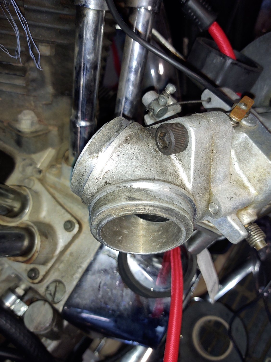

Here is the manifold and carb support.
Checking all the dash lights and they all have power but I'm gonna need some bulbs, I think I have one that works. Put the nacelle back together, that feels good.
So I need O rings, not rubber bands?

Yes you need o-rings, and My S&S "B" always seemed to work better with a Phenolic Block between Carb and Manifold, No Biggie tho... lots are just fine like yours is..
That Carb Support is probably Sufficient... even tho a "B" hangs out a long ways..and may benefit from 2
Hopefully the O-ring between Carb and Manifold is Good... But, You will soon see as I have a Terrible time Putting a Manifold on with the Carb on the Manifold.. the Holes in the Manifold are Ready Made for Bungee hooks and the Bungee around yer Stick on the Backside [left side]

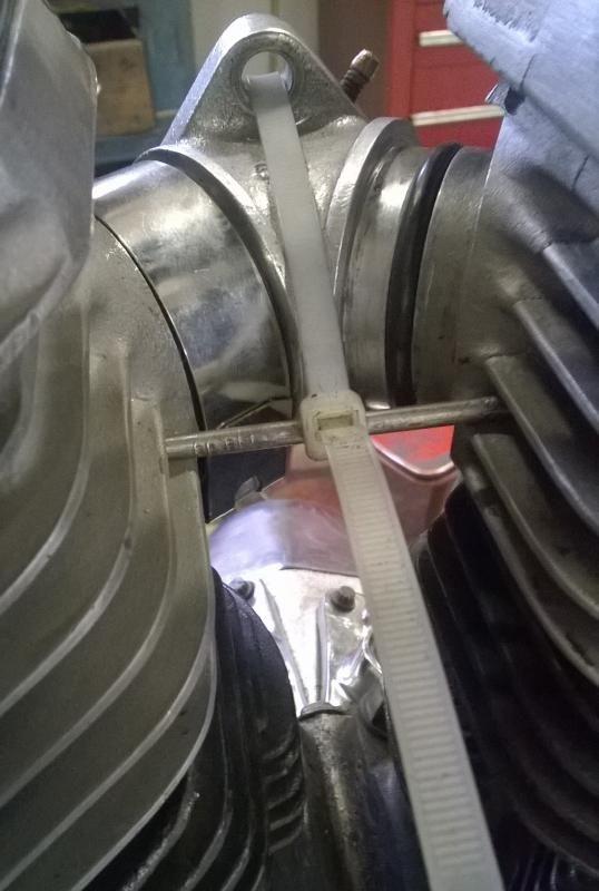

A cut nail and a zip tie can work for the third hand.
Third Hand

I Like it OK... But a Bungee and a stick on the off side is Simple for me!! I need lots of room to install the open Clamp!!
