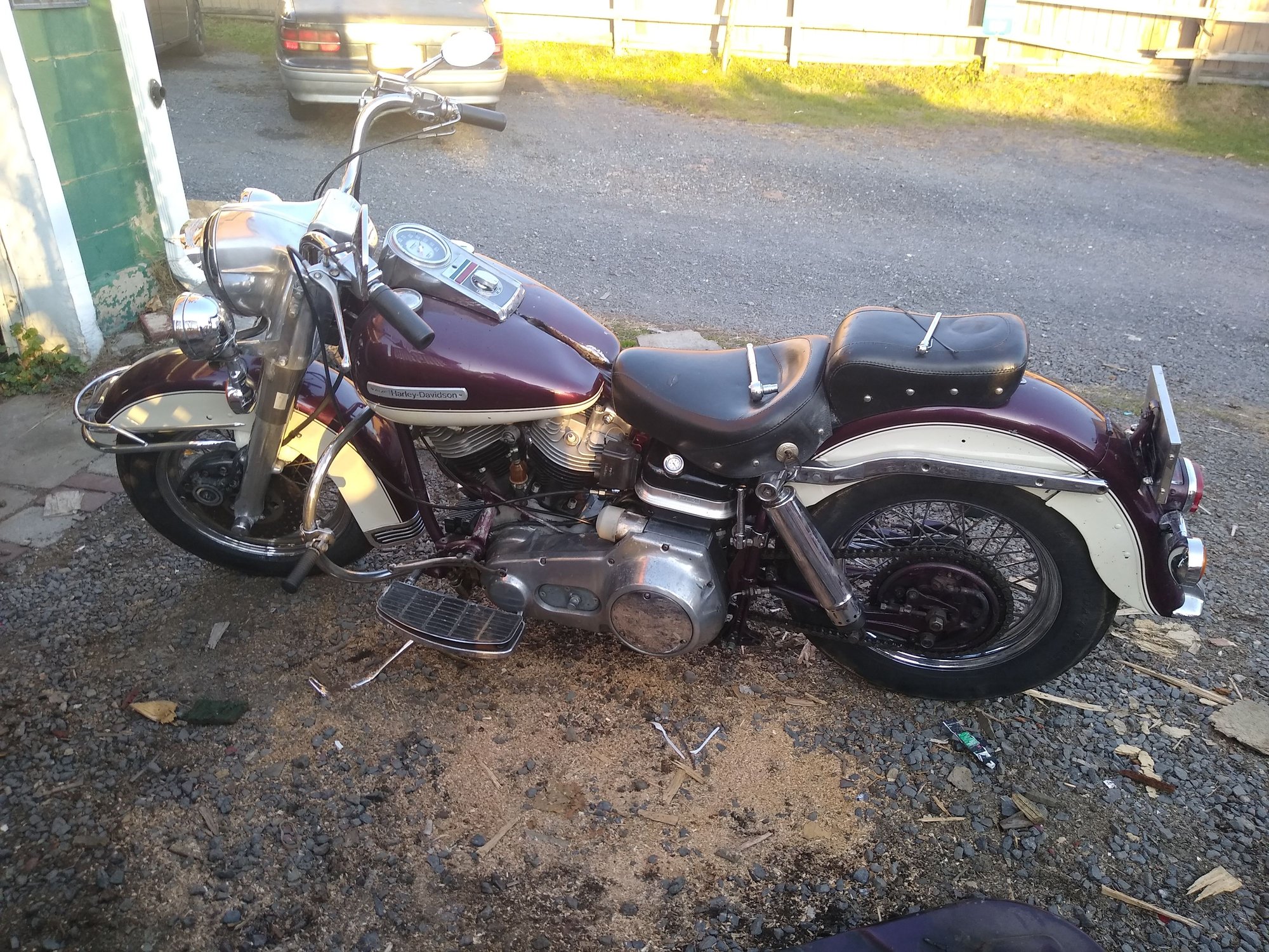

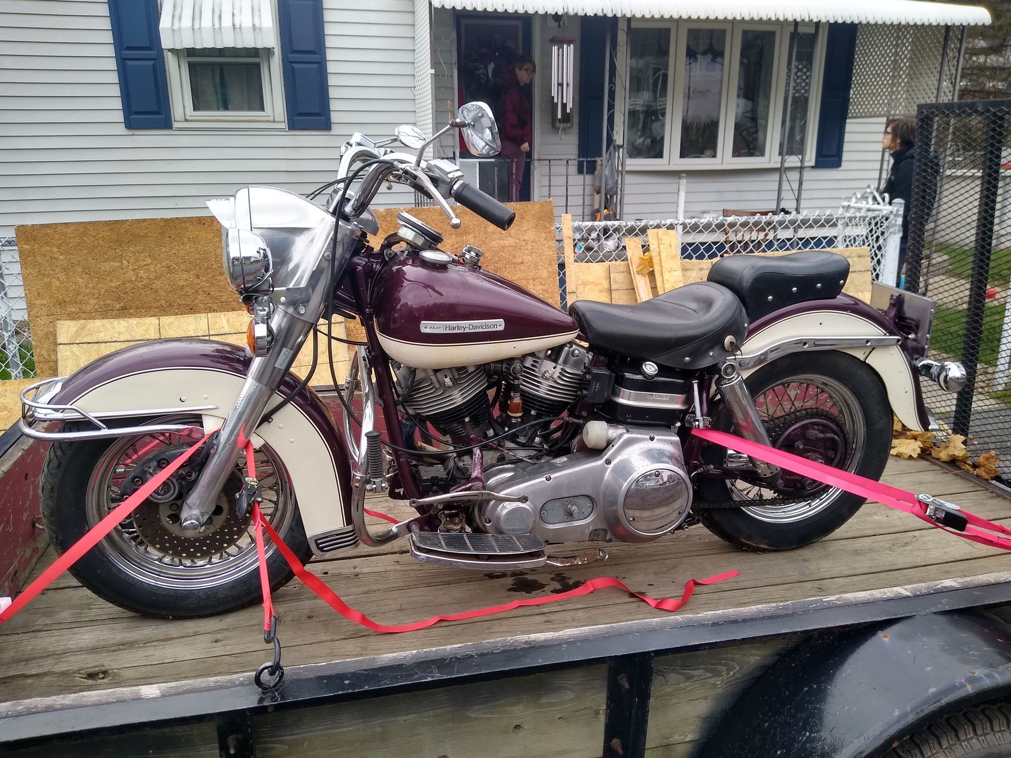

Hi guys, need some advice/opinions here. My uncle has just moved in with my mom and he's going blind. He has this 1972 FLH shovelhead and my mom may want to buy it with the idea that I'd restore it and eventually give it to my son.
It's a bit rough and I'm wondering if it's worth the time. I don't currently know if it runs, but bought a battery and spark plugs to see. He's telling me it ran four months ago... But I got my doubts.
So far I can tell it needs/needed the following:
Battery
Fuel hose
Brakes bled
Lights & turn signal bulbs (or more)
Plug wires
Miscellaneous nuts and bolts
Shifter pegs
Throttle/return cable
Clutch cable or lube.
Kickstand assembly
Throttle housing
Mirrors
Rubber trim for speedo housing
Paint job
Battery cover

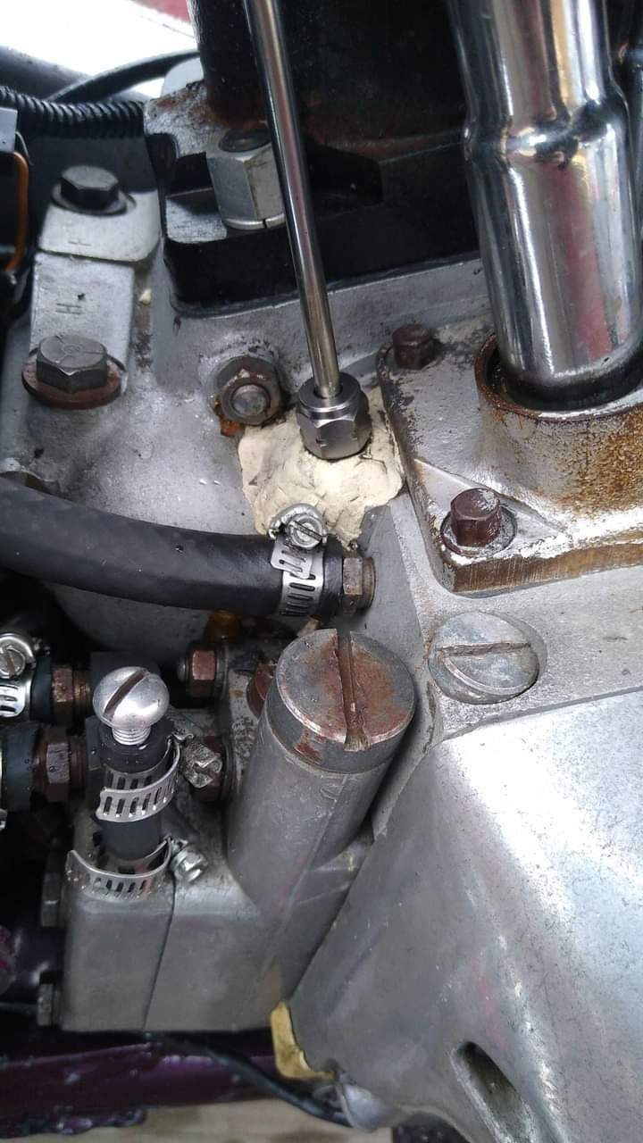

I'm also concerned about the jb weld on the motor
It includes a windshield and fairing and a chain guard not pictured.
If you were going to offer what would it be, or should we run?

If you don't want it send it to me cause I like it. Aren't we all a bit rough after 48 years. The JB weld on the oil line is from someone over-tightening the fitting cracking the case, may be fixable and it is the side with numbers. The nose cone cover is no big deal as they are pretty easy to replace. The rest of the list i just normal stuff for an older bike.

Overalll the bike doesn't look too bad.
California prices would be around $3500 in running condition.

What Panz said, $3500 - $4000 if I could hear it run.
Then expect to put another $5000 - $7000 into her to make her a reliable fun machine.
But as a father son project, you could start with worse. And family lineage for a machine is priceless.

so it needs a new engine case. correct ?
