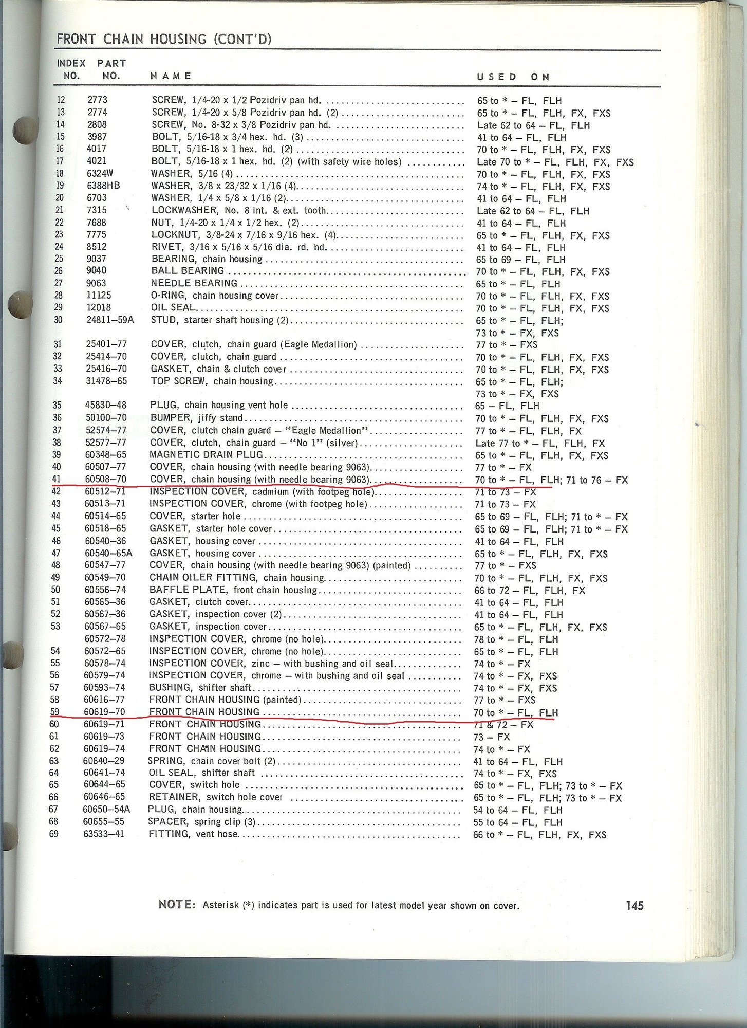

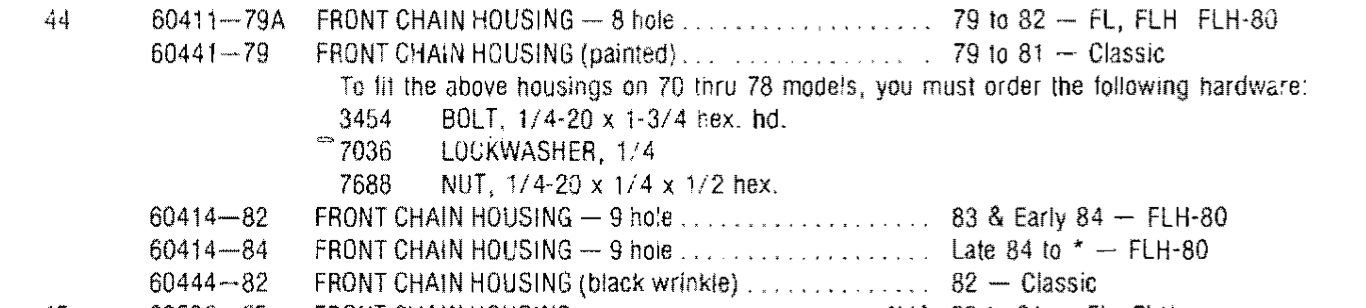

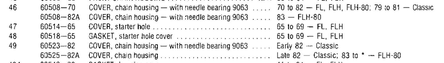

I am looking for a part # check for the inner and outer primary for my 1970 FLH. Per my book:
Outer primary 60508-70
Inner primary 60619-70
There is an outer on the Bay right now showing a casting # of 60510-70 and looks like it would be correct for 1970 FLH. This has me questioning my part #'s. But perhaps the casting # does not match the part #?????

There may be exceptions, but in my experience Harley casting or stamped numbers never match the actual part number. In fact, that applies to just about every automotive part I've ever handled...

Odd, my parts book doesn't list an inner for a 70', outter shows as a 60508-70.

That outer primary cover will work for your 70 and will clean up nicely. Price is definitely fair.
Nice to see almost zero road rash on the outside bottom. Goober on the inside looks like the compensating sprocket nut backed off and beat against the inside a bit.
