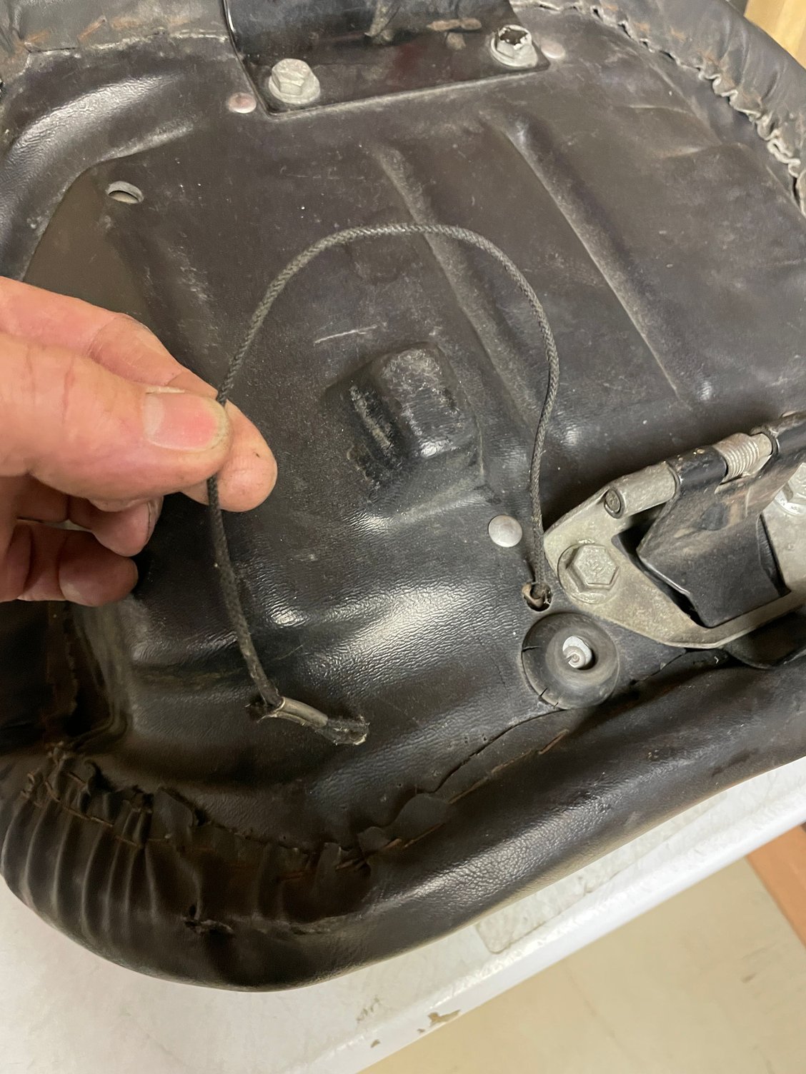

Dont forget the lanyard thats supposed to go through the hole in the plastic seat base. Not sure how you'll attach it with the seat upholstery on.

It is just a Flat piece with hole in middle..Stuff it in and ...Done
You can even kind of make it out in the Parts Drawing!!!
My Question???? Where to get the battery hold down that attaches other end?? H-D Part 66183-82

Yes, I have that somewhere. The seat end is attached by a metal bar with a hole in the middle that slips in and then slides across the hole in the seat. Hard to explain w/o pictures, but when I find it I'll post.
I can picture it, that makes sense, easier to install.

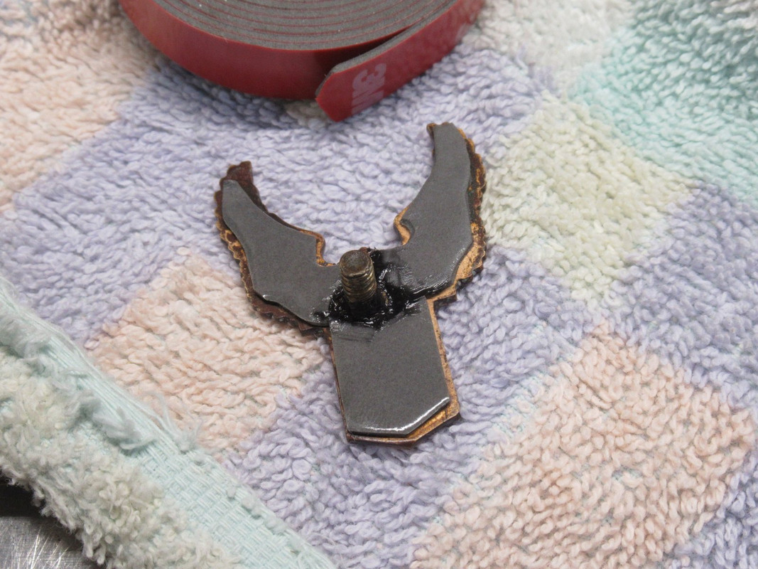

With a couple coats of wax, I was finally able to install the original commemorative emblem on the front fender. First trace and cut out some 3M foam tape, and seal the middle with rtv just so water can't collect.
Then pop it on and secure with the nut. I was surprised it didn't follow the contours better, the tops of the wings don't touch the fender. Did I do something wrong?

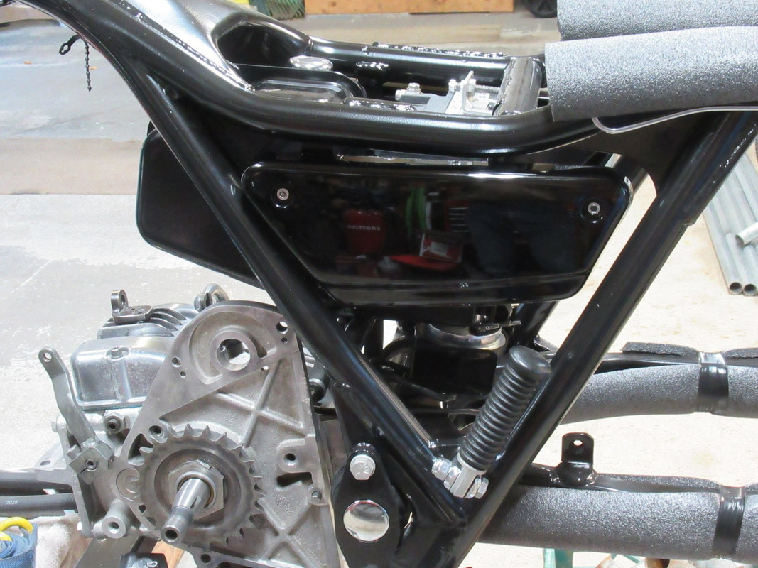

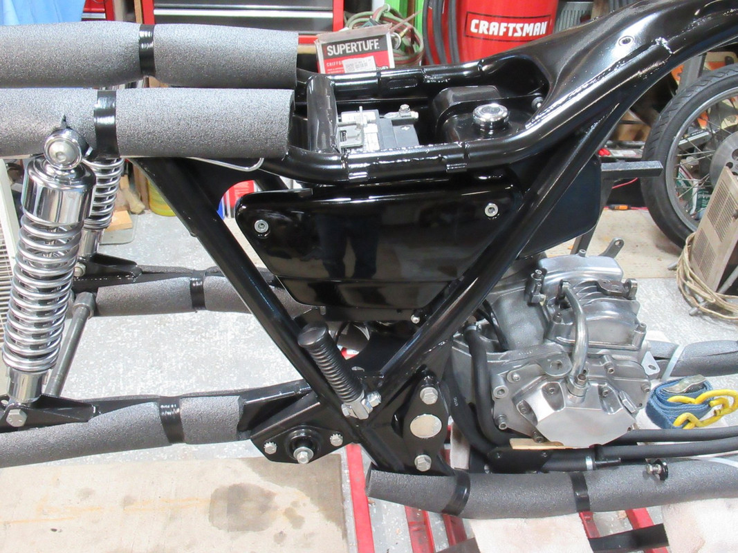

One of my parts books said both side panels are secured by quarter-turn pins, so I bought a set of pins and clips, even though the bike came to me with allen screws on the left side. One of the pins turned out to be too short to reach the clip on the left side so it seems the screws are correct. The later parts book does say to use screws on late 82 bikes on the left side.
