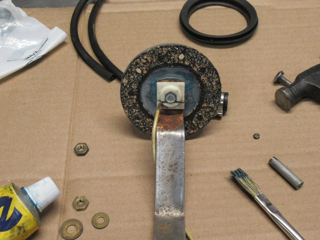

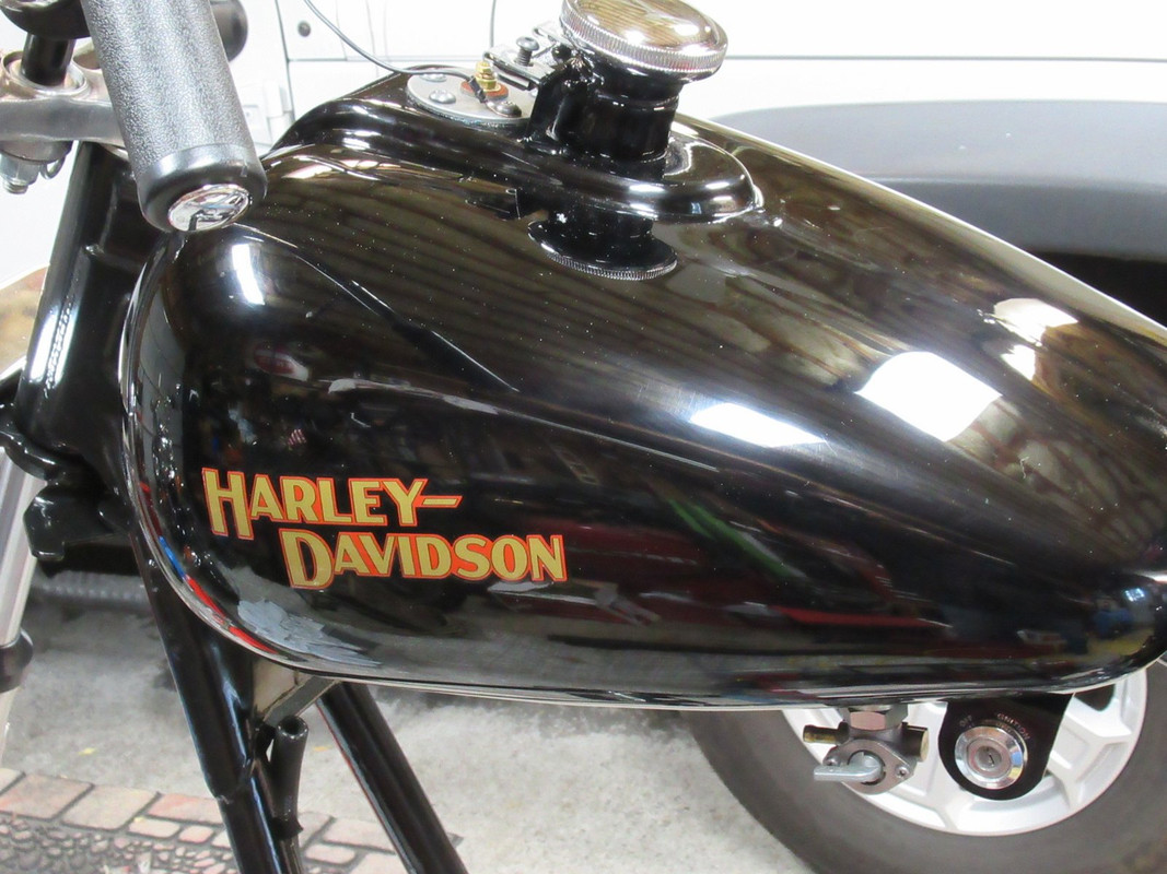

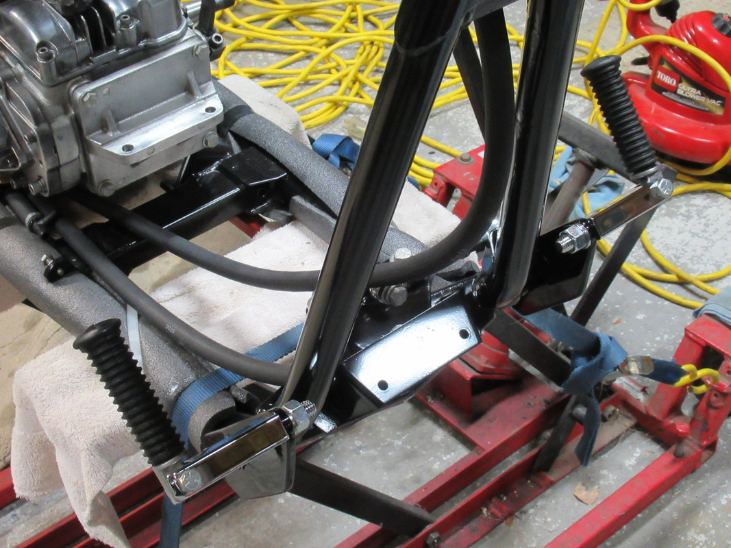

Just a little work this week. Waxed the tank, and installed the gauge sender and petcock. Had to make a new gasket, nobody sells them. Interestingly the dimensions are metric, 70mm OD and 40mm ID.
Got the highway peg brackets back from powder coat and installed with new chrome supports. Chrome was not good, and I thought black wouldn't stand out as much, since they are just options on the base FXR.

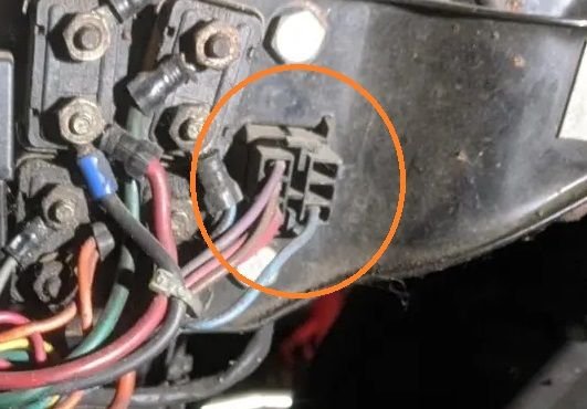

One more little detail that I am struggling with. The previous owner of my bike did away with the plug and socket for the rear fender wiring and I'm trying to replace them. The FLT tail light I bought came with a socket but it doesn't fit in the hole, the index tab is different. Has anyone got a lead on OEM replacement components? The aftermarket only supplies white ones that are smaller and don't lock into the hole. Here's what I need, plus the mating part.

Hi Joe ,Troy hier,
do you have the H-D Part#'s for this plug , i could check with J.W. Boon . . . only thing is their on vacation till Jan 4 2022, but i could still check for you . . .

Part #, search on the Bay. You may get lucky with the part #.

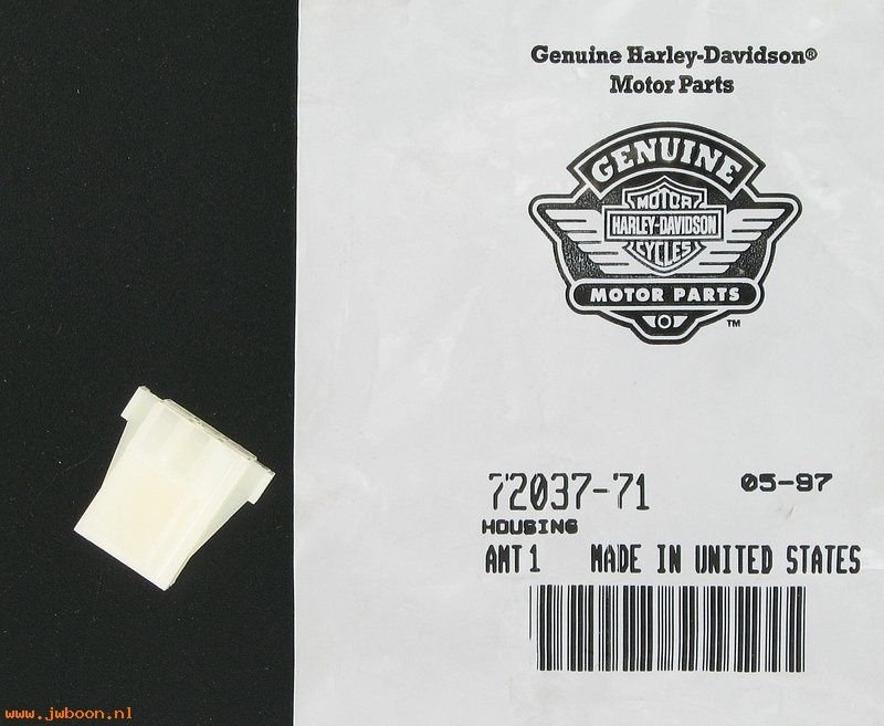

Thanks guys, part numbers are 72037-71 and 72041-71. There are a bunch on eBay, and maybe even the dealer can get them.

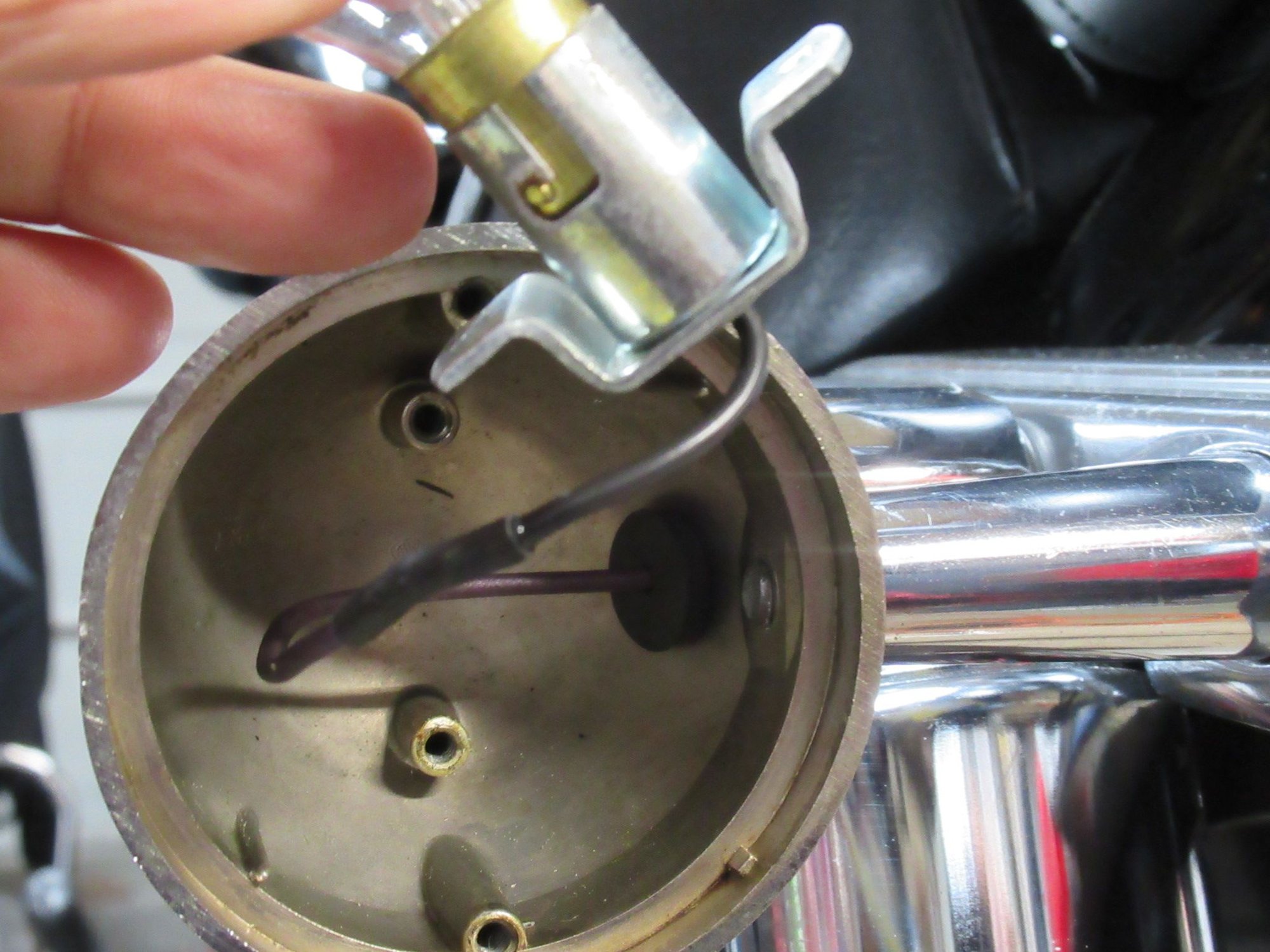

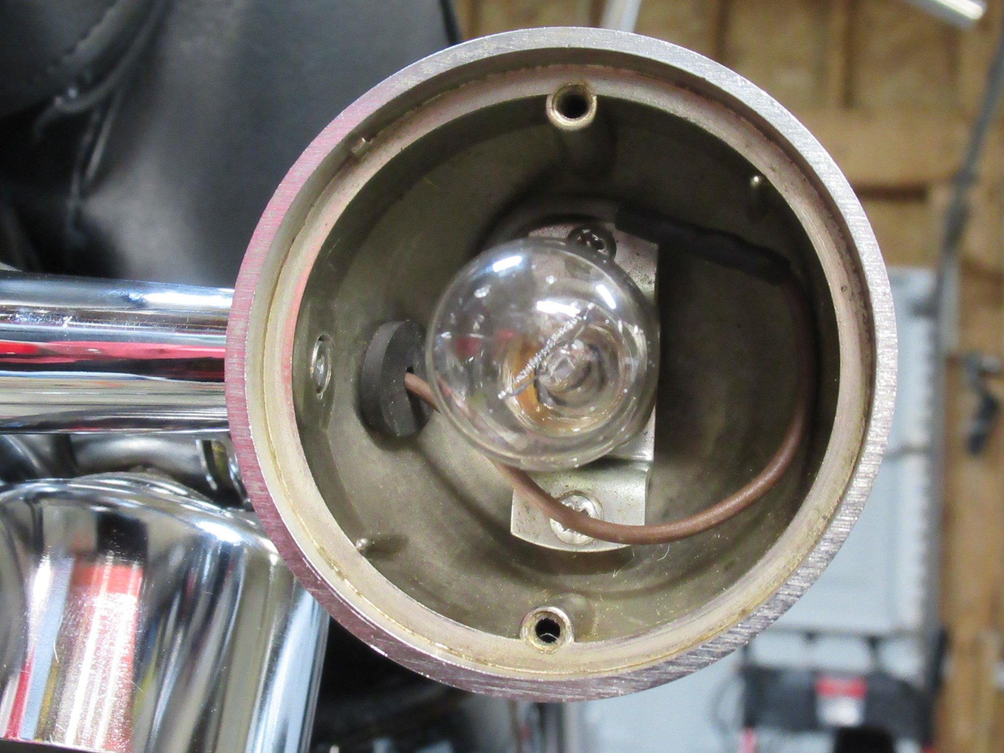

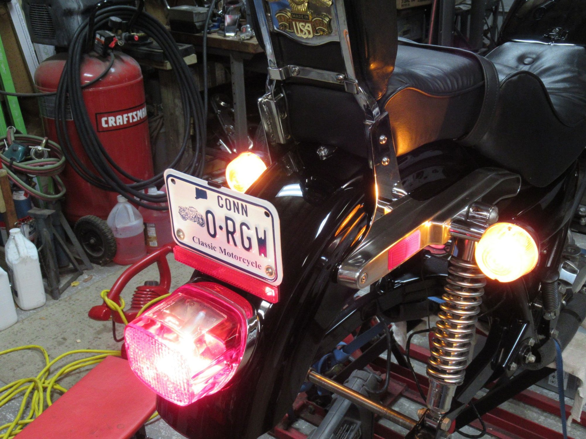

Meanwhile, I completed the turn signal wiring, splicing inside the housings:
Success!

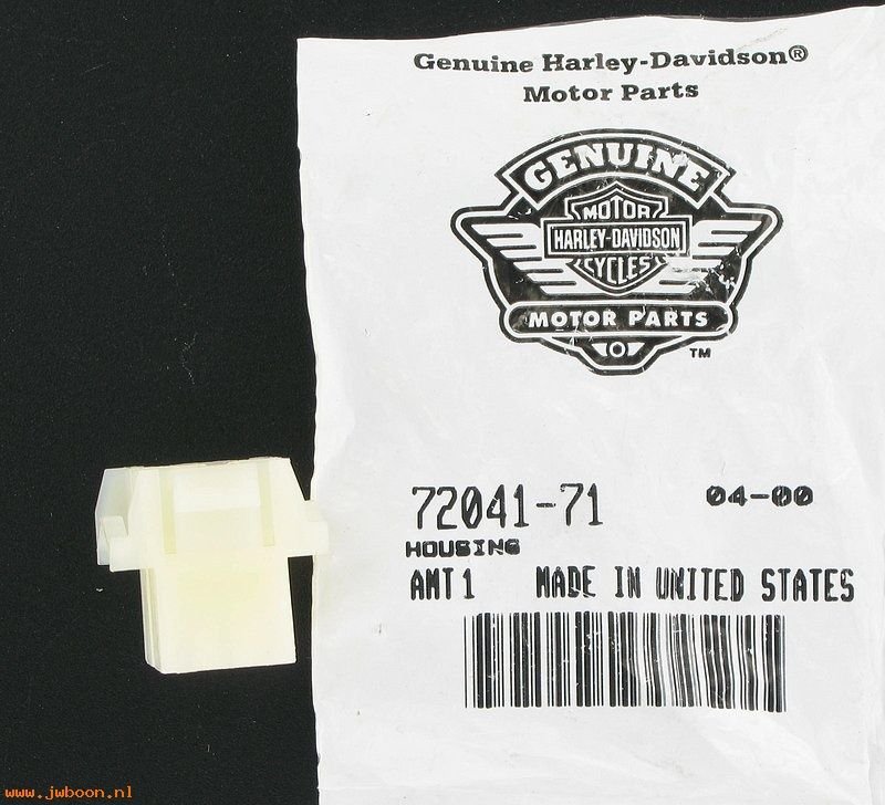

are these the part #'s for your 6 pin connector ? socket 6 pin : 72073-71 & connector 6 pin : 72041-71 ? if these are what you are looking for J.W. Boon has them for a total of 20.00 Euros for both of them . . . .
sorry these are not a better view . . .
. . . . but these look like what you need . . . let me know if you want these ,i can order them in Jan. when they re-open . . . .
