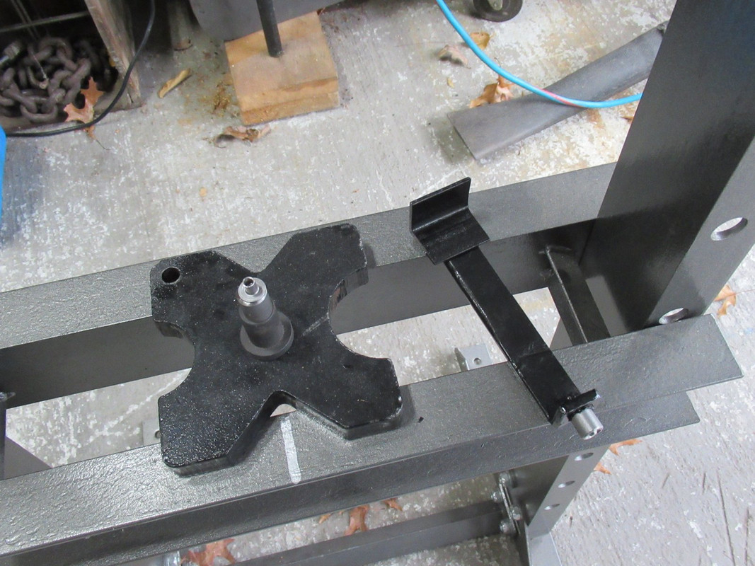

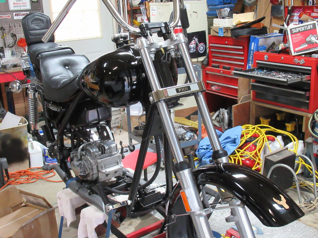

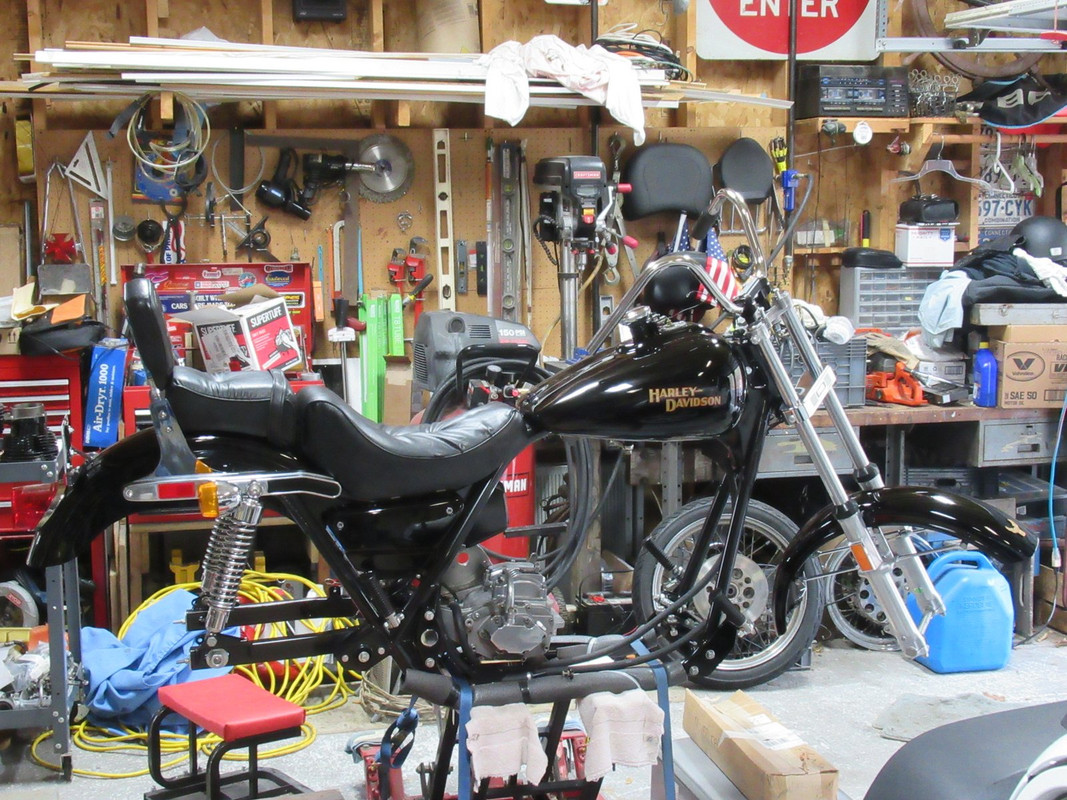

While waiting on that and other parts, I got my helper over and we finished the front fender. I was very lucky that a local dealer had the last package of ten fender rivets in the country (well maybe not, but they are impossible to find). I ordered pressing dies from Hanson Rivets and built a tool to work with my press. It has to go around the tab on the opposite side, but still press straight on the die.
The rivets are stronger than I thought and bent the tool, so I made another that worked great:
Now all the sheet metal is done!
I found an original aluminum dash in decent shape, so I'll polish and paint that next.

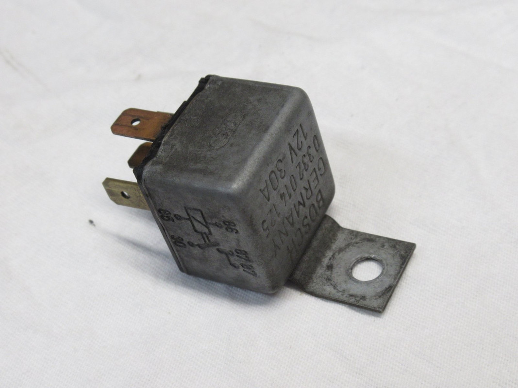

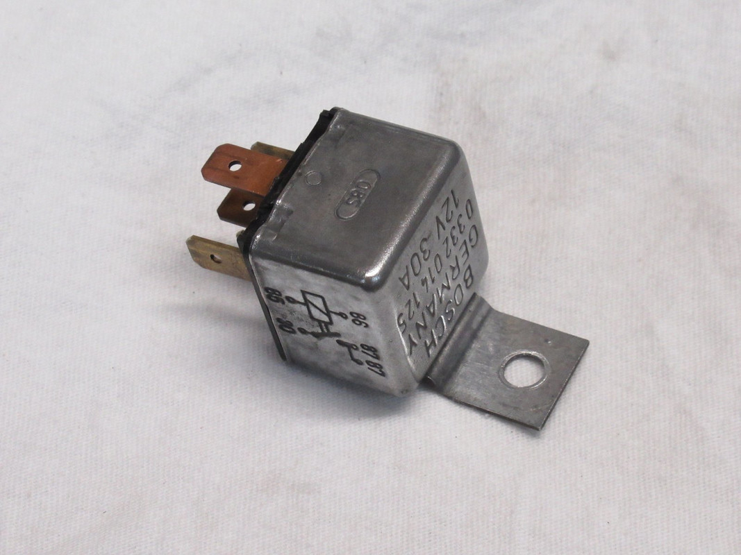

It was over 60 degrees today, had to go for a ride. When I came back I had only a couple hours so I did a few little things. I got an original starter relay from someone on another forum.
Took it apart and cleaned the contacts with some magic juice:
Polished up the case, looks like new

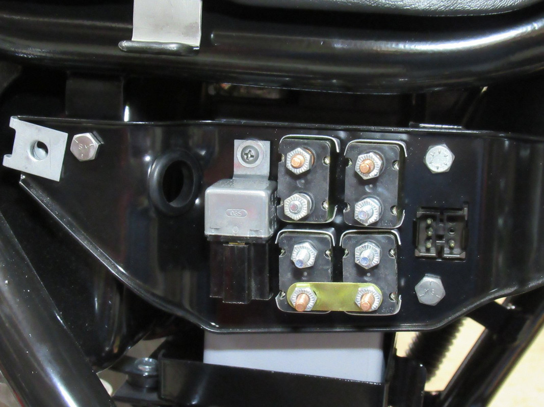

Installed the relay and the tail light / turn signal connector.
