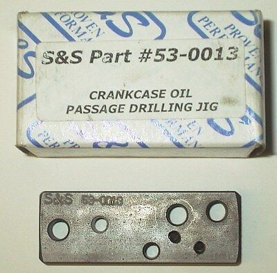

Hi Joe,
gotta question for you, concerning the S&S oil pump, did the previous owner drill the cases with a S&S oil pump jig to fit the shovel engine ? i mean if they did would a stock oil pump still work ? ahhh wait a minute . . . these pix answer my own question . . . carry on !!
just wanted to make sure your OEM pump would still work, no worries the S&S would have worked without modifications to your 82 cases . . . but wait your oem oil pump is 1980 . . . will it work with an 81 to 99 oil pump system ?!?! . . .

Ahhh so many questions! So few answers! I'm sure someone smarter will be here soon.

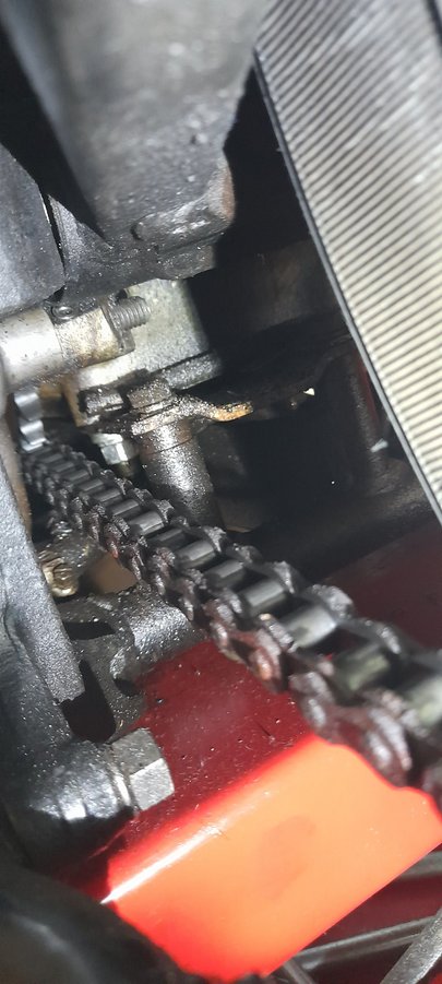

So that brings up the question, where does the hose go after the oil pump? Can you post or send me a picture? Thanks

old mago's Avatar
old mago
Joined: Mar 2017
Posts: 2,597
Likes: 2,172
From: australia
the line runs at the back of the transmission plate
Good shot, that's how my 79 FLH was run. Gone now!
