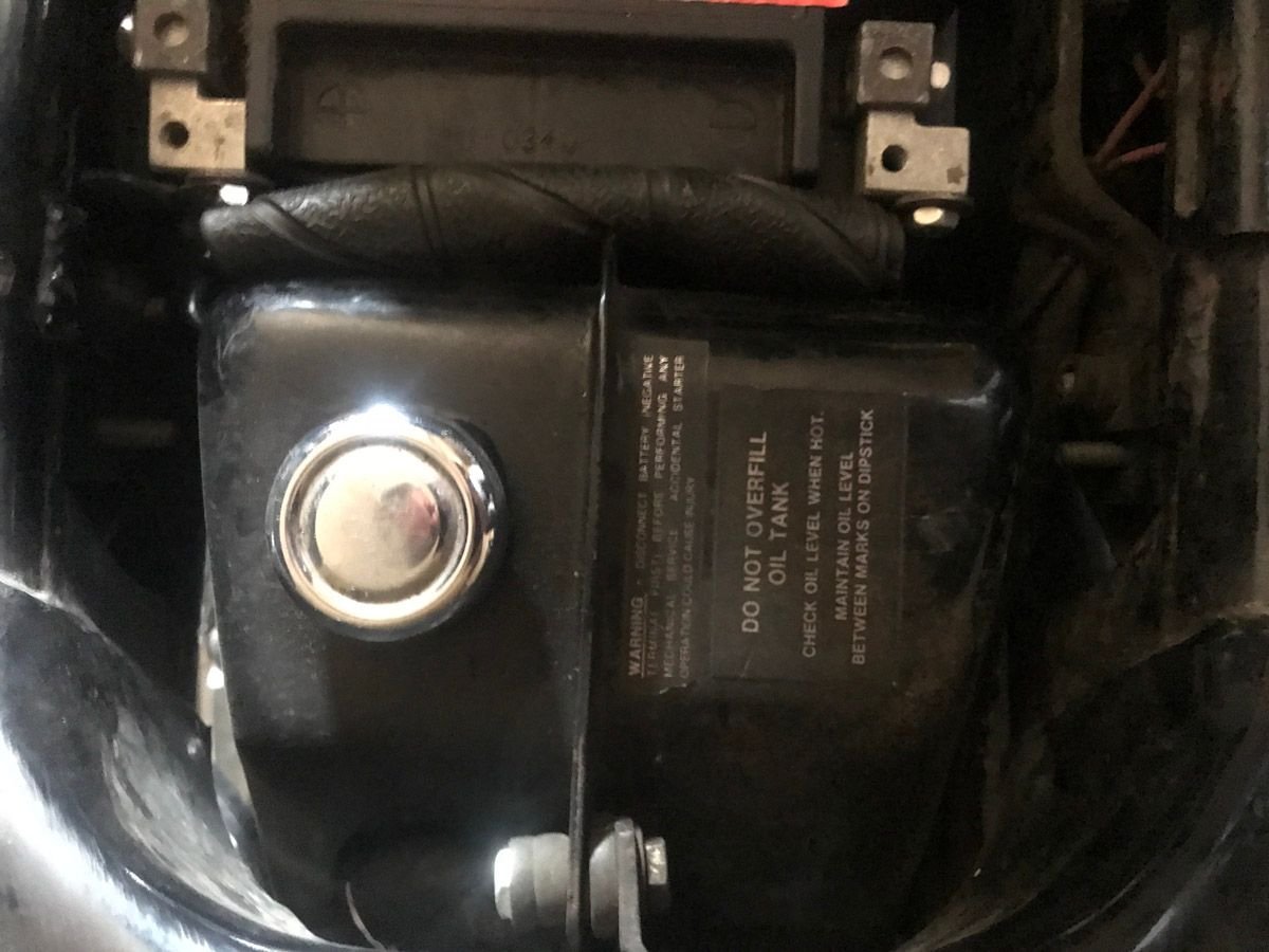

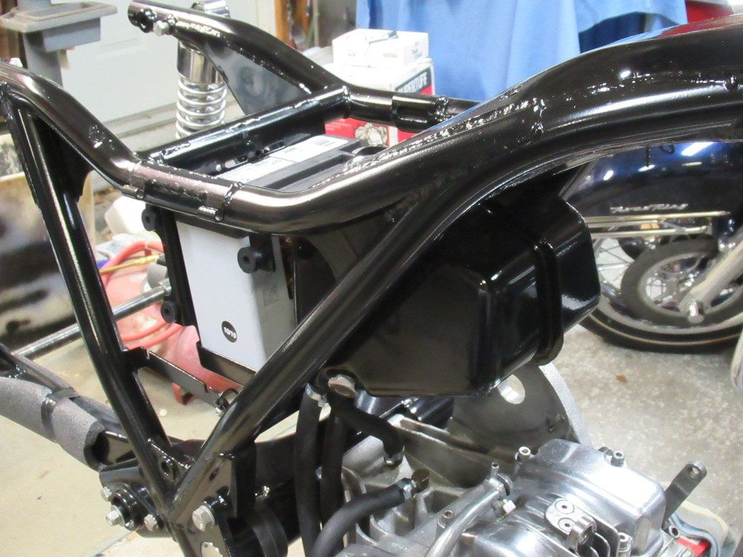

After letting the paint cure for a very long time, I installed the oil tank with its warning label and a coat of wax to protect the finish. Also installed the hoses to the tank with OEM style clamps. I left the other ends long and will trim to fit when the time comes.

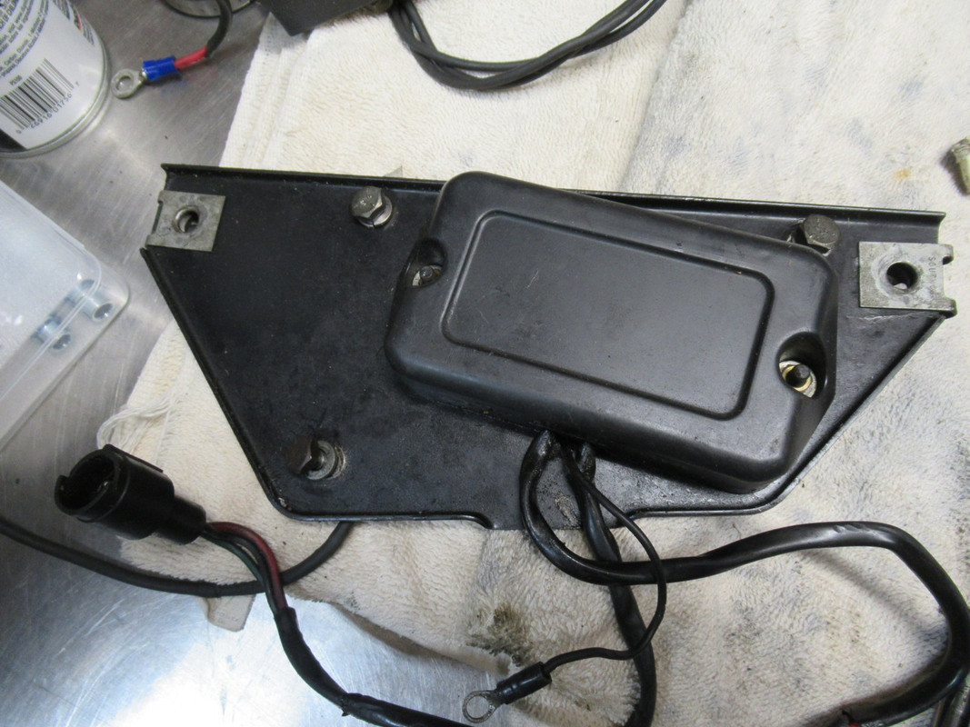

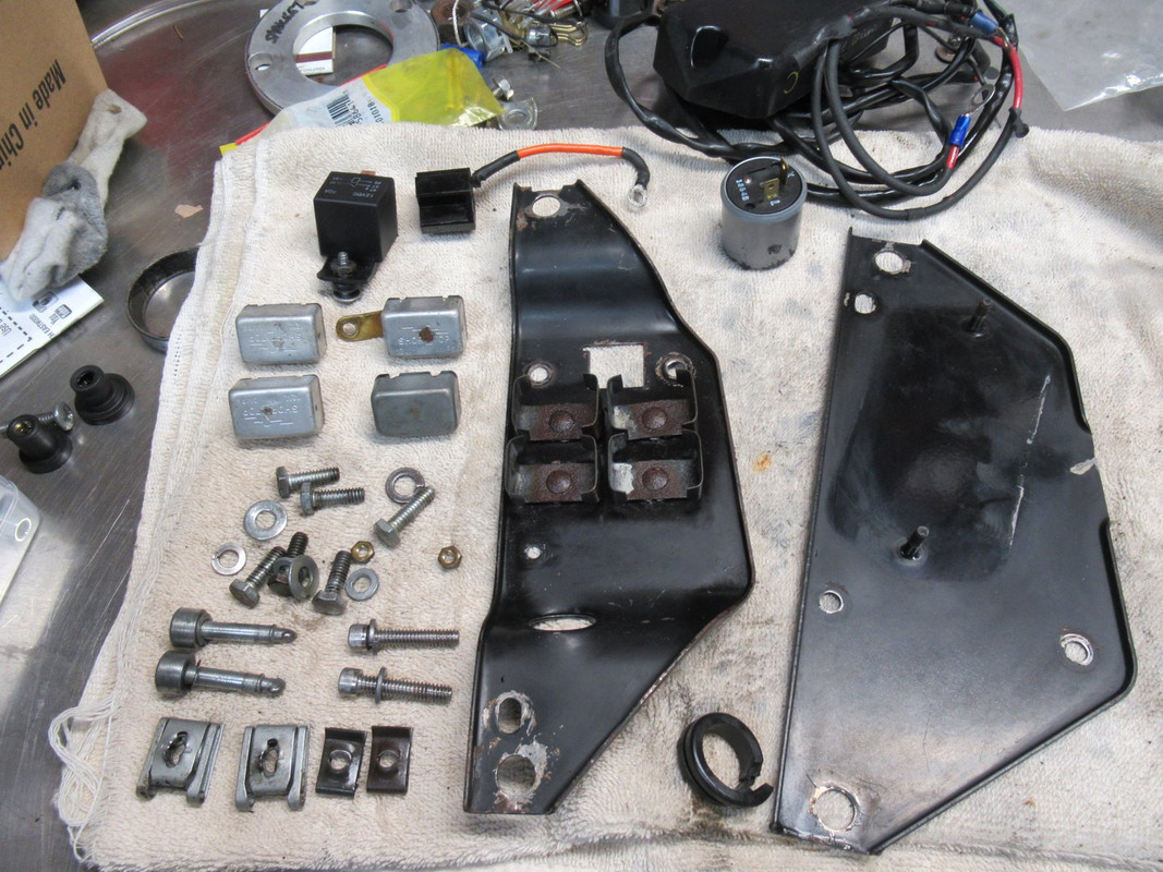

While waiting for time to use my friend's blast cabinet on the tins, I disassembled and cleaned the two electrical side panels. I'll give them a coat of paint set them aside until I get the wiring harness sorted. I haven't looked at it too carefully yet, but there are a few little issues that need fixing. If it is too bad I'll just buy a new American-made one.

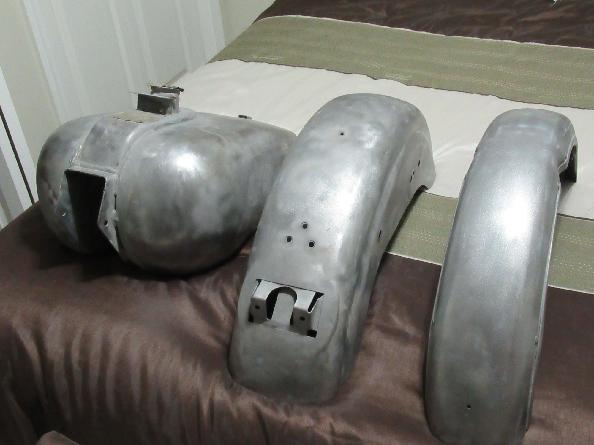

This summer humidity is killing me - tins have been blasted and waiting for coat of epoxy sealer before process of filler, sandable primer, more sealer, then paint.
Meanwhile, I blasted and painted the ignition and electrical panels. I used VHT black epoxy spray can to give a different finish than the frame etc., and brush-on silver rustoleum. I also ordered new circuit breakers.

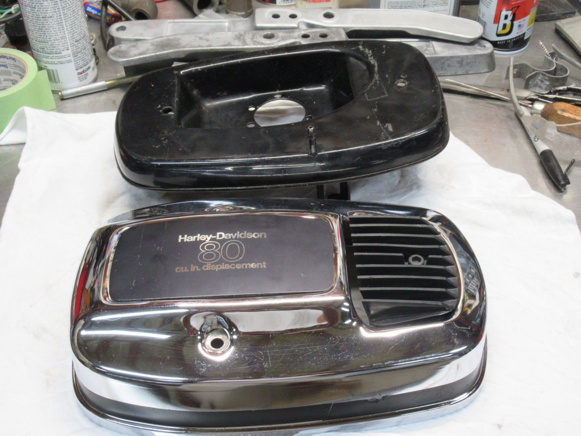

I also picked up this complete ham can filter at the Terryville AMCA meet a couple weeks ago. The fender struts have been soda blasted too.

That air cleaner is in great shape. The piece that attches to the out side cover is not beat to heck either. Definite plus.
But... I seem to recall another Plate goes in there from the Factory... tho no one will know when assembled...
heres whats missing . . .
this plate holds the filter element in place & probably directs the air flow in side the air cleaner

I have all that - just didn't photograph it. This one even came with the screen for the filter. But no filter.

Hi Joe,
do you have the 2 "L" brackets with clip nuts that attach the Air Cleaner backing plate to the Rocker Boxes ? if not i could help you source some NOS ones from J.W.Boon ,if you like . . .

ok just checked J.W.boon's site , part#'s : 29113-79a, 29114-79a braces & clip nuts are all available for around 45$ + shipping . . .
