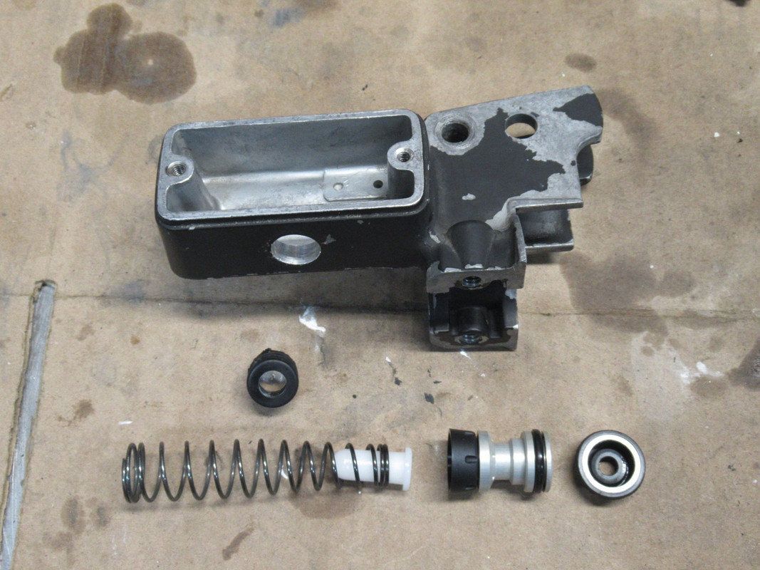

I bought a Harbor Freight powder coating kit but they didn't have semi-gloss powder, so I'm on the hunt. I will soda blast everything and give them a good heating in the oven to drive out any oil or brake fluid the parts washer didn't remove. I saw that done on one of the shows on Motor Trend TV.
Disassembly of the master cylinder was straight forward, including removing the sight glass:
The piston and seals looked like new because the previous owner had it rebuilt just before he sold it to me.

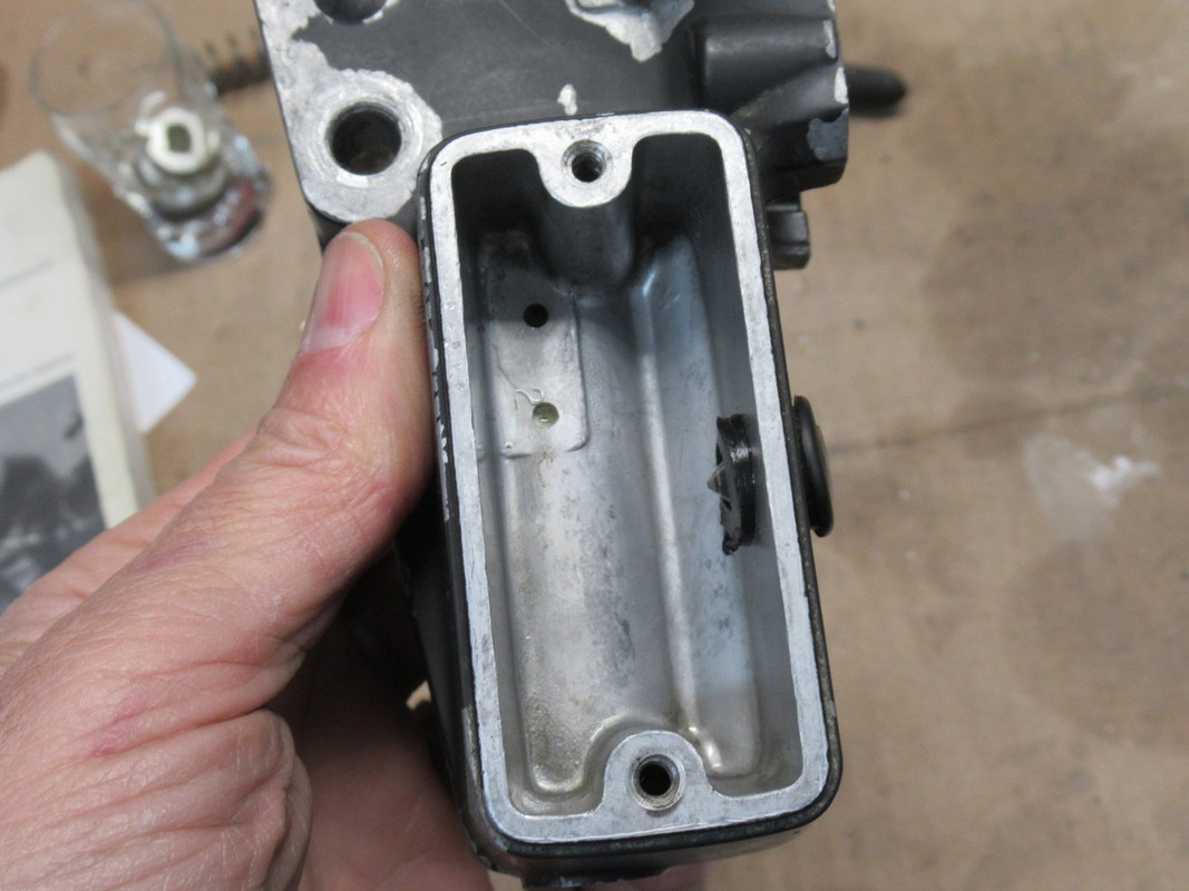

I drained some of the fluid into a small glass of water to confirm it was DOT5. DOT 3/4 dissolve in water.

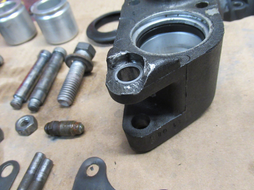

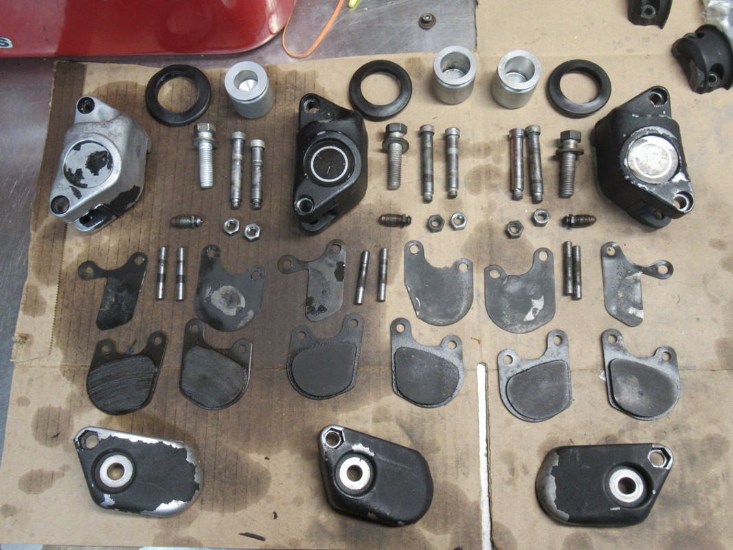

Then I took apart the calipers plus a spare I bought to replace one that had damage near the mounting bolt nut.
Unfortunately I bought the wrong side so I'll use the broken one.
The original paint looks like texture paint, so I won't powder coat them. I should still bake the old silicone brake fluid out of them so I don't get fish-eyes.
[edit: I just bought some semi-gloss powder for the controls and Harley fine texture powder for the calipers.]

What are you doing for the decals / inserts in the callipers?
I bought some from Rick's Decals. I'm not sure how to remove the old ones though.

I would hit those stickers with a heat gun to remove them. They should be metal backed for that year.
Brake calipers have more of a wrinkle black finish. We used to just use rattle can wrinkle paint on them, maybe not perfect but close enough.
Good idea on the heat gun. Yes the calipers look to be Harley Texture Black, not wrinkle black. I found powder that claims to match, will see soon. I have used texture paint on my dash console and it looks perfect.
