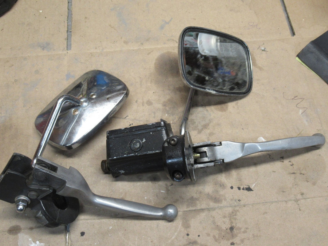

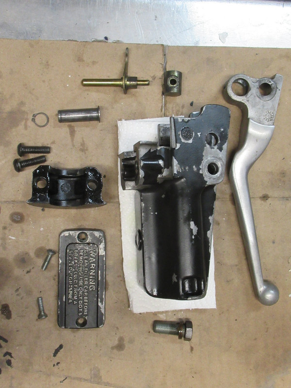

I was going to tackle the main wiring harness, but between hard brittle insulation and some damage, I just ordered a new one from my local shop.
So then onto the handlebar controls:

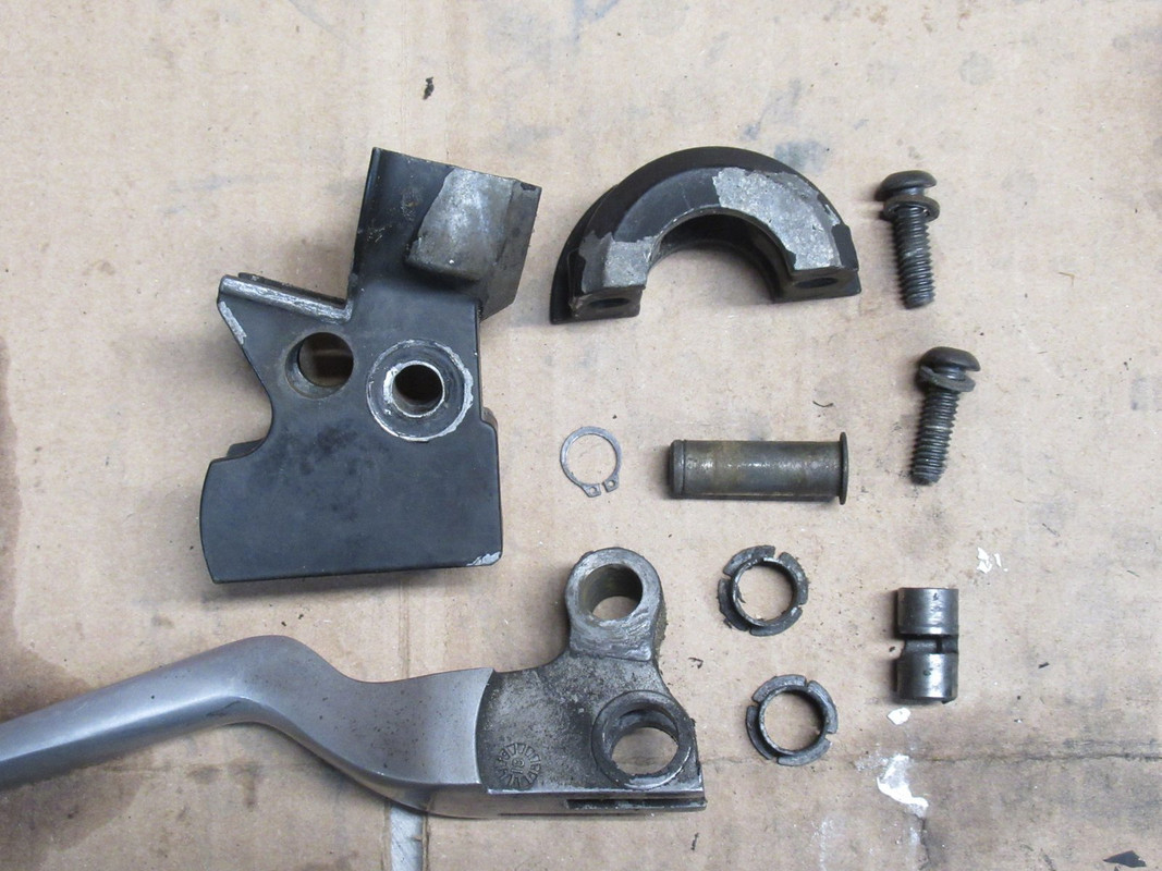

Took them apart, and cleaned them up. The brake side is in decent shape,
but the clutch perch pivot is worn out. I'll have to find a replacement.

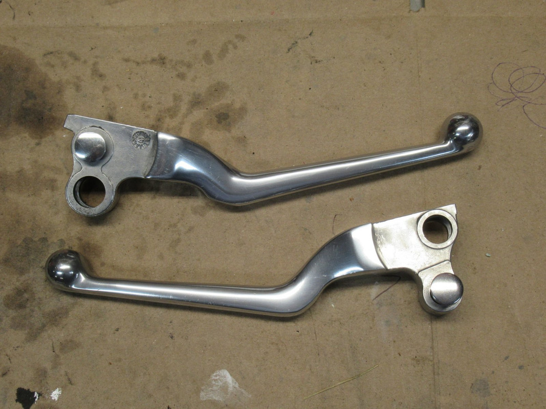

I like shiny things, so I polished the levers and pivots:
Does anyone know what is the correct black paint?

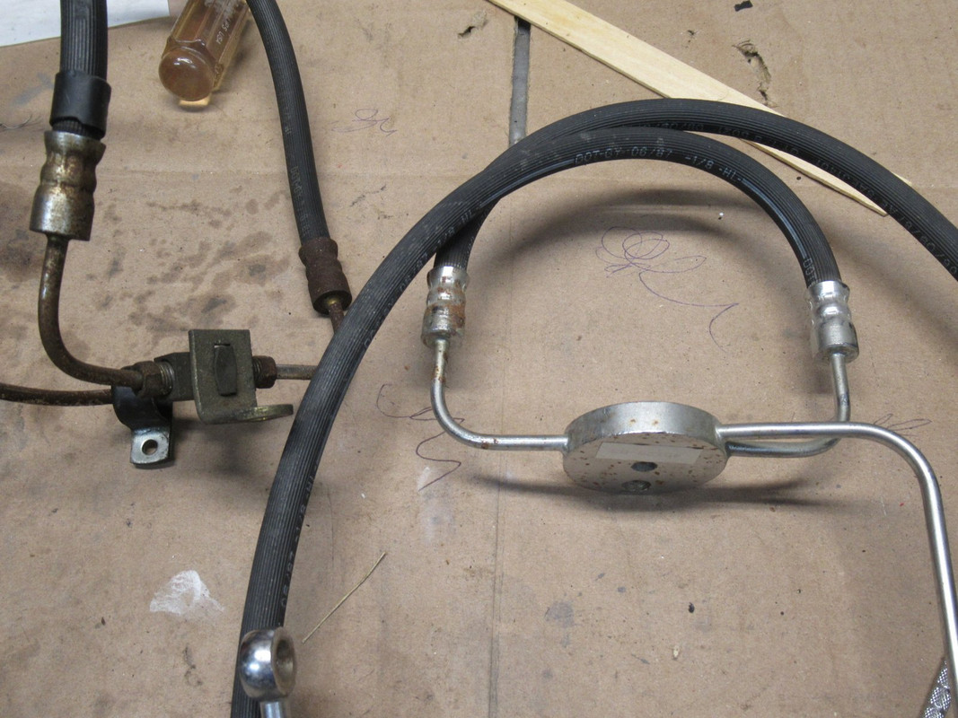

One more question for the experts. It's impossible to find the correct brake hoses any more, they only sell the 83-up one piece hose now. Can anyone think of a reason I can't cut up the one piece assembly and double-flare the ends to use the original junction block? Is the tubing heavier wall than able to be flared?

"Does anyone know what is the correct black paint?"
I blasted and powder coated mine.
Used a 35 to 45 percent gloss level in a satin black polyester powder coat. Case New Holland black. I did everything except the master cylinder. It is a dead on match for the original.
I know you said paint, but maybe the gloss level and brand will help you out.
Consider a harbor freight powder coat set up. It is the perfect tool for restoring the small painted parts like your doing. Powder coat is so much more durable. Less clean up time than conventional paint gun, and no more worries about over spray getting all over the shop. Just a little powder coat dust, and as long as you keep the dust away from items that get hot, it just brushes/vacuums up.

I agree, I have had lots of parts powder coated to a semi gloss and it matches the factory satin paint. I always do the levers to match stock controls, looks clean.

Originally Posted by old mago
arrr the clutch pivot..a very neglected part of the service routine.....which reminds me......
I've replaced the clutch purchase on my 81 and 83. Since the pivot pin for the CLUTCH LEVER is steel against aluminum with no bushing, elongating of the purchase seems in inevitable. What's your secret.
