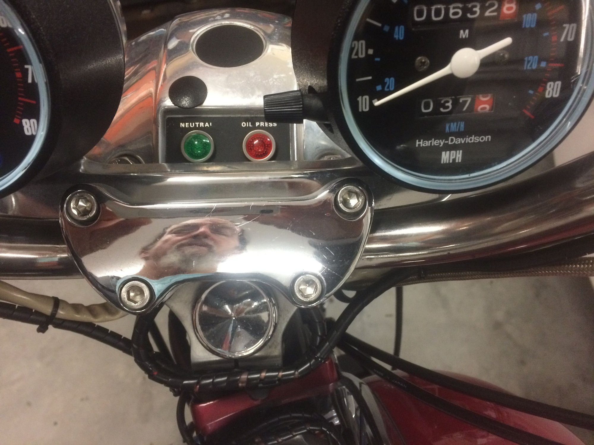

Hey Joe, you are a man on fire! FWIW in my opinion the OEM neutral and oil lights are difficult to see in the bright day. I could not tell if my oil light was on when parked in the sun when starting up. Going down the road I doubted that I would even see the oil light come on. I found LED's that look just like OEM and they drop right in the bezel with no modifications. They are very bright in all conditions.I got mine from a local boatyard but here's a link to some that look like the ones I have. https://spemco.com/red-round-12-volt...s-1092qd1-12v/. No splicing for a clean install.

Here's what they look like off

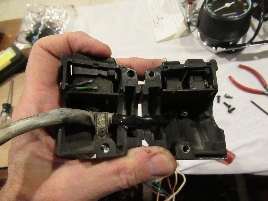

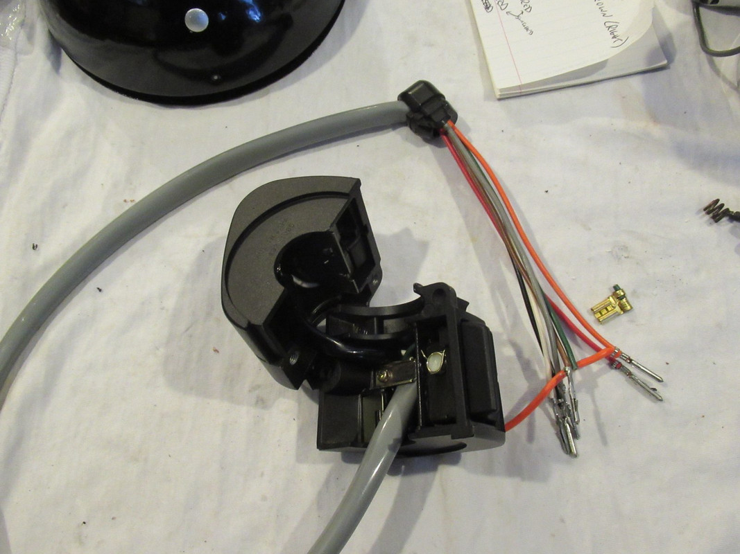

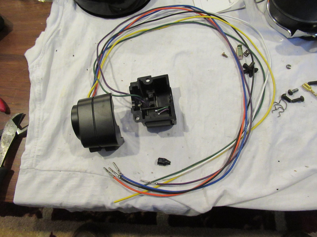

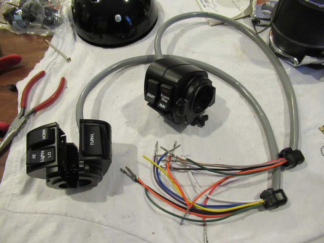

Today was a snow day so after snowblowing about 6" of the white stuff, I tackled the handlebar wiring.
Here is how the original switch wiring looks. Notice the grey wiring sleeve is held by a clip, then it turns black.
The NOS OEM replacements come with black sleeves, so that had to be removed. Some of the wires have spade terminals that needed to be cut off.
It was a struggle, but I got the wires into the new grey sleeve and installed the strain relief clip. A little dawn dishwashing soap and water helped.
Repeat as necessary, and install the throttle stop screw. The tiny retaining clip was surprisingly easy to install with needle nose pliers.
Bike shop is closed, so I'll get new spade terminals and button head screws and put them on the handlebars tomorrow.

I need two little things to finish this up:
First, they stopped using the wire clips to hold the switch wiring to the handlebars, started using these plastic ones: 56070-81 RETAINER. JWBoon has them for under $2, but the vultures on eBay want $30 each! Anyone have four they would sell for a reasonable amount?
Second, inside the right housing is supposed to be a little flat metal piece: 56396-74A FRICTION SPRING, THROTTLE GRIP. That's still available thru the dealers, so maybe I'll just take a run over on Monday.

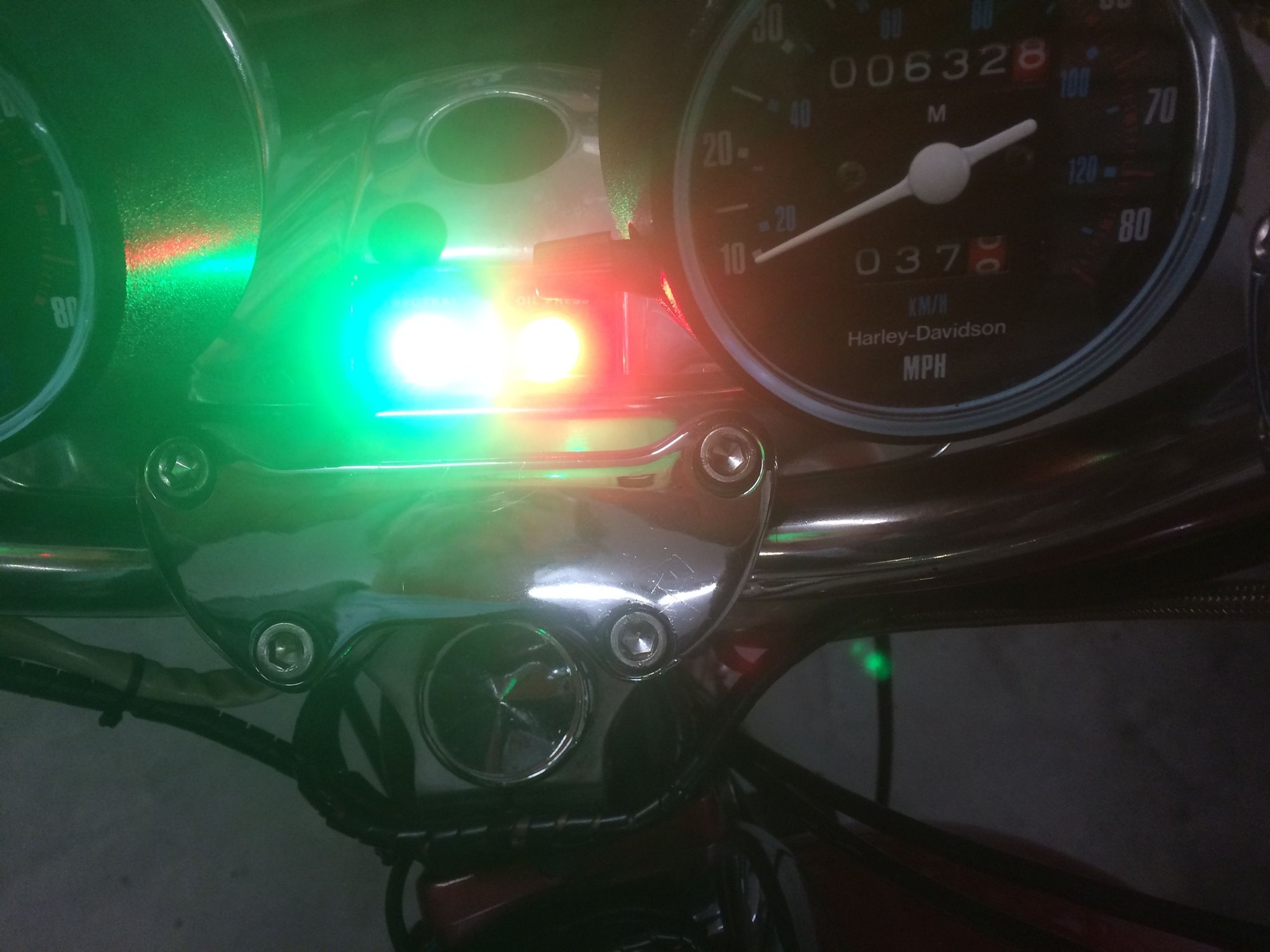

No success, so got someone to order the clips from JW Boon for me.

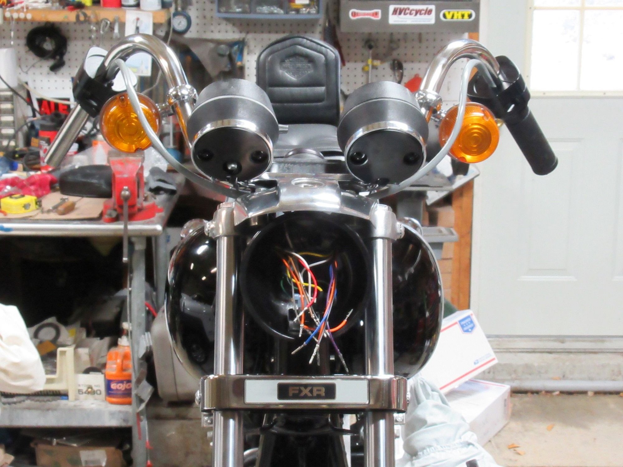

Meanwhile the oil pressure and neutral lights came in today so I was able to finish up that wiring and install a few parts:
When I get back from Florida next month I'll finish up the wiring. Maybe the motor will be ready for me too?
