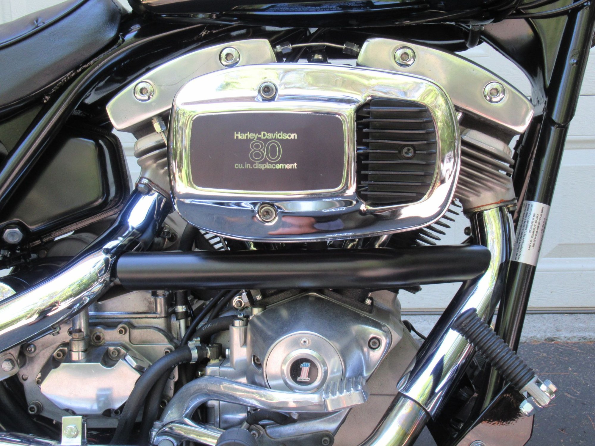

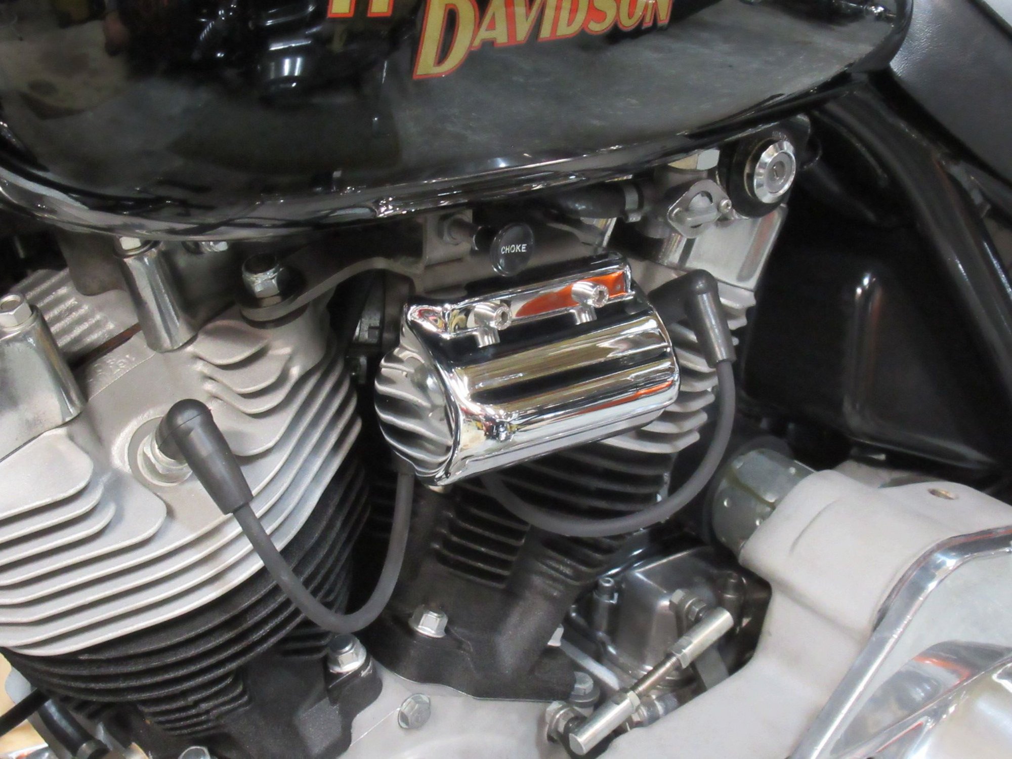

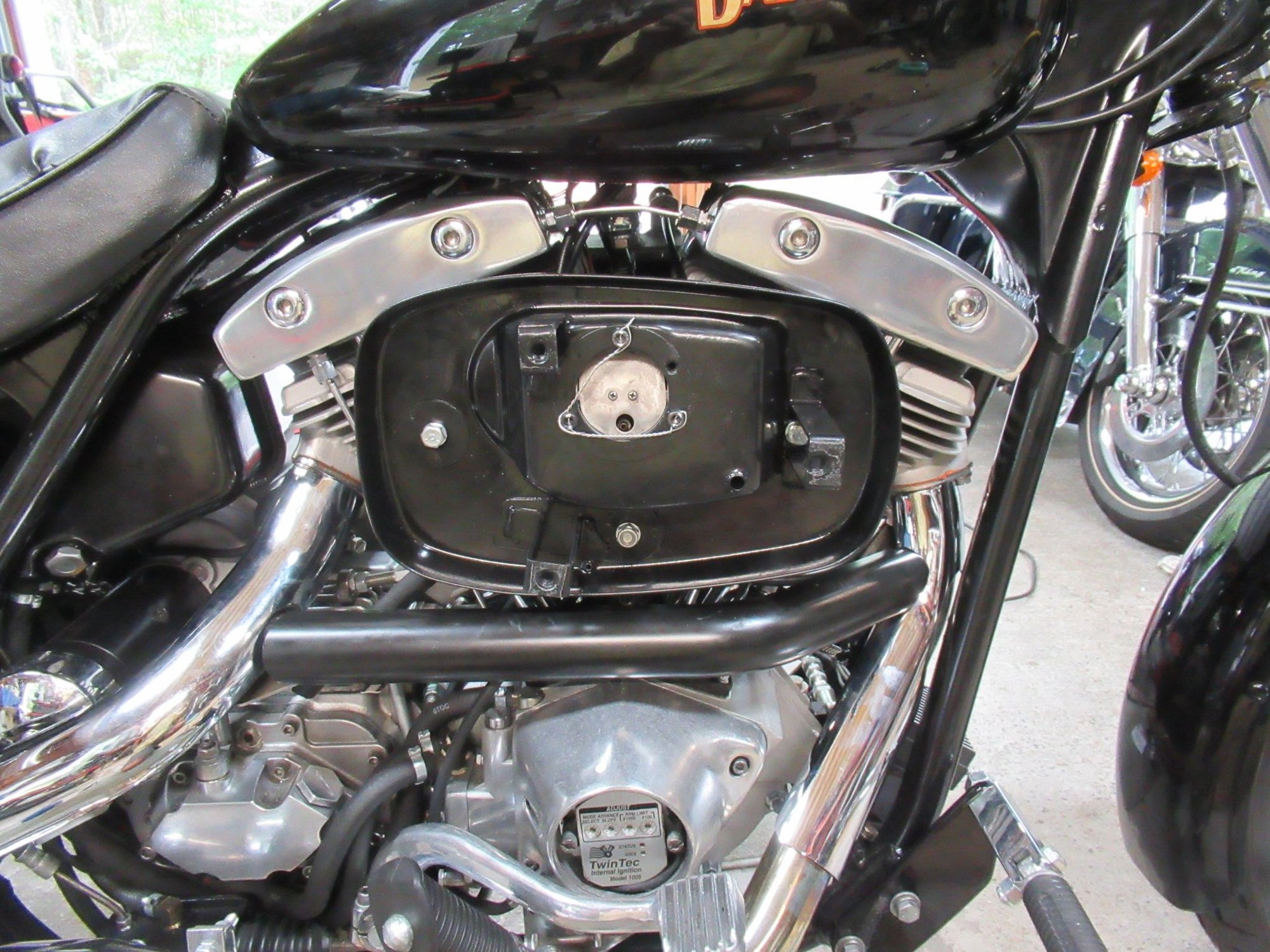

Here are a few pictures of the last minute thrash that I didn't have time to post. The ham can backing plate is attached to the motor by three big brackets. One to each rocker box and one to the middle crankcase bolt. I assembled it three times to get everything lined up right and the bolts loctited. The three bolts to the carb are supposed to be drilled hex head bolts, but allen heads are easier to drill.
I wound up buying three ham cans to get one in excellent condition. The washers behind the mounting screws have rubber ones behind them. I had to trim hardware store rubber washers to match.
The timing seemed good, so I did pop-rivet the cover in place.

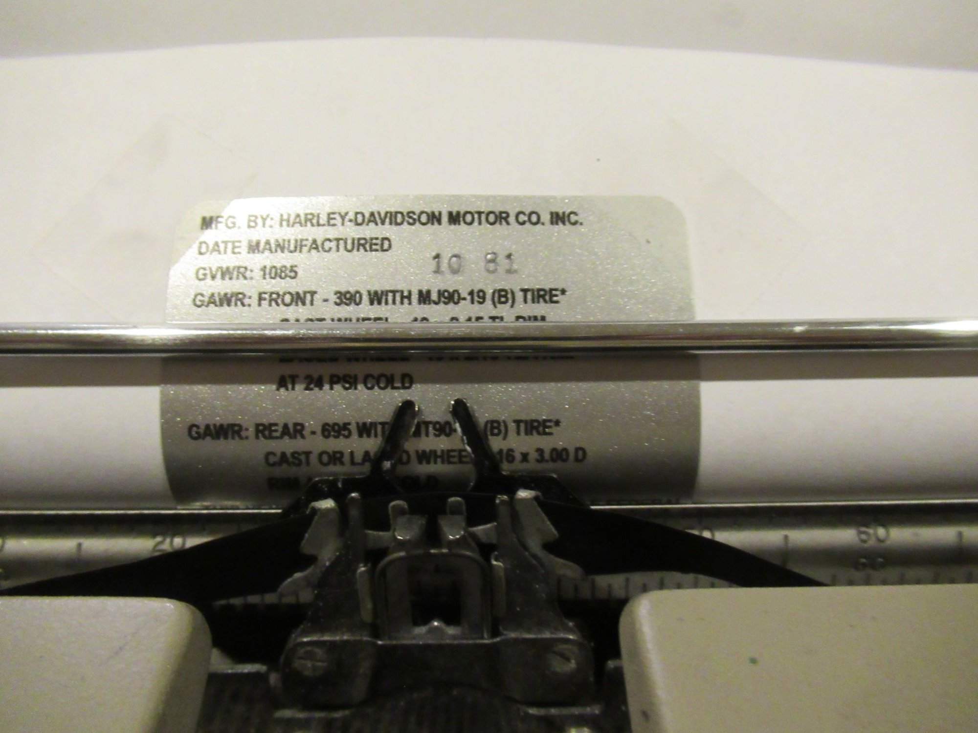

The VIN and GVWR sticker is reproduced by Rick's decals but he doesn't type your info on it. My mother still had this electric typewriter from when she was working, and it did the trick. I had to go over what I typed 5 or 6 times, but it came out OK. Font isn't correct but the judges didn't seem to notice or mind.

I fixed the two easiest deductions. The new HD spark plug wires came in yesterday, that was half a point:

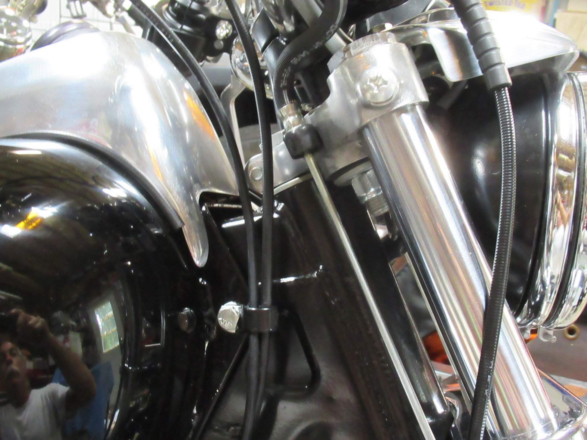

One quarter point for moving the throttle cable clamp to the tank from the triple tree.
