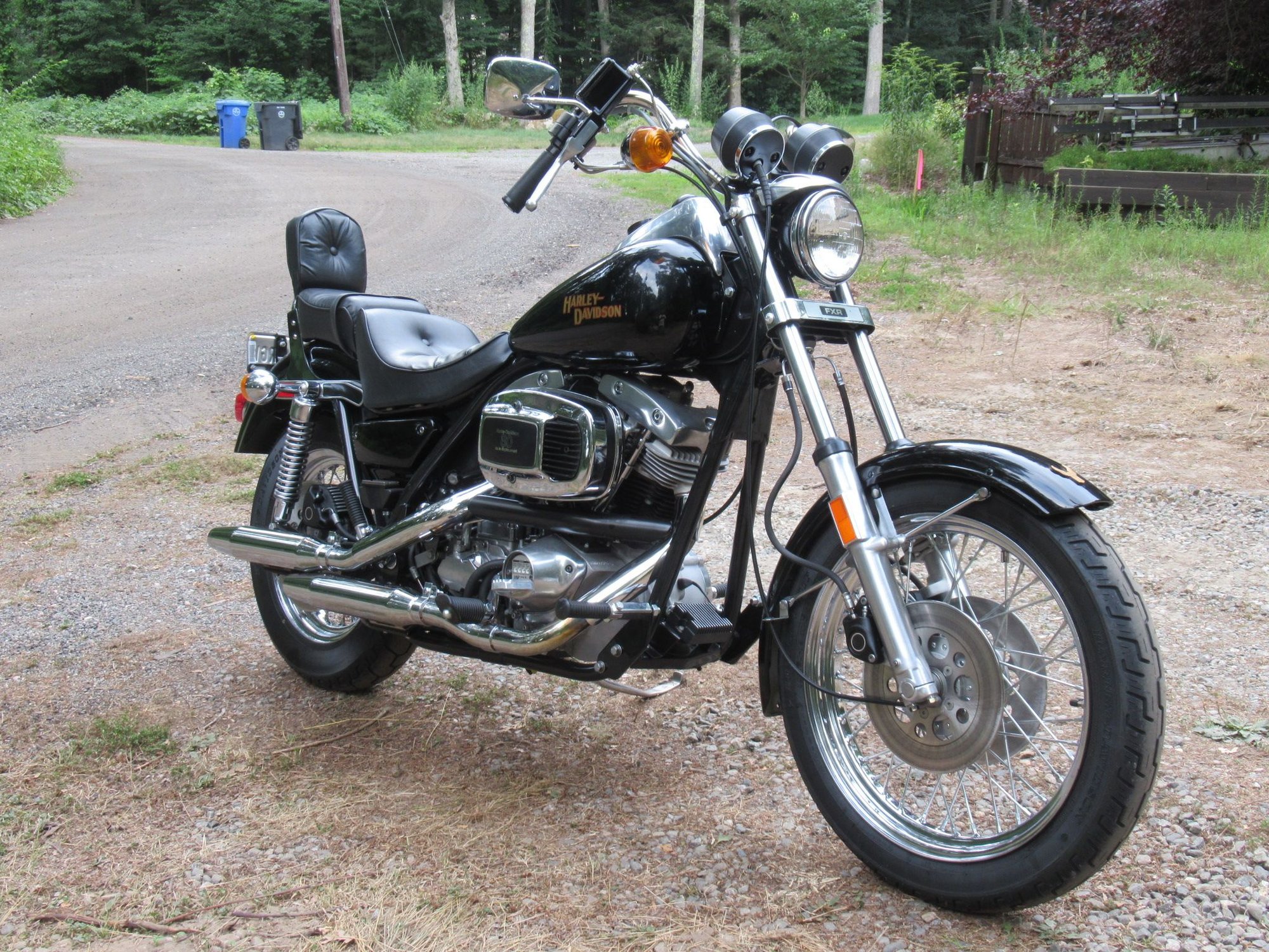

I thought about it a while, and changed the jets to 72/175 for break-in, I thought it would help keep the motor cooler.I took it out on the road today, two 10 mile runs, and a 30 mile run! Looks good in it's native habitat, the lot where they are building my new house:

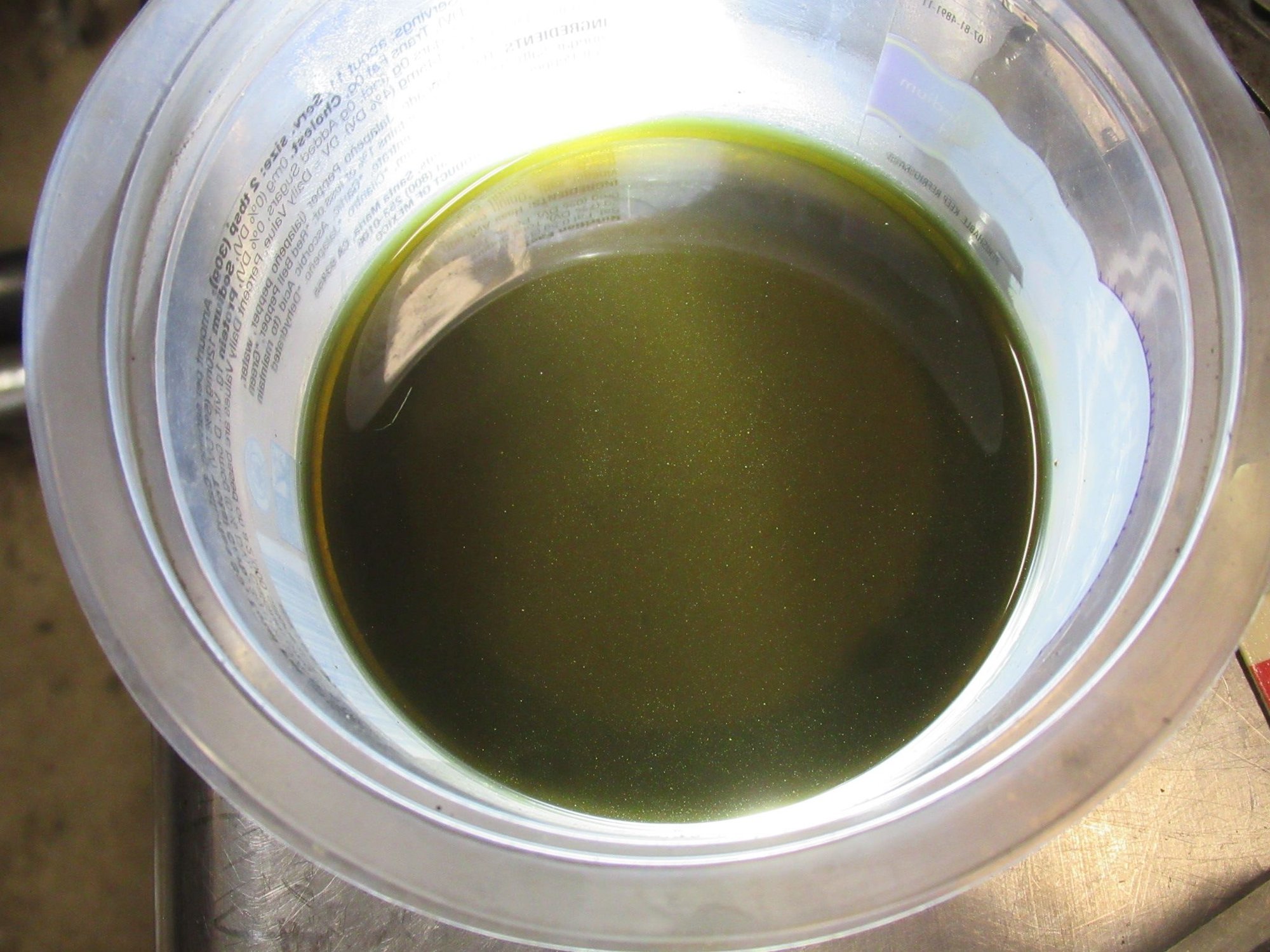

Here is why you change the oil and filter after 50 miles. Poured this oil out of the filter:
I'll change it again when we get back from the show.

Thank you. I am very happy to report the judges really liked my bike! Only found a few faults, scored 98.5 points! Got both Junior awards, and enough points for Senior and Winners Circle in the future.
I can easily correct two half-point deductions by fixing the upside-down front muffler clamp and missing heat shield; and getting HD plug wires. The throttle cable guide needs to move from the upper triple tree to the gas tank mounting bolt for another 1/4 point. They noted scratches on the outer primary but didn't deduct anything. I'm on the lookout for an better one, and when I get it I'll fix the charging system too. The last 1/4 point is for the plug on the idle mixture screw, and if I get the bike running perfectly I'll have my brother turn something on his lathe.
