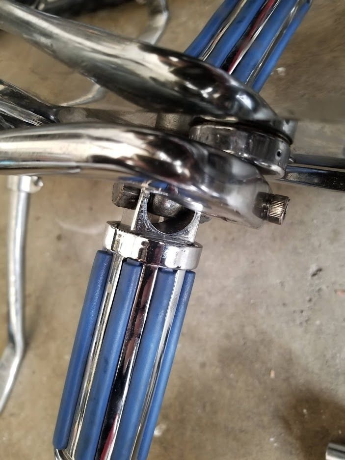

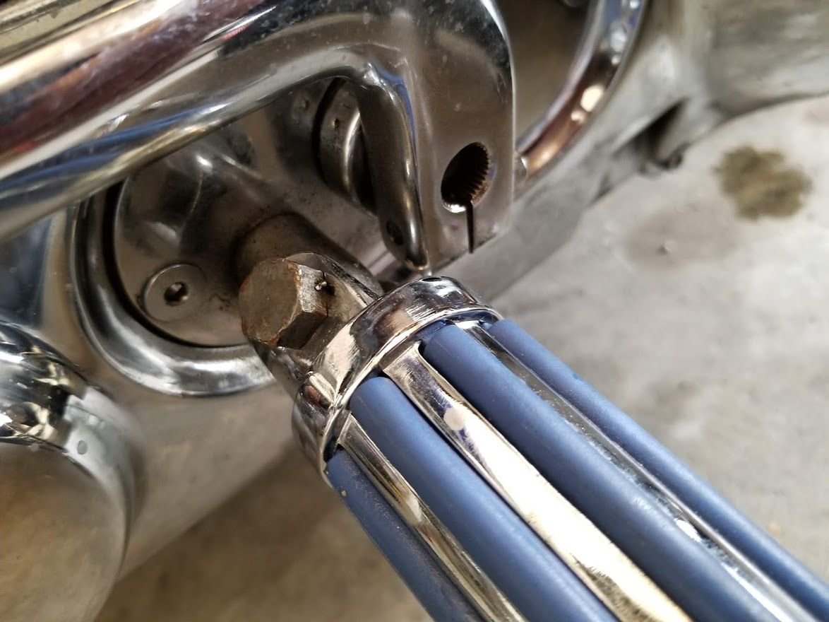

I noticed one strange issue. A shifter pedal doesn't sit all the way on a shaft. I checked internal side of the primary and pushed the shaft just to make sure there is no any slack. Still it looks like the shaft is short. I'm curious maybe it's not original shaft or shifter is too wide.

The spacer does not look correct to be behind the shifter and the shifter looks evo to me - i am not versed on the nuances of model changes year to year but the lever look correct from the back that leaves the other stuff

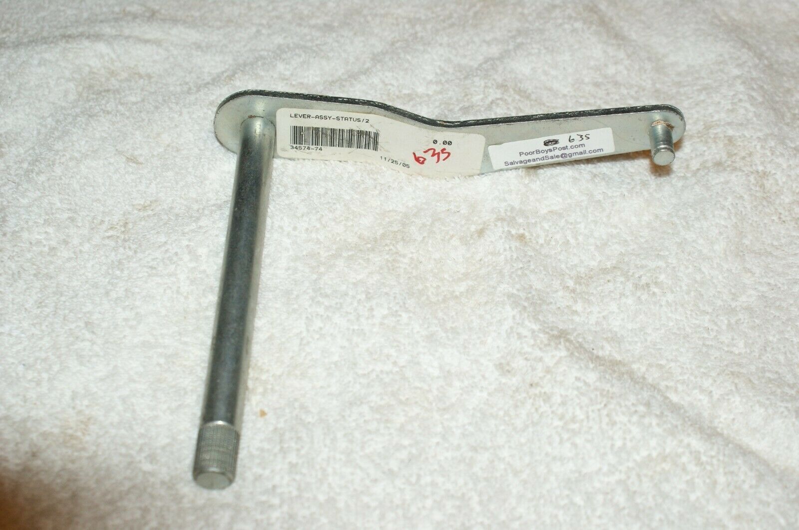

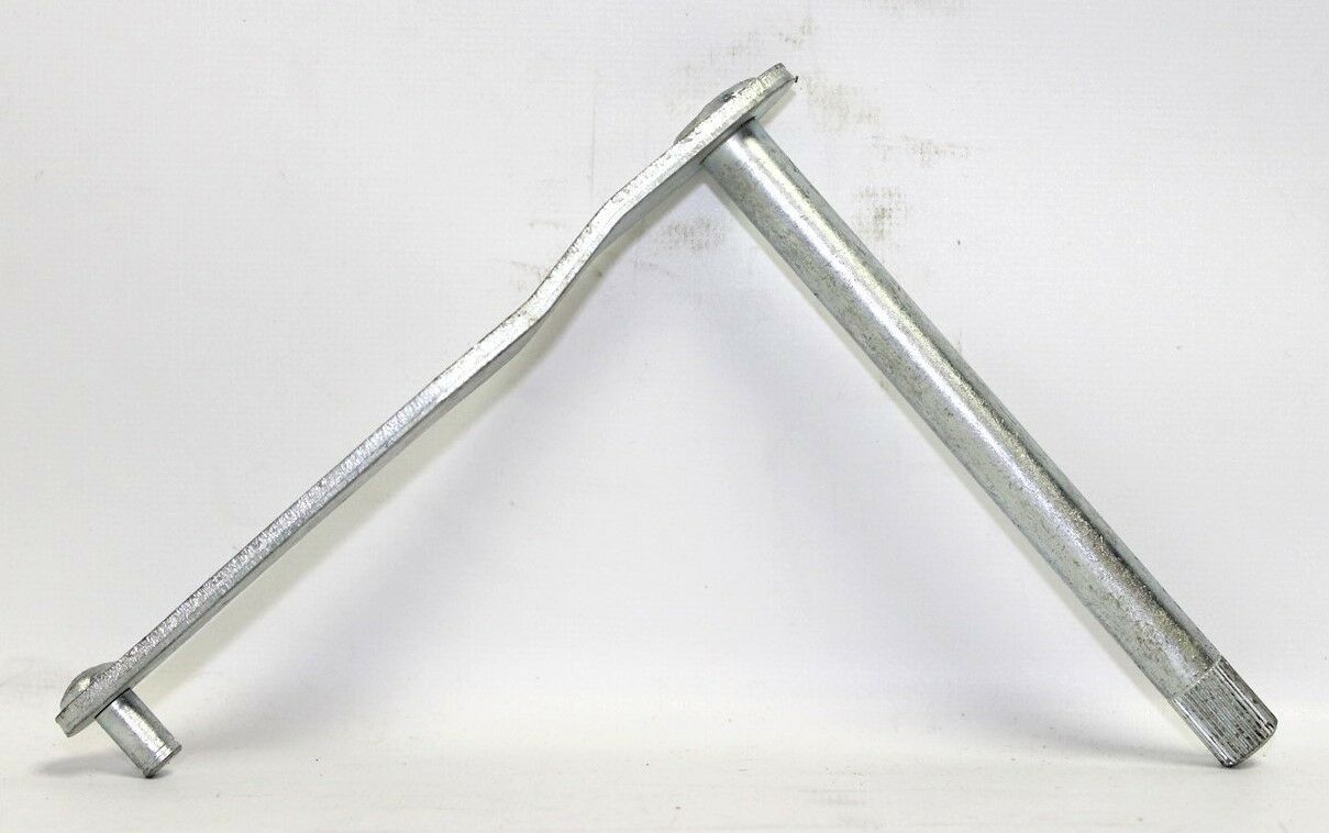

Also I found there were two versions of the shaft in 1979: OEM 34574-74 Shaft length 5 1/2" or OEM # 34574-79 Shaft length 5 3/4"

I've got an almost original 78-1/2 FXE. In the pic you can see that like yours, mine fits the same way.
For sure thses parts are original. It was the same when I had an absolute stock 75 FXE.

>>It would be interesting to see the two side-by-side to get a visual of the difference.
I checked them on ebay. They are slightly different.
74:
79:
