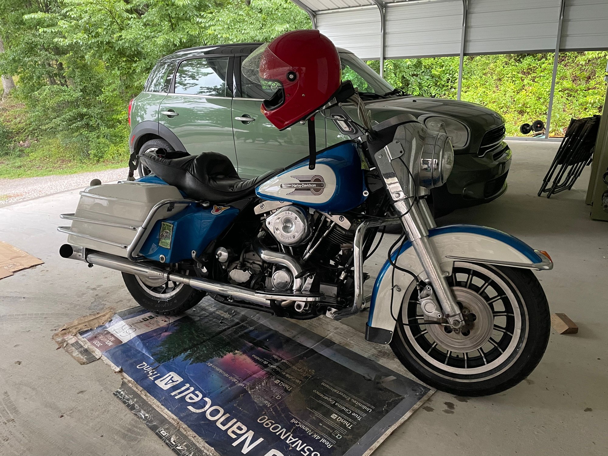

So a week ago I drove all day and night and day to pick up this sweet 1980 FLT. From Chattanooga TN to north Chicago IL. This was by far the worst road trip I have ever made in my life thanks to the constant construction, multiple wrecks and horrible storms. What should have been a 20-24 hour trip took 36. But all that aside I now have this amazing shovel and couldn’t be happier.
I took her for the maiden voyage Friday and realized fairly quickly that the brakes are horrible. I don’t mean like they are 41 years old and that’s how they work. I have ridden bikes with just rear drums and cars with manual drums all around that stop a million times better than this thing.
So I started looking online and found out that parts are kinda scarce. I can find some NOS right side calipers but not the left. I can find pads. And the main thing I think is causing my grief is the brake line rubbers. Haven’t looked for them yet as I can just have some made up locally by my work.
The front pads are fairly thin but not horrible. The rear pads look great. Rotors are suspect as the fronts are fairly wavy and the rear, while smooth, has a few cracks.
I’ve read that the calipers are kinda “loose” in the front and there is a strip of padding between the leg and caliper to combat this. I removed the left side and found this pad intact. The right side I couldn’t get off because the nuts are spinning inside the caliper but I looked and it does not have this pad. Is it normal for them to have so much movement on the sliders?
At slow speeds, say 10mph or less, there is a very loud clattering noise that the seller told me was the speedo cable or the drive. While I know they will make noise similar to this if I look down I can see the lowers shaking and it leads me to believe that it’s the calipers getting in a bind from being so sloppy.
So I guess all in all my question is can I make this thing stop without updating to a newer brake set up and what is up with the rattling shaky calipers? Here is a pic of Lucy.
