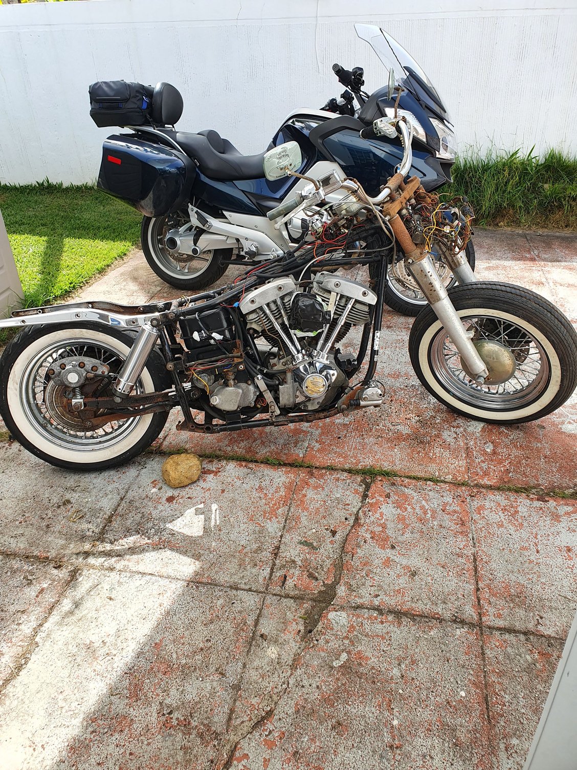

So I have began. I slapped a hot battery in her, wrapped on the stuck carb that overflowed, and gave the button a push. She fired right up, 3 different times the carb definitely needs rebuilding. She spewed oil out on the primary side, so I shut here down. I pulled chrome colored (not much chrome left) parts off today and gave them a good degreasing and 0000 Steel Wool scrubs.....The pitting is pretty rough, it seems like they sprayed the bike with sea water everyday for the last 3 decades. But, I am going for it! I am going for the cleaned up patina look to avoid tetanus. I want to do these things for sure and I am asking for everyones advice to buy certain things, Like Caliper rebuild or complete calipers (Used is fine by me). One of the fork tubes seems like it is out of round, the upper scrapes on the lower tube, So I am not sure it I can redo the fork seals or if I am safer buying a pair of bottles (used is Ok). The wiring is a rats nest, I am fairly certain I am going with a new wiring harness.
So besides J&P.
VTwin Manufacturing (Not sure if I can buy with them I am not a dealer)
and Ebay,
Where else on the internet can I source good used or new parts...I think used is best because the bike will be patina barn find and no prettier. I want her to go good, and stop smartly.
I might wnat to find a set of fenders too, they drilled holes in them to put those tacky studs and bling on there.

Whatever you do, DO NOT throw ANY of those parts away, They may look like crap, but to somebody else they are valuable. Some may be aftermarket already, but everything has trading value......As far as the fenders go, Start looking locally for a Good welder, alot of those holes can be filled and ground flat, It's always better to try and rescue original parts. Most of the Aluminum Parts can be repaired by a GOOD welder. Make that one of your first Rules!

The V-Twin wiring harness is made in the US, so it is my first choice if my FXR needs one. You should seek out a good local independent shop that can get parts for you. It will be beneficial for many reasons.

A little progress today.
So far only one screw sheered off on a turn signal and only one bolt found drilled out on the rear fender.
