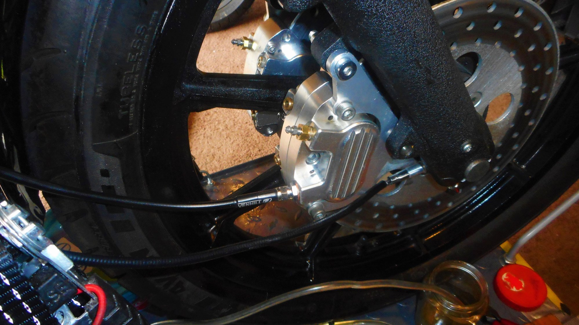

the twin disc 35mm front end for a mid 70's Shovelhead will only take the stock single piston calipers unless you get a fitting kit (hard to find now days!) & fit either GMA, Performance Machine or even Tokico & Nisin calipers.
i have just fitted a set of GMA calipers to mine, two 4 pot calipers with a 2016 11/16 road king master cylinder & steel hoses & it stops on a penny with great lever feel & feedback.

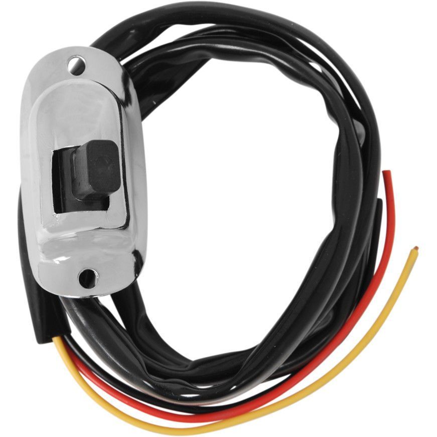

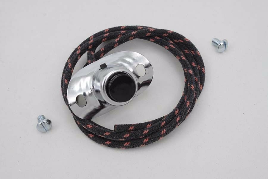

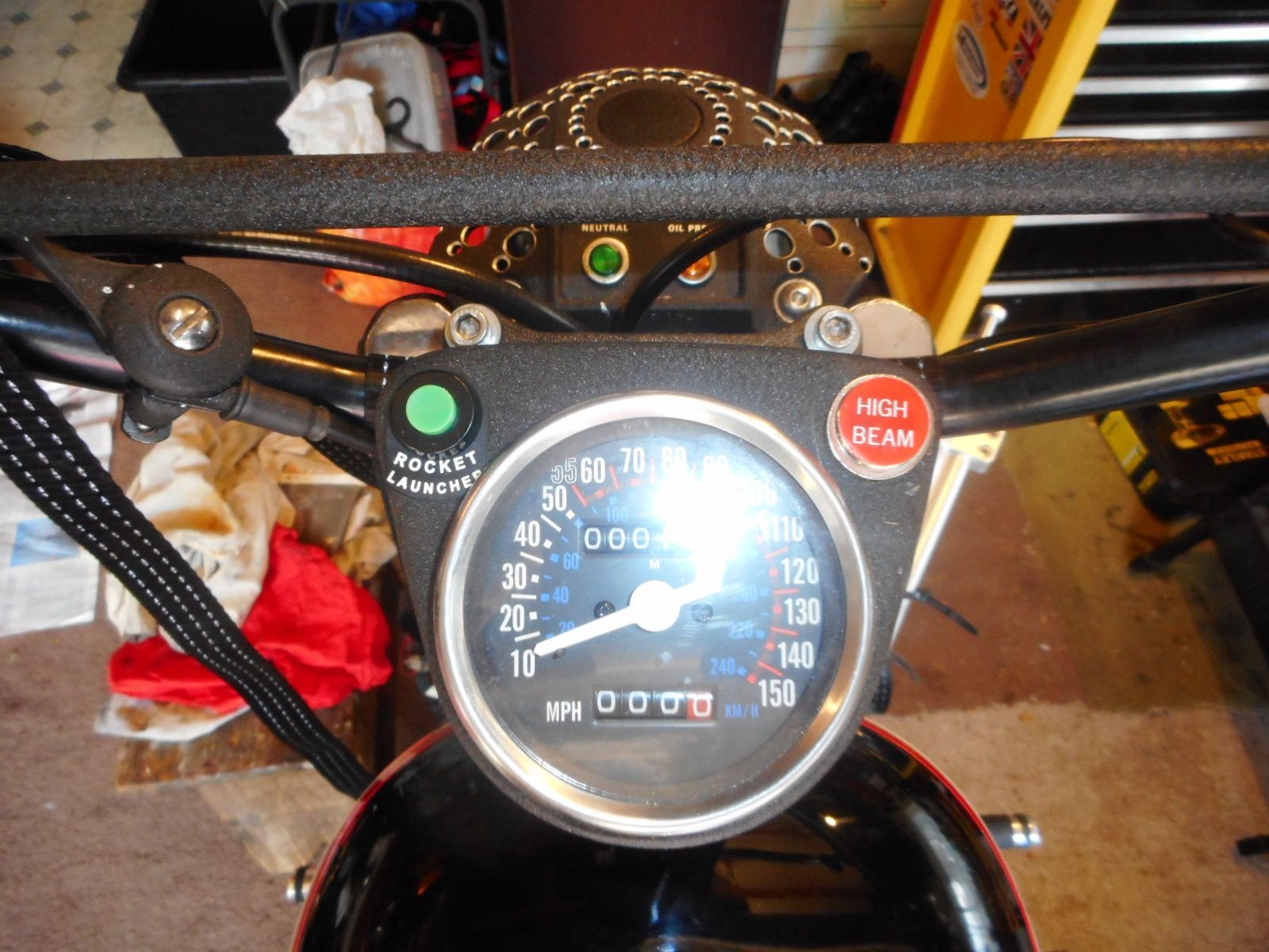

I have two old style Harley Push switches, one for Horn one for magneto kill,
& an old style change over switch for Hi & Lo, I like these old style switches as they are small, tough & wiring is easily hidden, always a good thing.
Starter button is on the dash marked 'Rocket Launcher' for *****
The main key switch handles lights on/off, Being in England, we are NOT forced to have turn signals so didn't need to bother with any of that ****,
