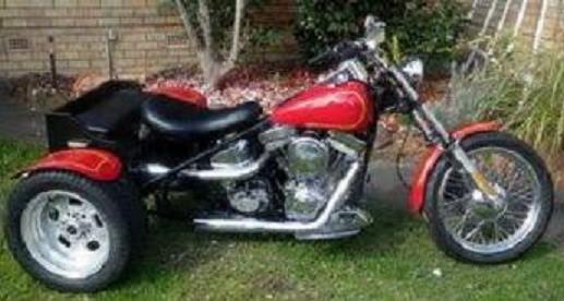

any way to get a better brake pedal before brakes work. it seem to go down a fair way before working . fluid level good and has new rear cyclinders fitted thanks

Air in the system with a use a soft pedal and excess travel
if the caliper is lower then the master you need to remove it and lift it so its above and then bleed it

Yes to John... and i will add sometimes the actuating (plunger) rod can be too Short... (or too long) Thanks to the Aftermarket

is there an adjustable pushrod available. thanks

While that seems logical...I have not seen one for this application...
