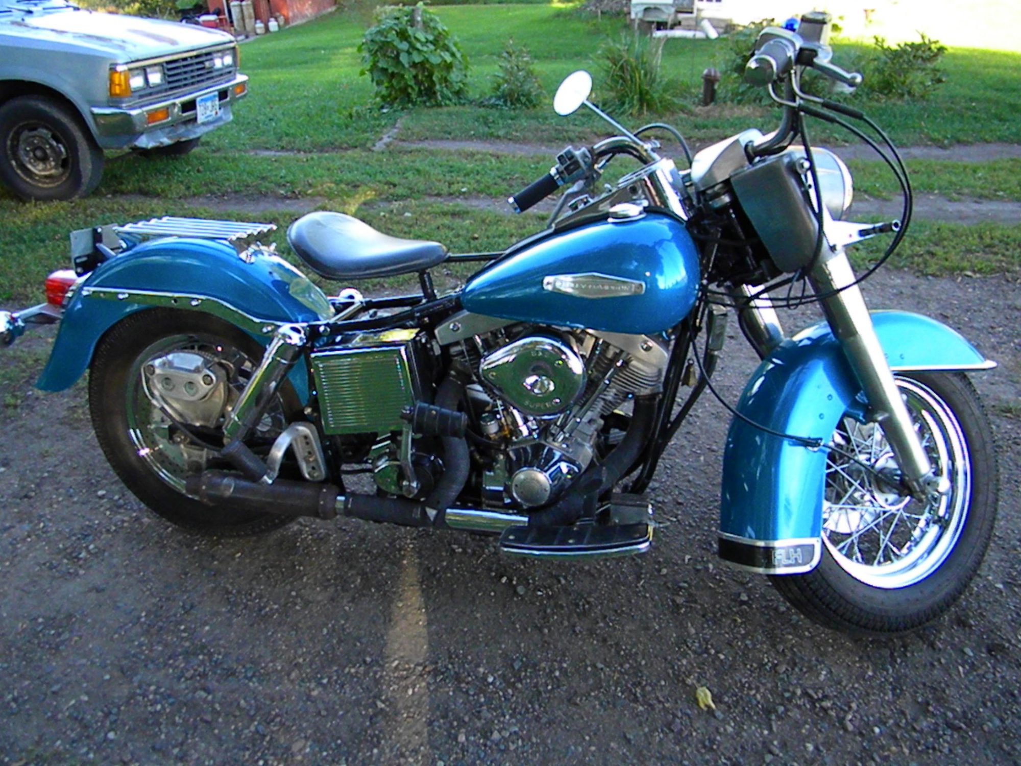

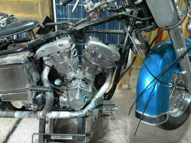

With this brake I can't see how this will work. bolting the brackets to my fender struts they will be against my caliper. I dont want to have to go to a banana, but I want the bags. I need advice. Thanks

Those are the wrong saddlebag mounts for that year. The proper ones will miss the brake.

Can't guarantee that the proper mounts will help with the caliper you are using but I remember guys "relocating" the caliper to the "6 O'Clock position on certain applications
What year bags are you trying to mount ??

That is the factory caliper for that year. Here is the right side mount for your bike:
https://www.ebay.com/itm/23219503775...sAAOSwxYxUuTCJ
Couldn't find a left side, but they look similar.

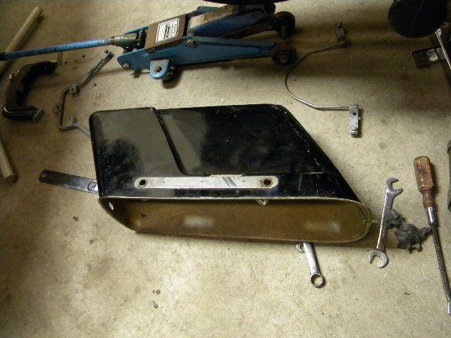

That figures. Do I have the rite bags?

Yes you have the right bags for that scooter ...The mounts would look more like this ... There is also a curved bracket that attaches to each bag mount at the bottom rear ... It goes from side to side around the back of the rear tire
Bags were the same for many years. Larry, those brackets are the same as the ones that don't fit already. The ones he wants are part numbers 90875-77A and 90877-77B (right and left).

... Yes ... I have the same bags you referenced on my 79 FXEF ... I didn't catch the square vs rounded corners at the rear :<(

Rite, Those are what I have. Opening presents now, look forward to talking later. Merry Christmas!
