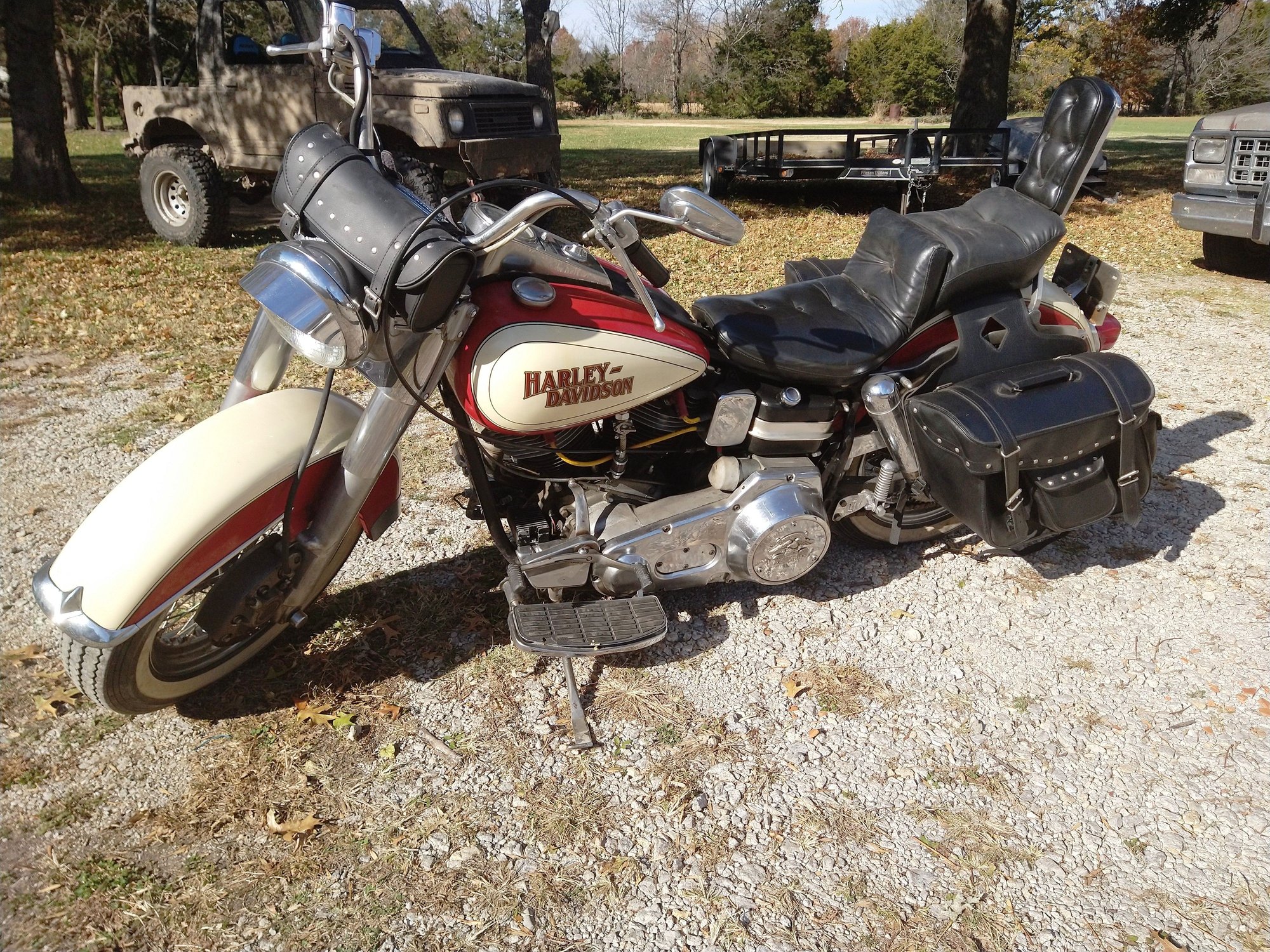

My 93 FXSTS for a 78.
It's the 74" inch which I believe was the anniversary edition.
The guy says it has some buggered up wiring but it all works.
He has a new bendix but hasn't installed it yet and says it is mechanically sound.
He said it has some shade tree splicing and such which I don't have a problem with as long as All I need to do is replace and not figure out what it's for.
I never owned a shovel but worked on a lot of them 30 + years ago.
What can you all tell me about a 78 that I might need to know?
Theses are the only pics I have of it right now.

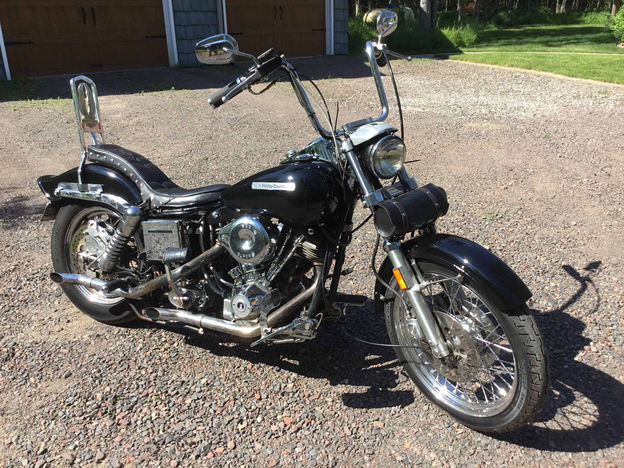

I have the same pipes on my 78 shovel 74cu. Yup you need to wear ear plugs when you start and ride it but they sound nice.
Your service manual will frequently reference early 78 and late 78 parts and methods of repair. AMF changed a lot of the build on the 78 models halfway through the year. IT’s not really a big deal but it’s a bit weird. I’m guessing you know all this since you’ve worked on them but I’m just sayin’ Once you go through it and get the bugs out, it’s a hell of a fun ride.
As far as wiring goes. You will want to go through every wire and every circuit as time permits. If anything, for piece of mind. If you know your circuits are all sound, you won’t have to worry about it.
They certainly have a good vibration in that motor at high RPM’s. I love mine and prefer it over my 2014 Ultra-limited for short rides around town for ice cream.
