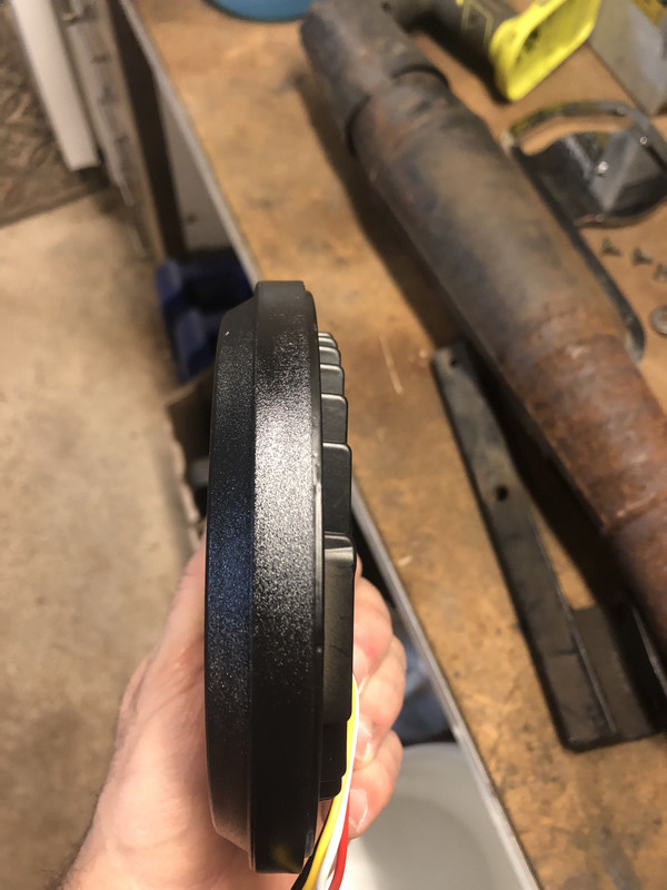

Moons MC hands down. Clutter in the headlight bucket? No worries with this light! Look how thin it is. Installs in minutes. Plug and play. Bright as hell! Love this light great quality.
