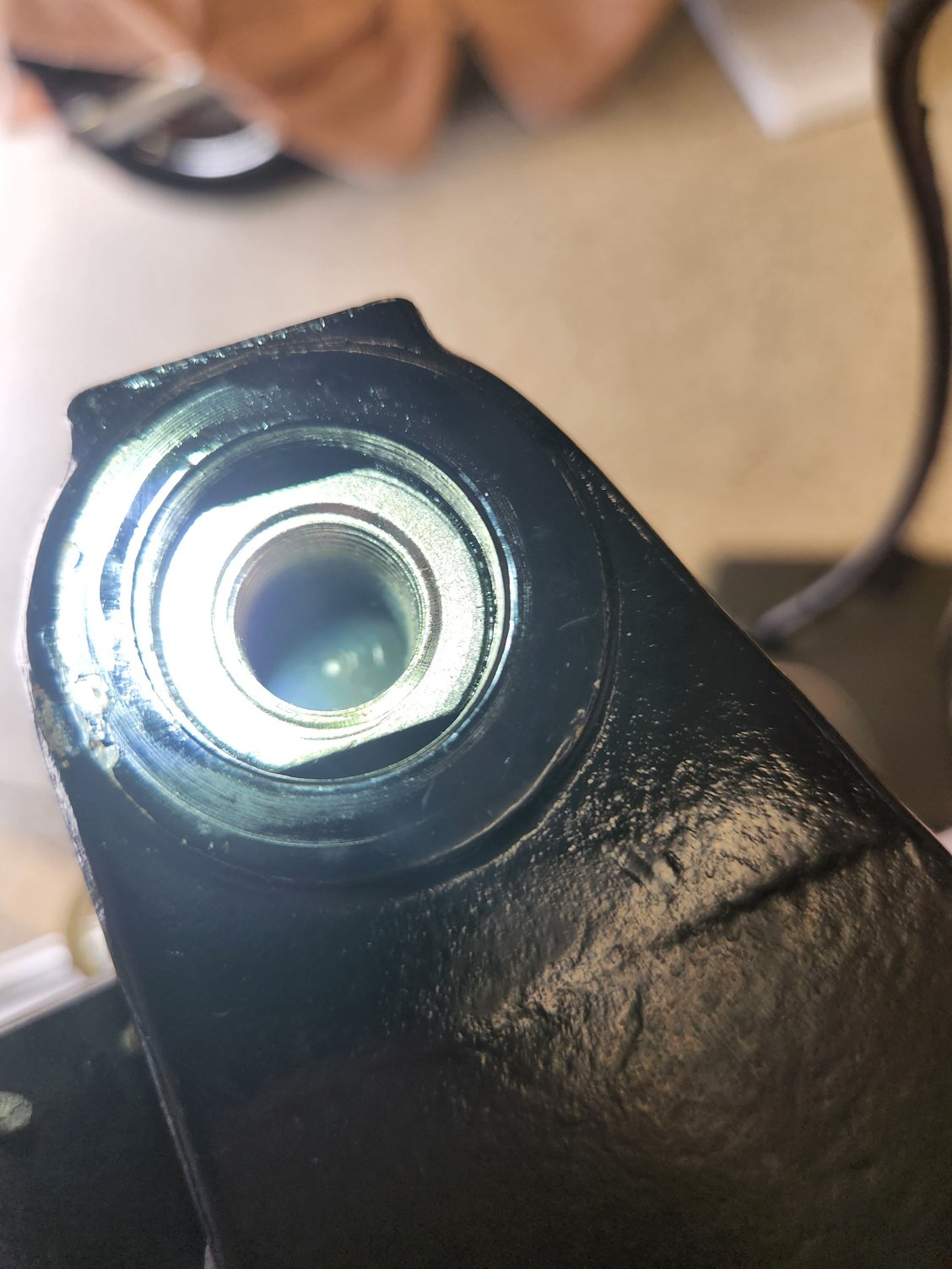

These two photos are the best I can get looking into this hole. I have poked and prodded and cannot find any holes.
I have ordered a syringe and will attempt to backfill once I have the tool. I will report back as to success.

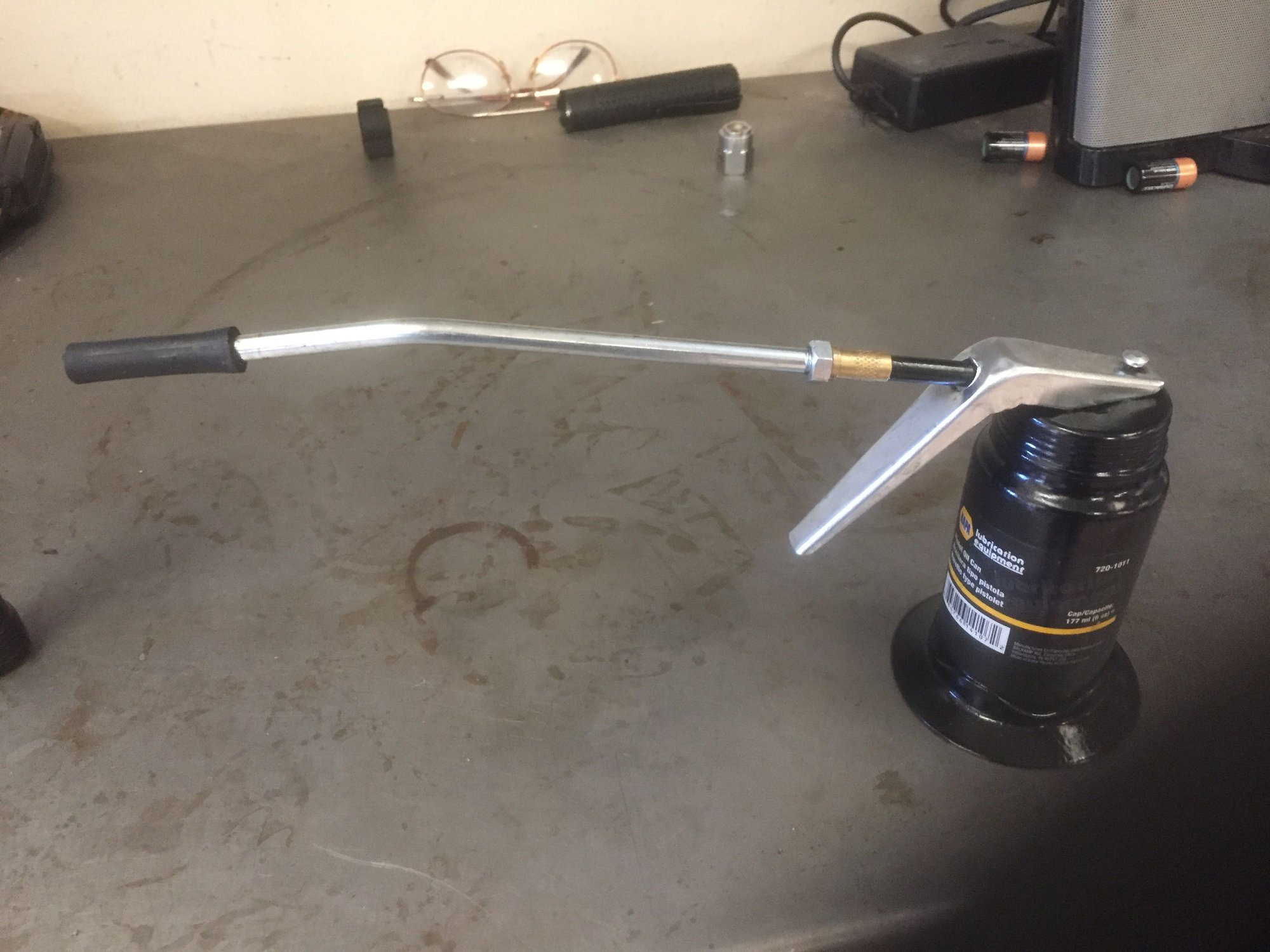

There appears to be a small white circle in the center. That should be the Hole perhaps filled with silicone? I use this can to fill through drain plug. You’ll need to add a bit more oil because you’ll lose some when you remove the oil can and install the plug. Best to clear the hole as Panz suggests as it is also a vent.

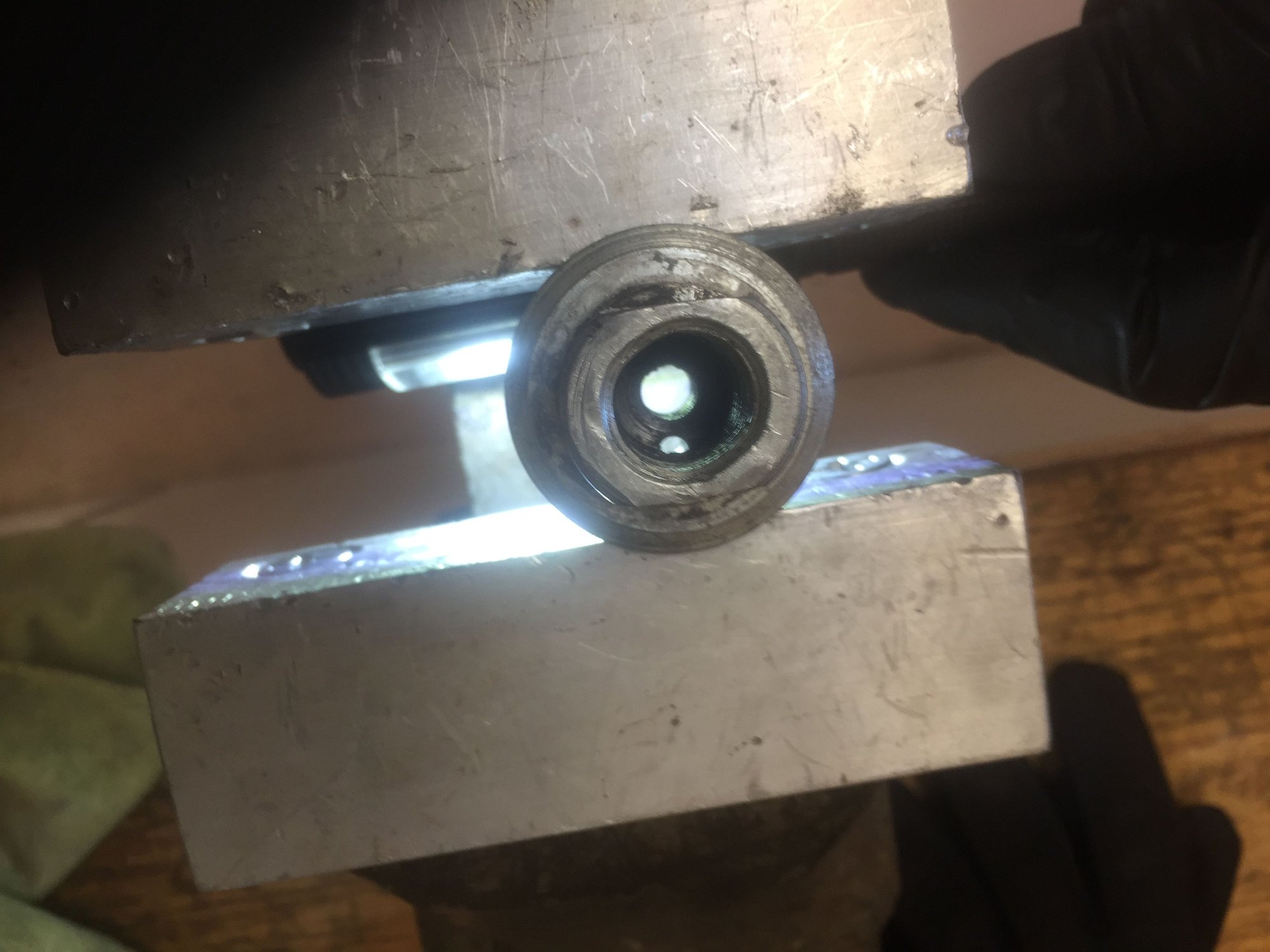

This plug came out of a ‘67 FLH that the PO cross threaded. Should be similar to yours.
