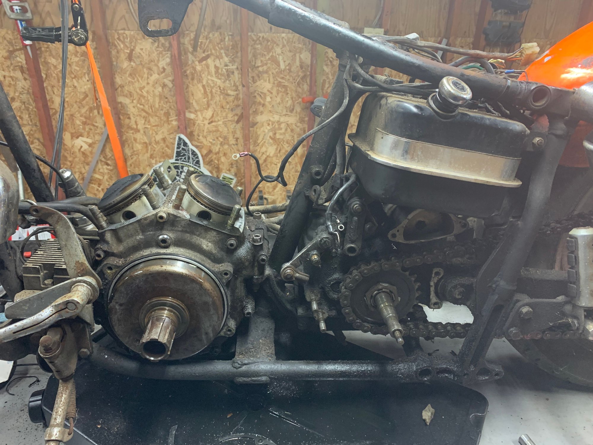

This isn't going to be a perfect restoration, rather a cleaning, repair/rebuild and repaint. A factory resto would be impossible and I couldn't afford it. Just want a clean shovel to go with my Evo's, Twin Cam and M8. Besides, a lot of the newer, younger riders have never seen a kicker before.

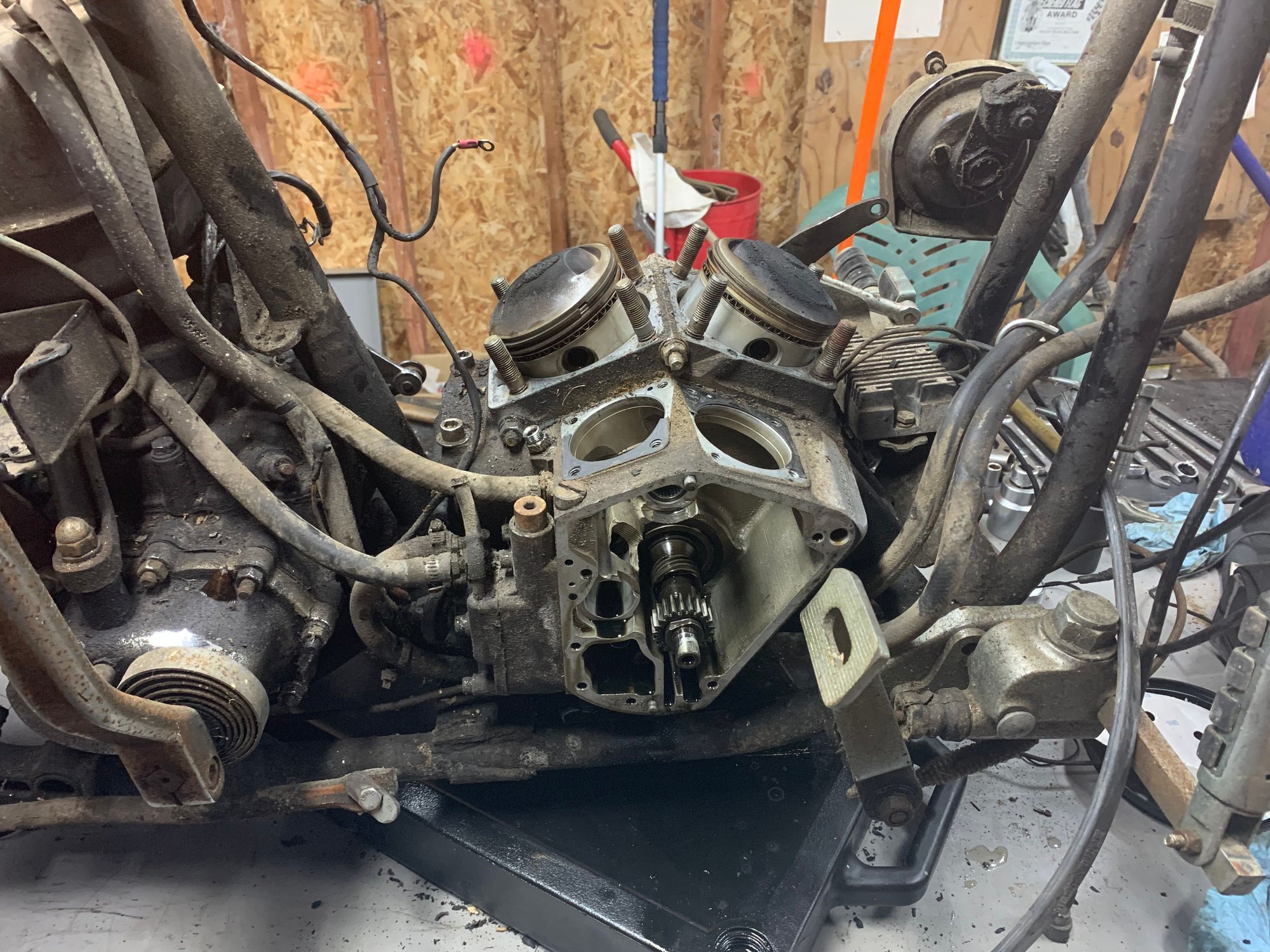

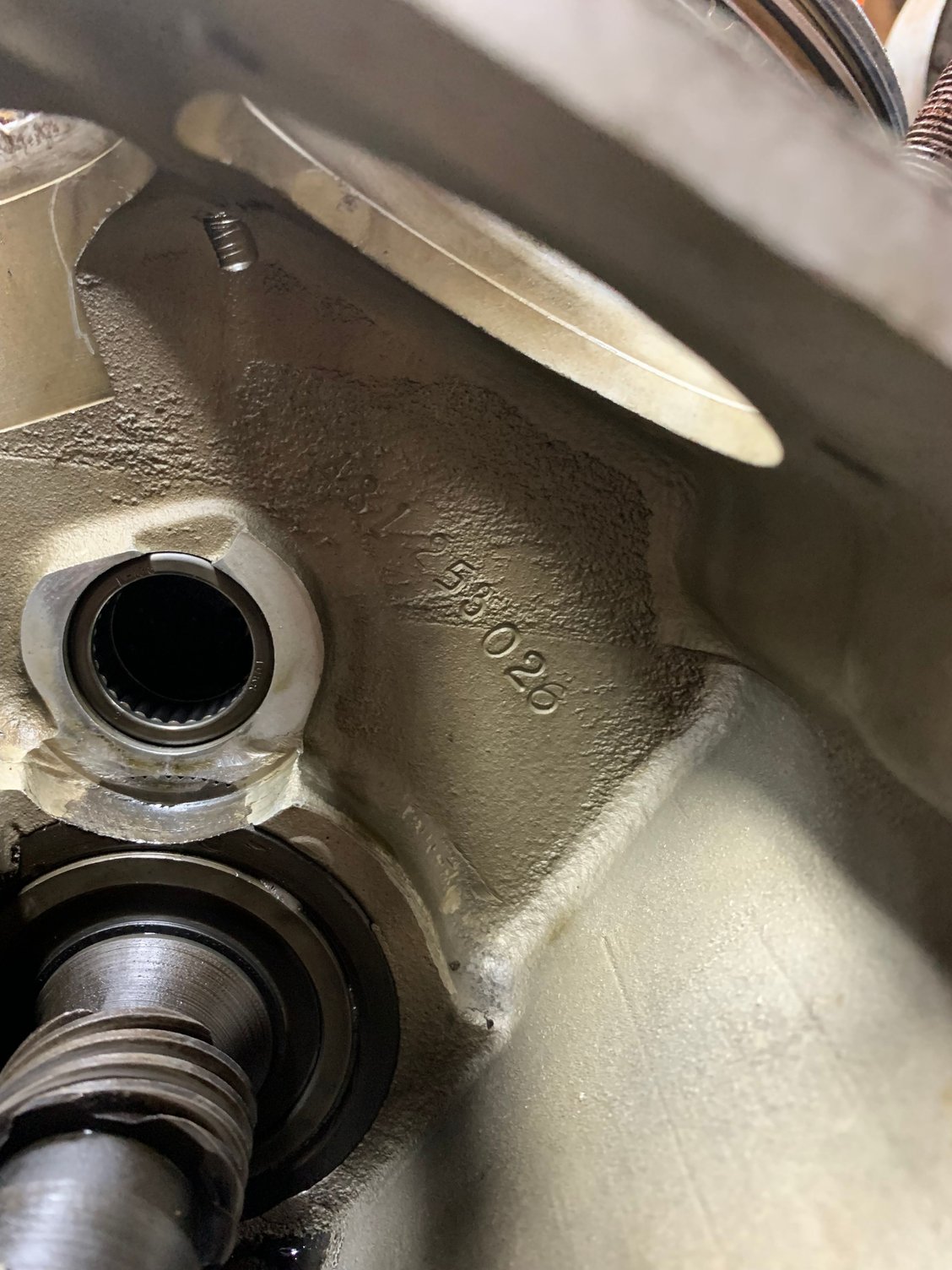

Funny thing is the block was full of oil where it drained down over the years due to the check ball issue that has plagued Shovels for years. Last I heard that problem has still never been resolved. I'll pull the oil pump to see if the walls are scarred up and gears broken from trash going through it. Good thing is the numbers inside the case match the numbers outside the case. The clutch basket was stuck to the hub. It finally broke loose and it was just old oil that glued them together. Oil pump, oil tank and starter is todays goal. Feel free to jump in and tell me what to check. It's been more than a decade since I played with a Shovel. I can do most of this with my eyes closed.
