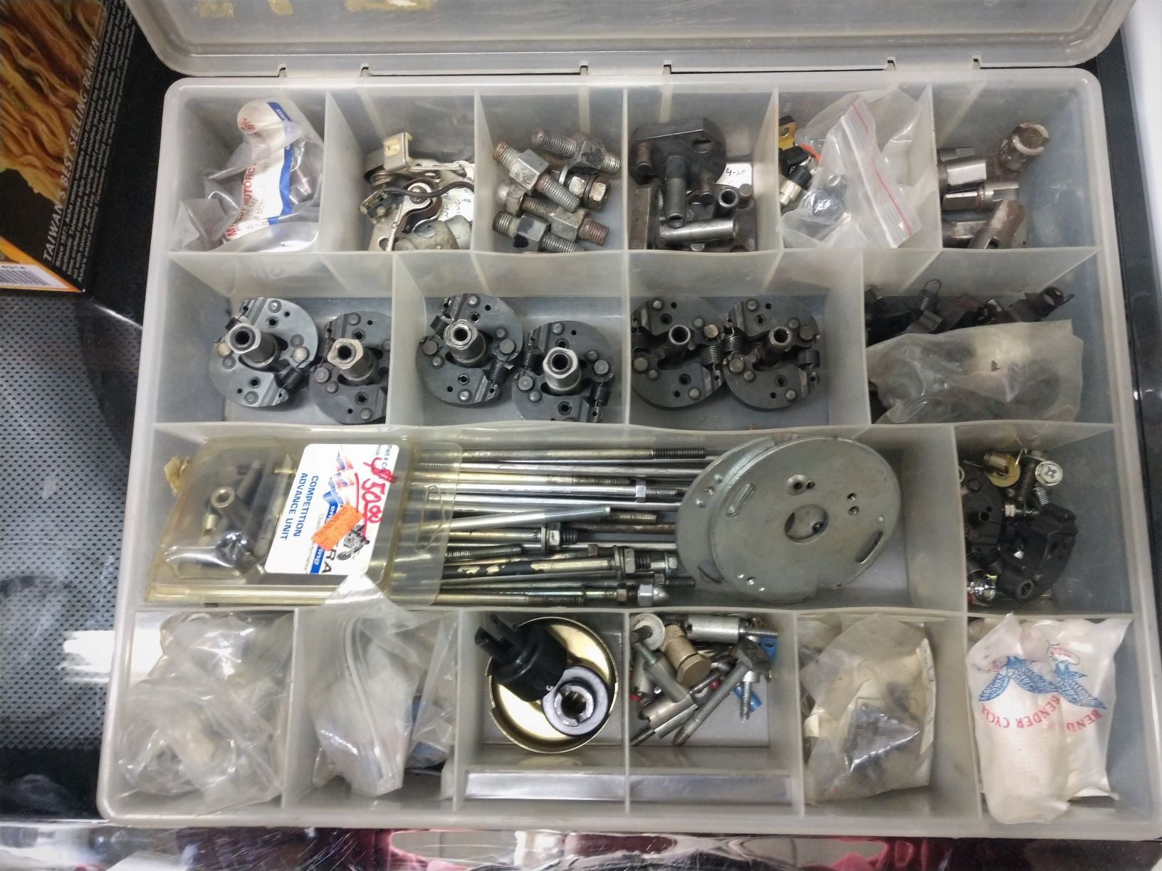

One other over looked item with advance units are the cam lobe that comes with some. Some of the import stuff is way out of spec, like the gap setting between the big and small lobe. I've seen some you set at .018 on the small end and it'll jump to .060" on the fat side. You'll pull you hair out chasing all kinds other things thinking you have the points right and don't. This size of the lobe affects thing too, factory has sharp small ramp, the aftermarket stuff using isn't ground as precise and changes the timing dwell a bit, can make a kick only bike a pain to deal with sometimes.
In this picture, the unit on the left is aftermarket, on the right is factory. See the extra meat on the ramp on the left? And that one was one the way out on the 180 side, bigger gap.
Done this stuff a bit. I keep some rebuilt cheap unit's handy for the usual broke *** or too cheap buddy who always comes begging for freebies.
