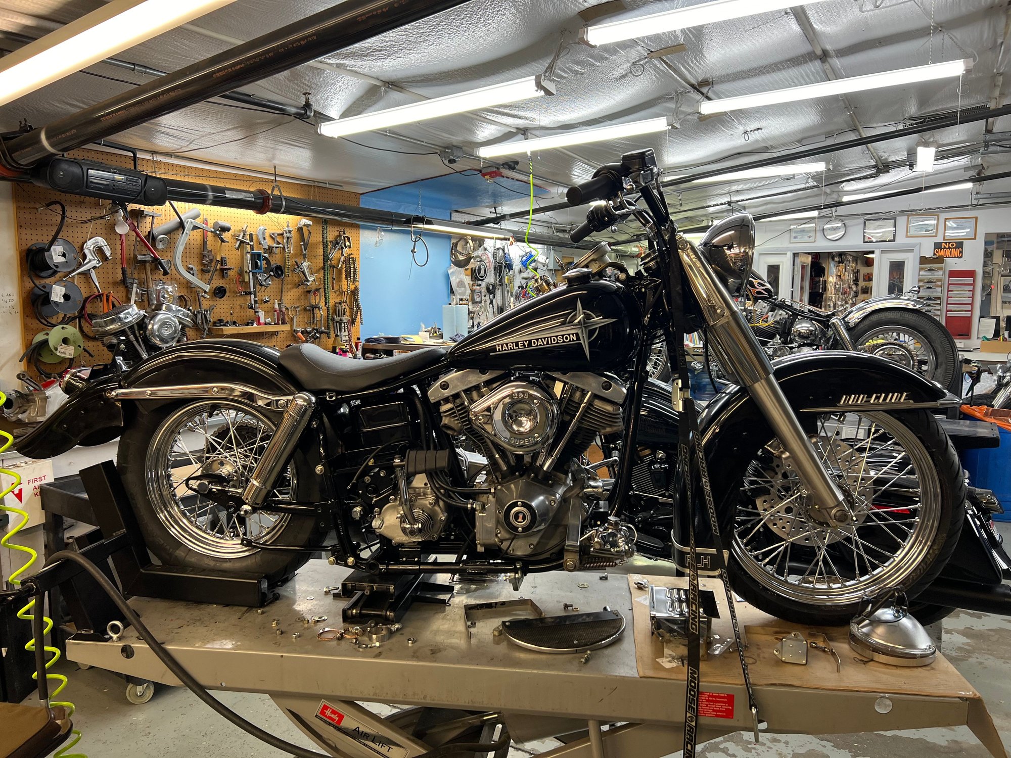

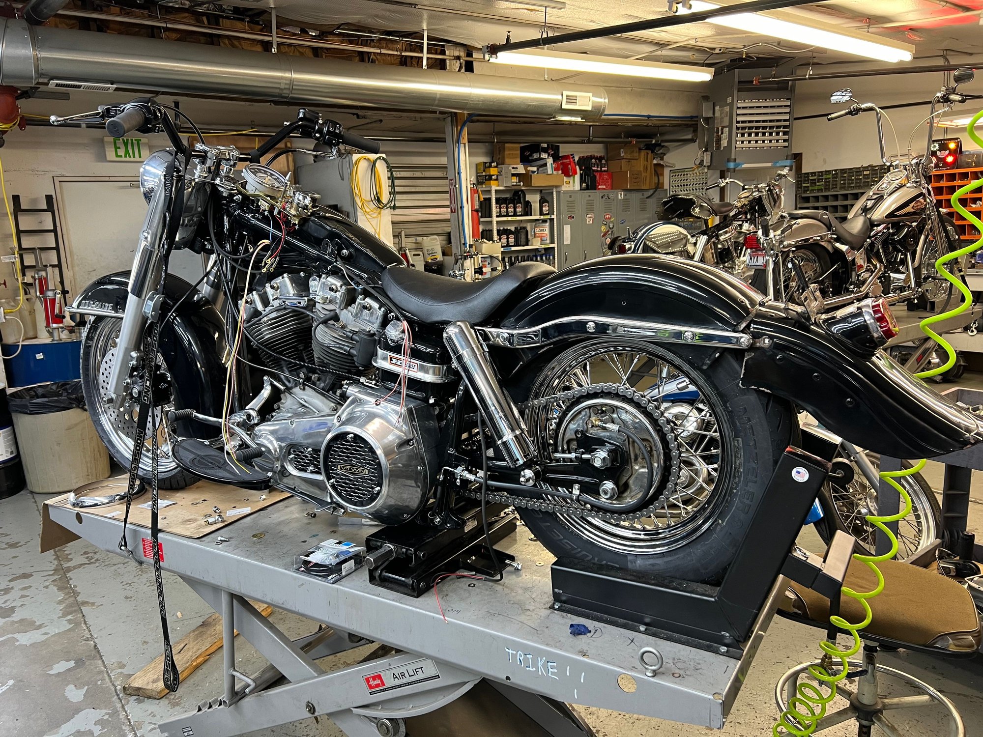

Well I saw my bike in person today. Pretty much at the same point as before. Exhaust out for its finish, wiring underway and some minor fab yet (contorting some re-pop stuff).
Fricken beautiful in person. The tins have more patina in them than the pictures show.
Did I say fricken beautiful in person?
