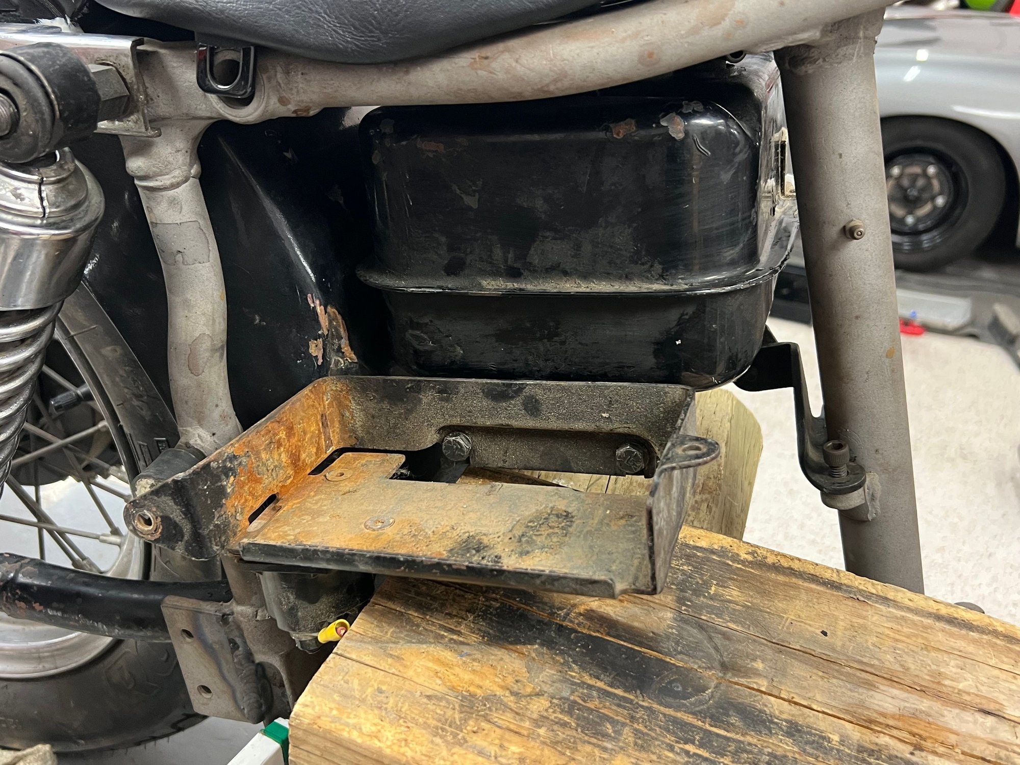

You can see my battery strap hold downs are the opposite of yours, the nut side is to the rear of my bike. Not sure if that changed over the years.
Sure looks like our battery trays are different. As my bike is a Frankenstein who knows what should be on it.

That looks like the same battery tray on my 79 FXS. Maybe FL and FX still had different batteries and trays?
Here's the FX style mounting, goes to the top of the starter bracket:

You might want to consider a wrap around oil tank that holds the battery.

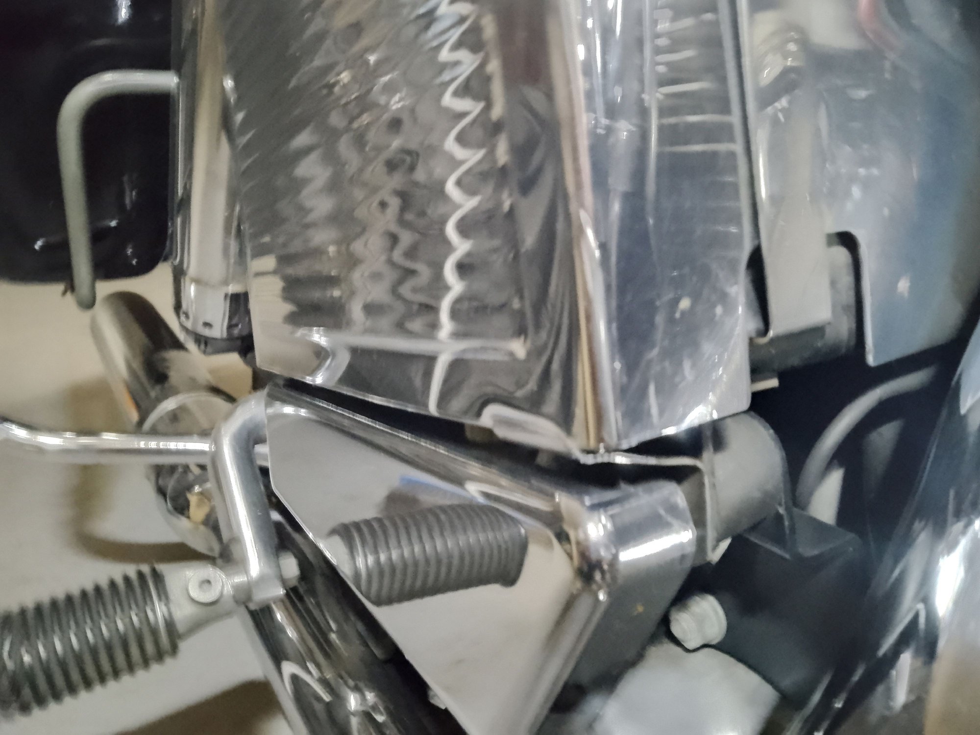

That busted front brake cover is a bummer. BUT it does look serviceable until a replacement can be found. You could also have a welder put in a patch and grind it so it looks decent.
FX kick only is smaller than an FXE or FL box

Here is a number on the right side upright casting. Let me know if thats not the correct location.
Hard to read numbers.
It’s forging number 47652-73 which was introduced about mid-73. On the left forging you may find 47654-73.
Next photo may show the date code. A indicates Jan, B indicates Feb etc. Number indicates the year the frame was made.
These two items look like the H-D passenger footrest brackets that were introduced for 1977 models of the FX-series (FX, FXE etc). You’ll see one on Joe’s bike. Also on Joe’s bike notice the two-hole block at the back of the downtube is lower than yours.

i think i saw a bracket in your first pic that goes on the end of the battery tray via a rubber mounted fastener (i forget the proper name) and bolts to the top of the transmission like my FLH.......maybe?.....................
