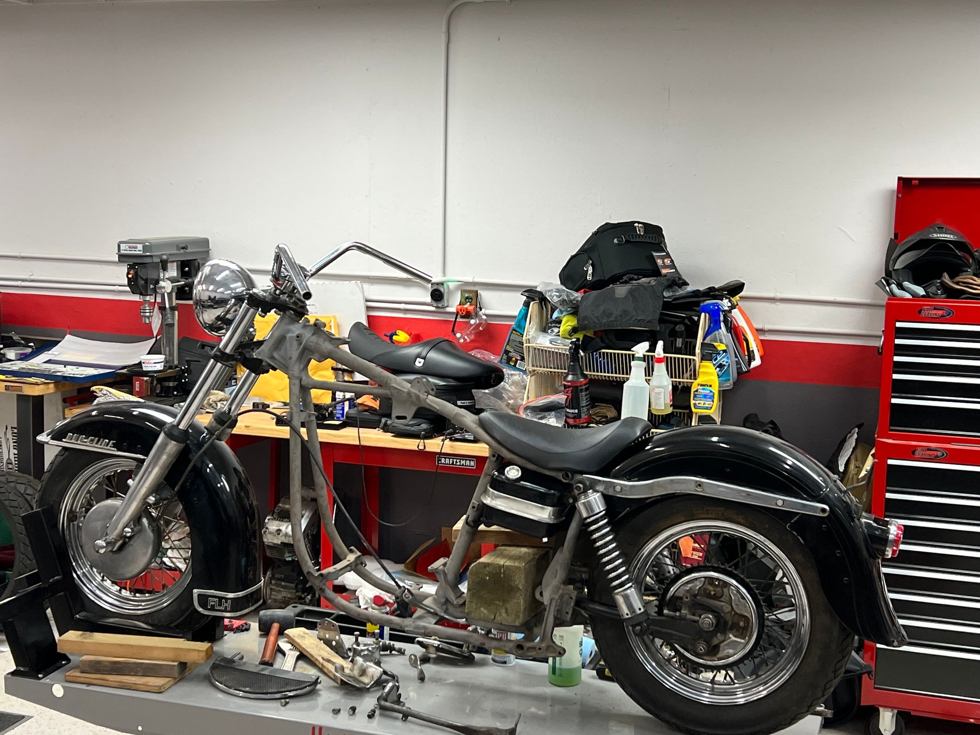

Here is close to the stance I want. With shorter shocks & a 19" front wheel (basically the same diameter as a stock 16") being the adds.
These bars and seat are my first choices ...but we know about change.
My jiffy stand & shift mount is about ready to go on the left side. ...Baby steps.
