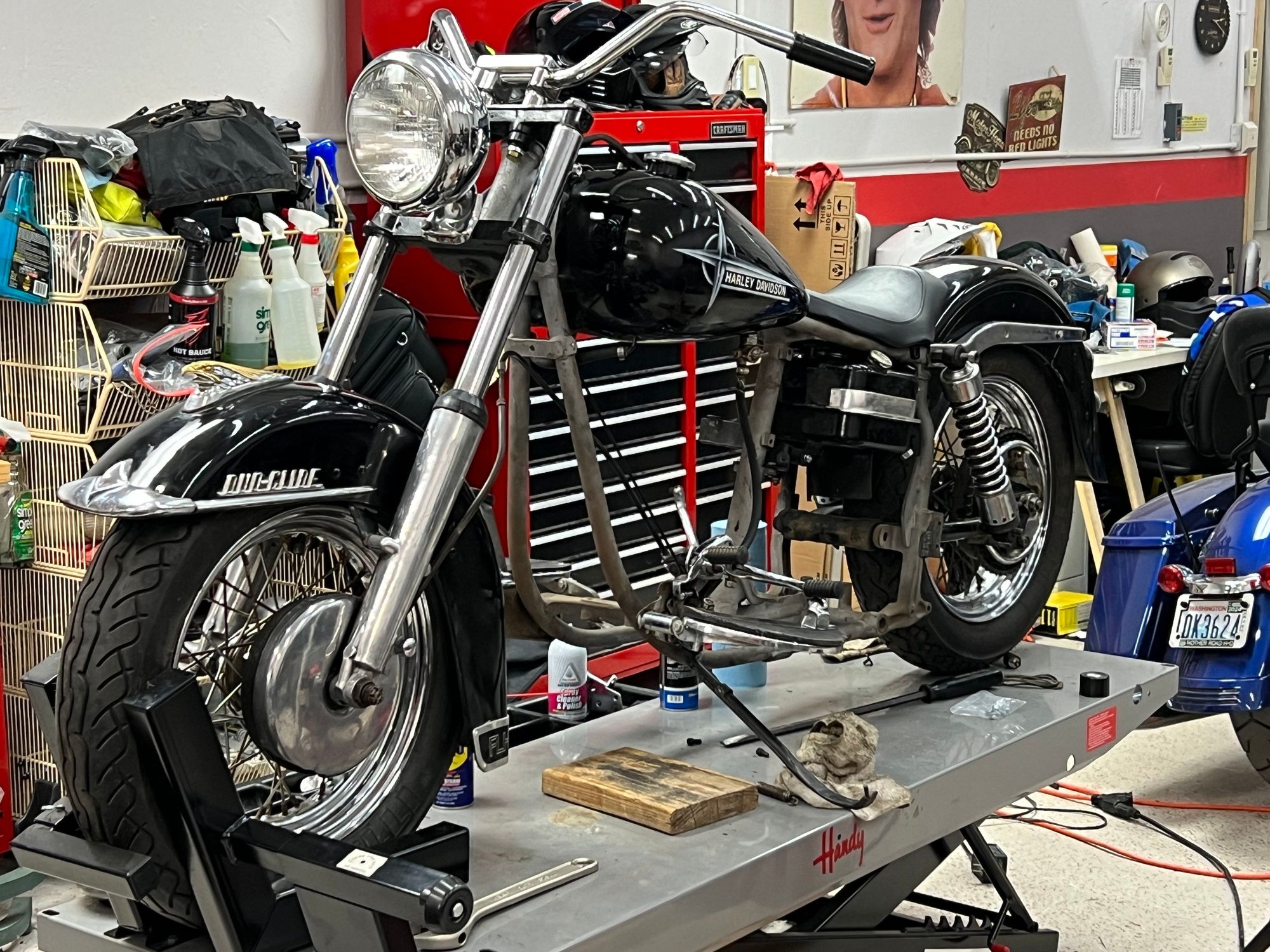

Old May 26, 2023 | 12:44 AM
  #124
Maxacceleration's Avatar
Maxacceleration
Joined: Oct 2022
Posts: 144
Likes: 195
From: PNW
Still picking away at mocking up the old parts on my bike. Floorboards shift & brake bolted up just to get the feel of it.
I am just starting polishing on the sliders, then I will rebuild the forks, new seals & wheel bearings.
We (here) have thought this bike could be a 4" over front end... It really looks pretty decent & raked out... Thoughts on keeping it 4" over (if thats truly what it is), or reducing to 2" over, or stock. Hmmm
I may forgo the nacelle & cowbells and run it more bare up front as it is now - debating that.
I may fit the engine, trans & primary in just to see how much this bike will settle. But my plan is rebuild the forks, press in neck & swingarm races/bearings, and then go for a powder coat of the frame & swingarm. I will have assistance lining up the primary, routing oil lines, and help with electrical too.
Oh, I may use some naval jelly on my corroded chrome parts. I have had good luck with naval jelly a time or two in the past. Very nasty toxic stuff though.
Baby steps...

Maxacceleration, good looking roller so far. Thoughts...if you keep the extended fork tubes, isn't the lean angle, once the bike is on the ground and on the side stand, gonna be pretty extreme?

Old May 26, 2023 | 11:00 AM
  #129
Maxacceleration
Joined: Oct 2022
Posts: 144
Likes: 195
From: PNW
Yes could be. I will probably take the front end down. The bike will be lower for sure.
