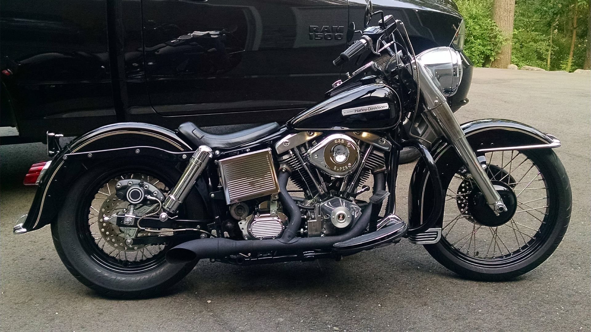

My goal will be like this pic below in a basic function. ...A sweet bike I found on A Dennis Kirk Garage page.

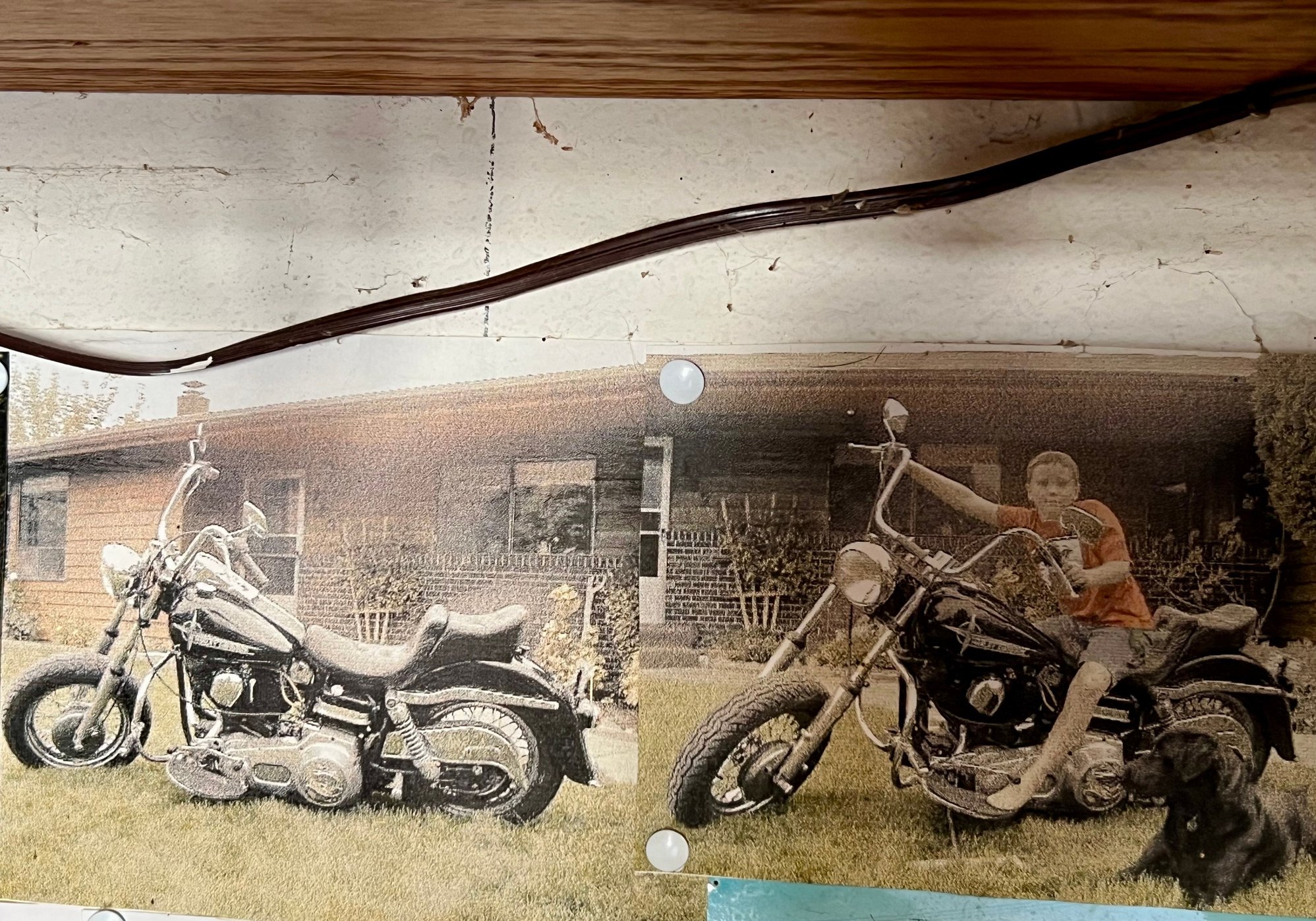

Only two pics I have so far of the bike assembled in action, right before it was torn down apparently 15 or so years ago. The kid is now 25-ish.
Starting to look like a mish mash of parts like so many older H-D's.
