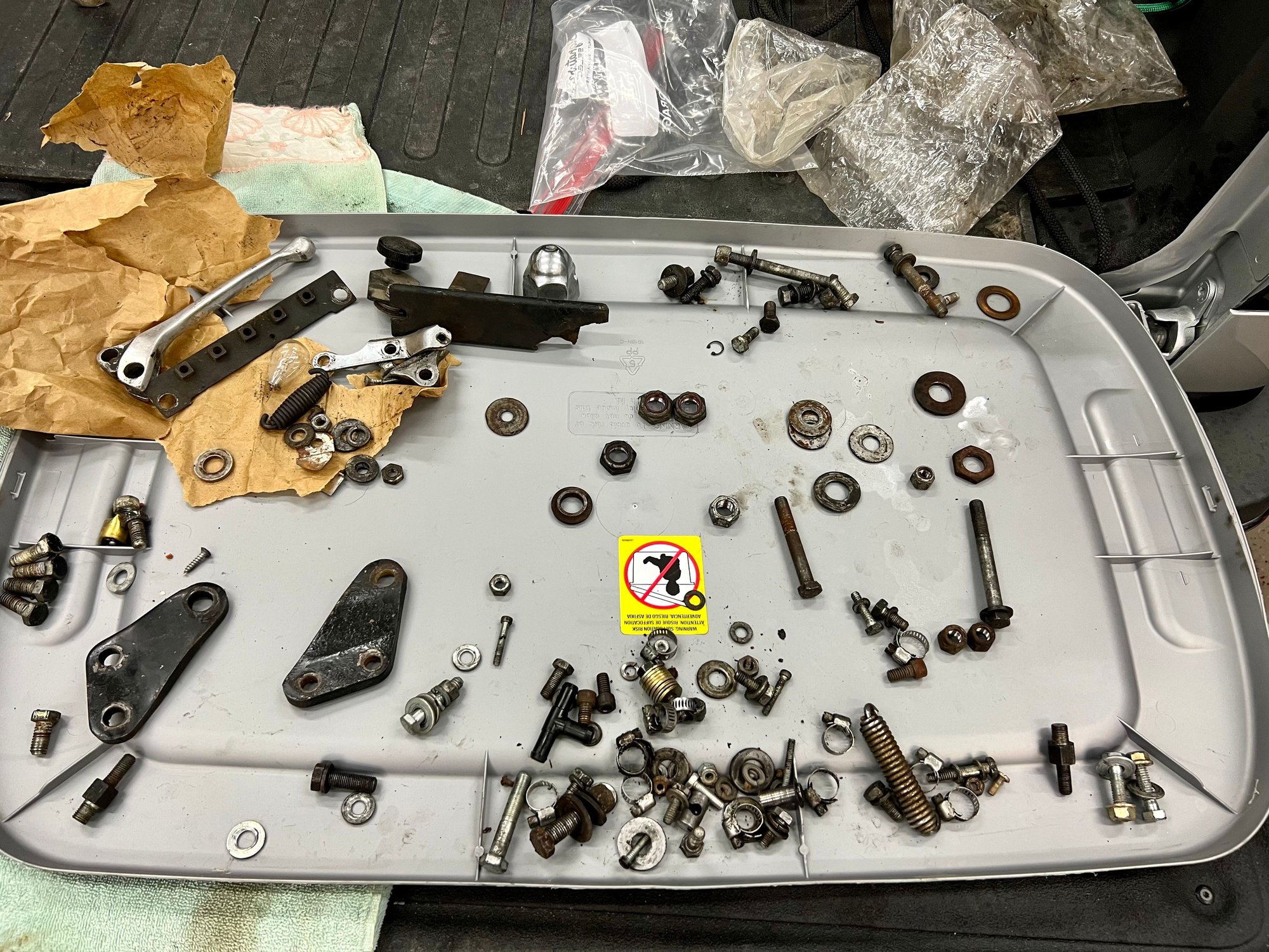

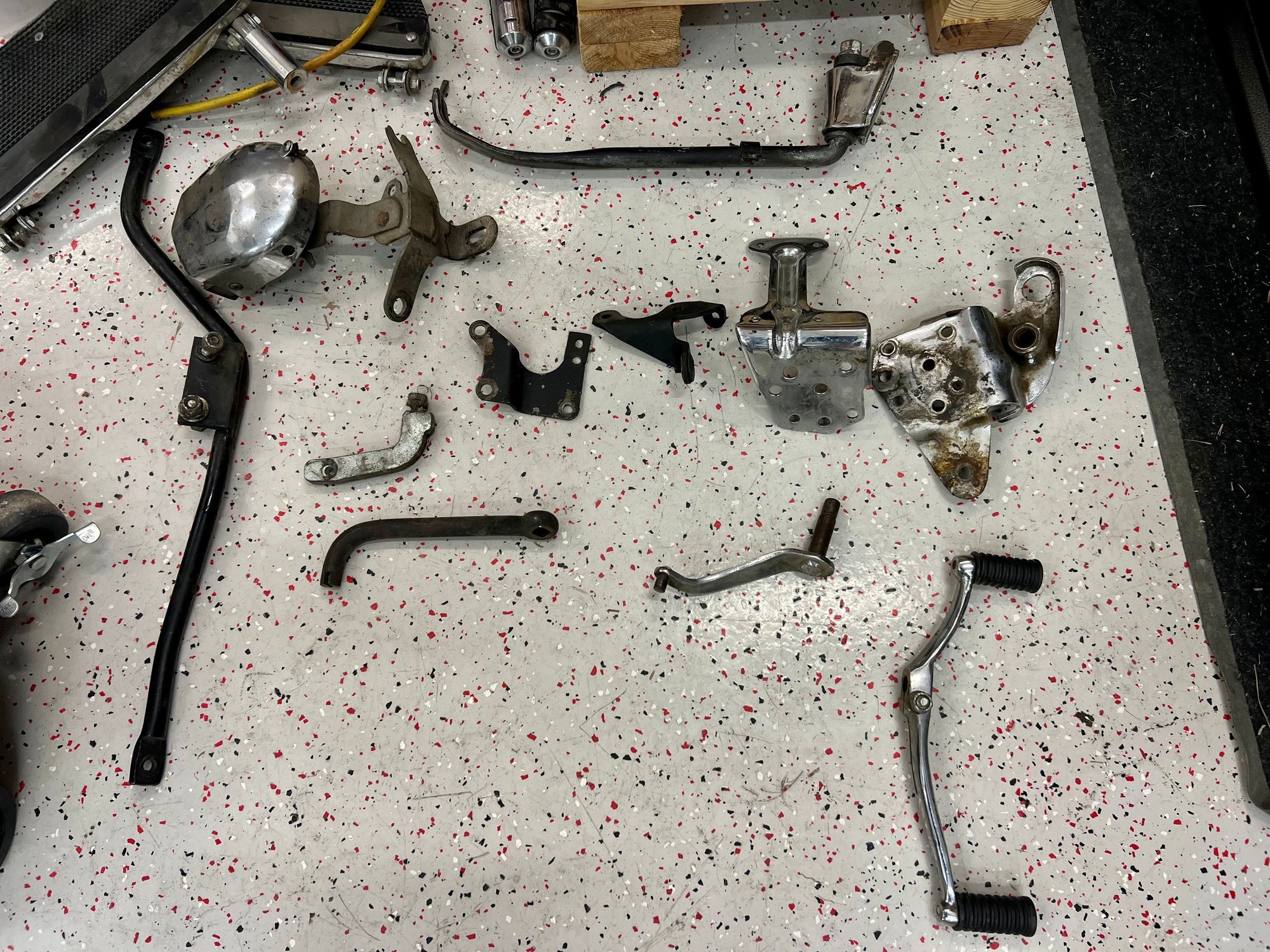

And more of not much. Wasted used up bolts, and bracketry I am unsure of.

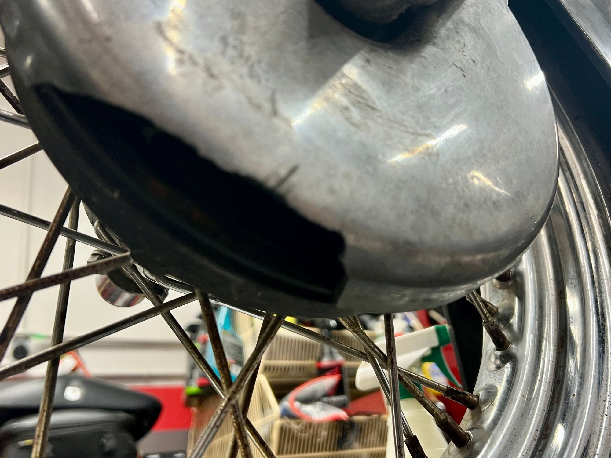

A broken front drum cover (big bummer), and well... Making lists of bolt sets I will need.
Plus studying illustrations... I am a first timer at this.
I am very bummed about this, didn't see it until a night or two ago. I feel it could be ridden without issue? Not that I aim to... I was just going to cheap out and run the drum front end.

There are quite a few very useful and needed parts there. Far from useless junk! You need most if not all of those parts.

Throw nothing away!!!!!!! What looks like junk today may get you out of a tight spot three months from now. Hardware that looks random becomes real important when you need that one bolt. Carry on.

Not tossing anything guys.

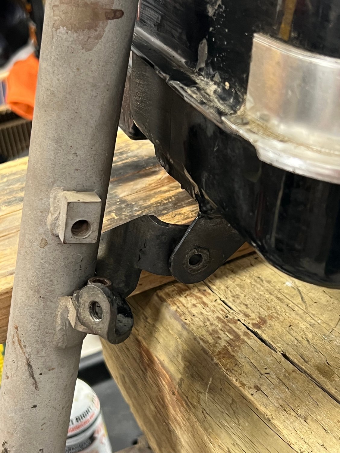

I sure could use a square oil tank bracket orientation picture. Same goes for the fuel tank. The exploded views show the parts but not really how it all goes together...
Basic I know, but my random parts pile ain't helping me. I been scouring for pics & videos but I'm not finding what I need.
I have a tank mount kit and oil tank isolators/bolts kit coming... Looking to order up engine & trans bolts...
Figuring out the floorboards is also high on the list.
I don't think my oil tank & battery mount is quite right... (plus fitting in fresh isolators)

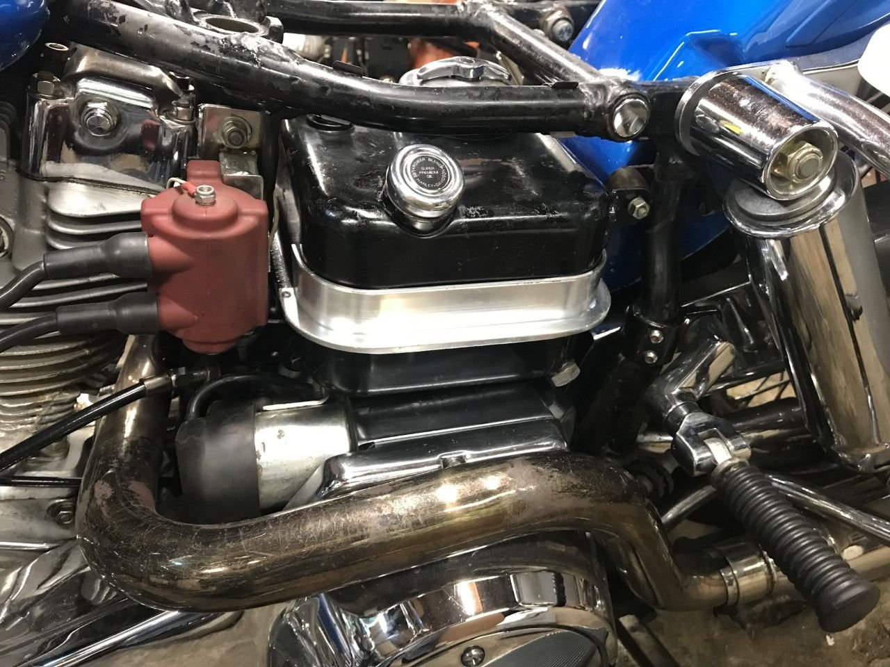

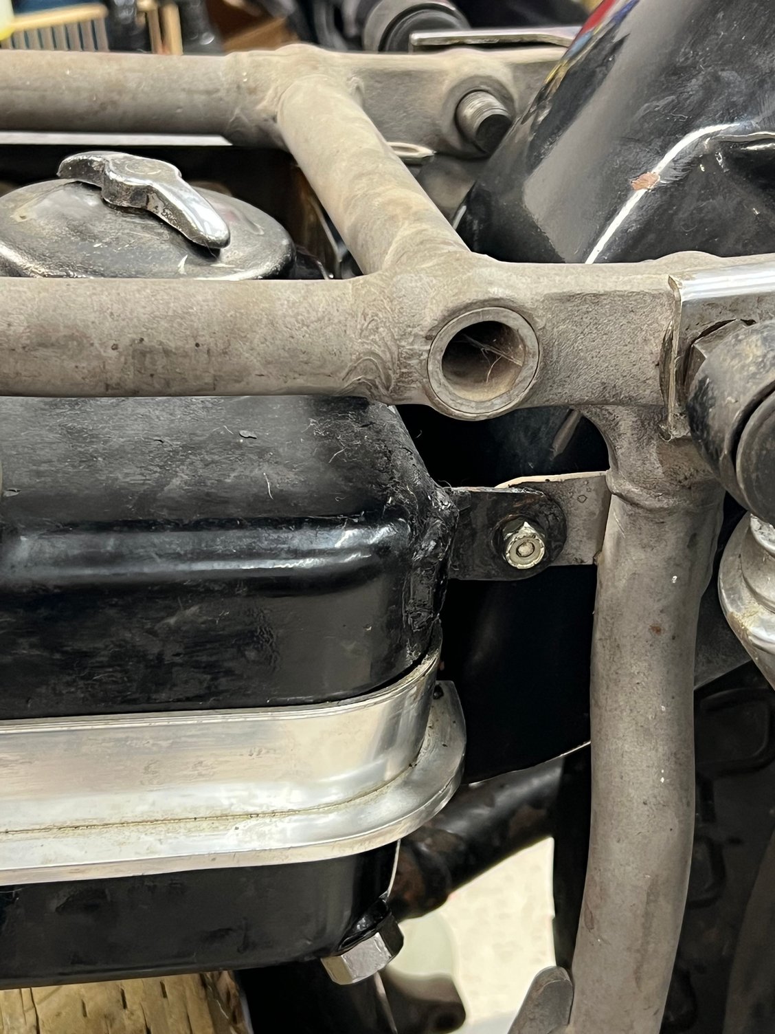

Some pics of the oil bag and battery tray, form my 1970, looks like you need to dig around for the rubber mounts:

you need an isolator here too

Thanks gentlemen, most helpful. I have isolators on the way, and maybe I have a mis-matched battery tray if thats possible. We'll see.

You can see my battery strap hold downs are the opposite of yours, the nut side is to the rear of my bike. Not sure if that changed over the years.
