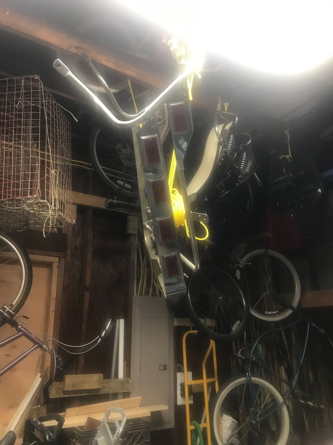

Originally Posted by commander47
I want that light bar that wraps around the rear of the bike!

I got a great deal on the light bar and 80 inch fender tips for $100. It's out there you just gotta wait

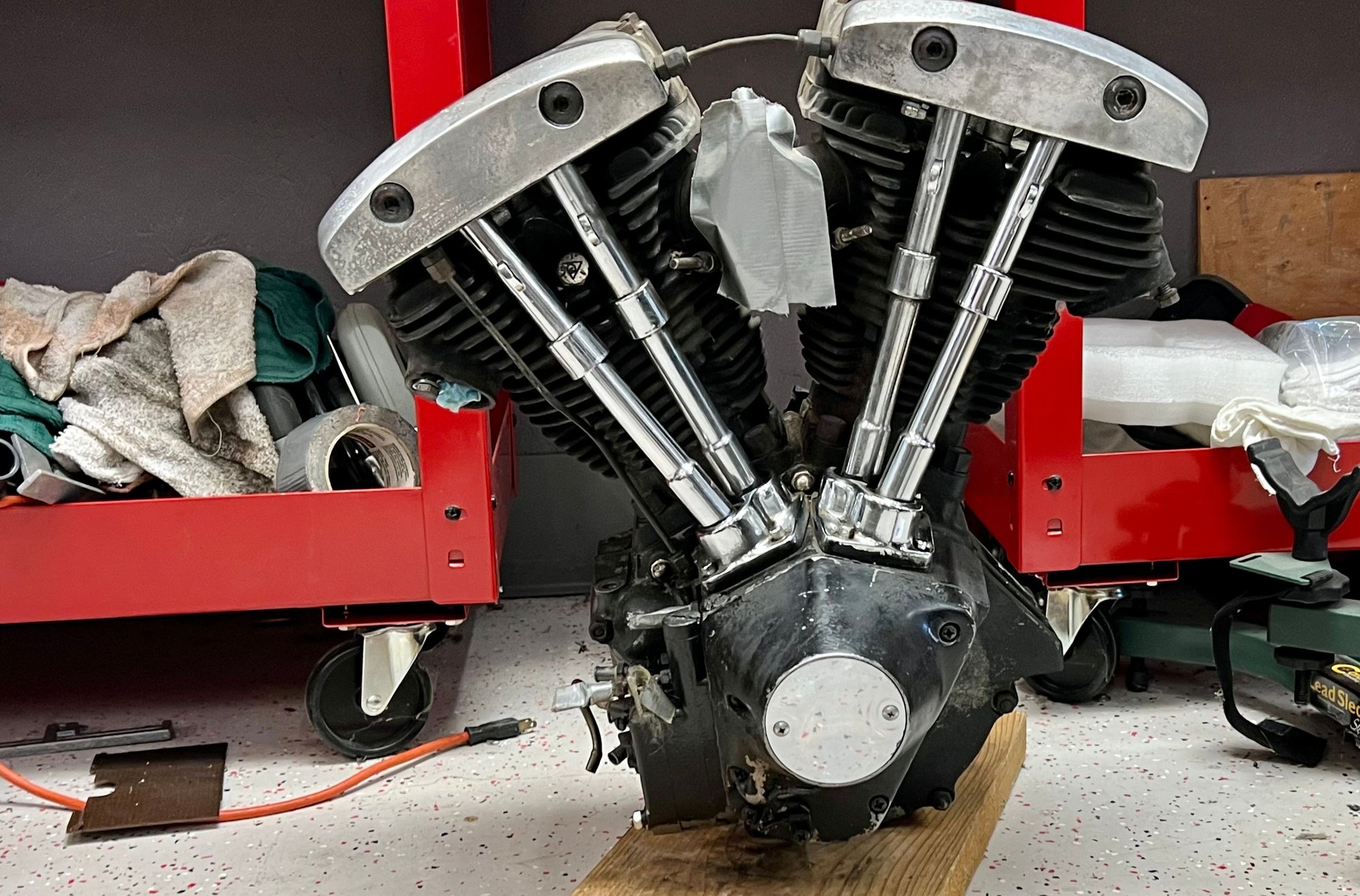

From: PNW
Well the engine numbers match the frame! I am kind of surprised with all the mix of parts this bike has.
I have the swingarm on but am not sure of the orientation of the axle. Does it insert from the right, or the left?
Oh, I have a pretty nice speedo... And an S&S Super E too!
A lot of cleaning coming up...

On the tubular arm the axle goes in from the right side, the flats fit in the slot of the arm.

From: Western Australia
Originally Posted by Maxacceleration
I got the frame VIN# today…
2C = FX1200?!? Production number 68xxx H3 = 1973?!?
Looks like a nice project. Two frames for 1973 Shovels. Yours appears to be the later version and that would be consistent with the VIN, provided of course it is authentic. (No offence meant.) I’m not sure why 1973 Shovel VINs went that high but I’ve seen several at 63+++ thru 71+++. And a few at 91+++ which may have been on replacement cases.
I’d expect the lower left rear forging number to be 47654-73 and the lower R-H rear forging number to be 47652-73.
I imagine the gusset plate in front of the left rear downtube is original to the frame. It was fitted as original as of about mid-68 models but it was available as repair part #47261-68 for frames back thru 1958 models.
Blocks at the back of the rear downtubes are not original. H-D attached rectangular two-hole blocks in that area as of 1977 models and they were a bit lower than those.
Swingarm is 1963 or later. I’ll guess somewhere from 63 to about early-67 judging by the position of what may be a hose clamp screw? Forging ID may be on both axle clips. For more info about round swingarms here’s a link to a thread I started on the Panhead and Flathead forum in 2016.
https://www.hydra-glide.net/phpBB3/v...ic.php?t=15801
Regarding the one-piece handlebars you already bought, you could cut them in half to suit the handlebar clamp that came with the bike. I’ve done it with several bars over the years.
Eric

Thank you for your knowledge Speeding Big Twin (and everybody's knowledge). I will research. Oh I cringe at the thought of cutting bars in half!
I am collecting a few parts atm, and will be cleaning & scouring what I have. Slow going for a while...
I will keep pics coming to show what I have and for identification.
