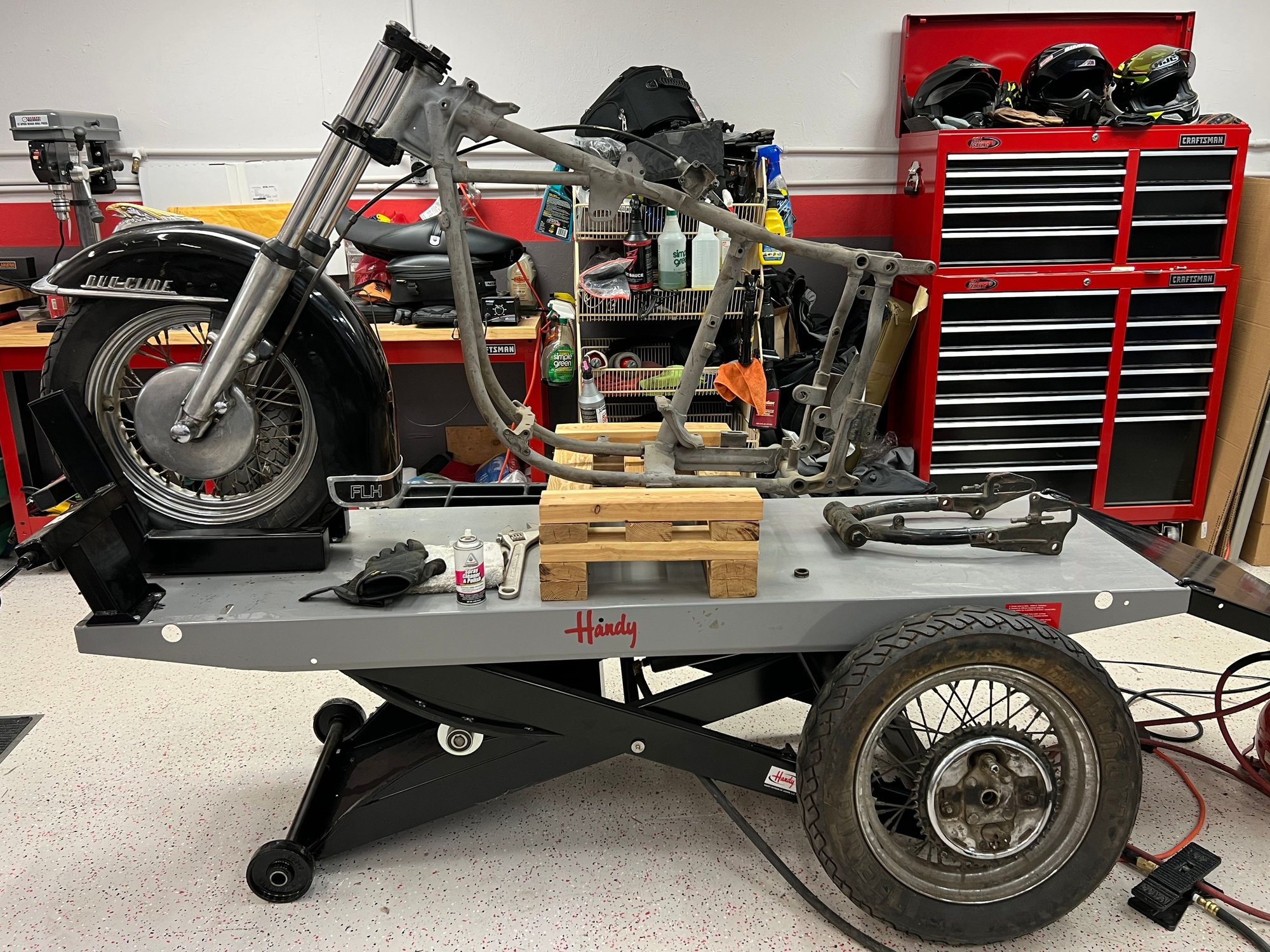

Well Damm!!
Picked up my basketcase today. ...Pretty exciting. I keep learning more about this bike. A Frankenstein bike would be a good nickname.
Mixed years of parts. Its a curiosity as to why.
But there is much good in it, as its very complete. No rashed out parts, gotta like that.
Just a couple quick pics for now. Did an initial clean on the tins and bolted up the forks. Not so bad!
My number one question for tonight... The bike has two piece handlebars and the clamps that go with it. Are there handlebar clamps that will bolt to these triple trees so I can run normal one piece bars? (I already bought one piece bars)

Aftermarket or stock later clamps bolt right up, just avoid cheap pot metal versions. Also inspect the frame downtube where the cast motor and trans mount welds on, they tend to crack there also the left rear down leg that runs behind the primary, another crack prone spot on them.

Yes, I'll admit it. I'm jealous!!!!! Wish someone would give me a basket case with a rebuilt motor!!!!
Depending on where and how big the crack is the tranny case can be welded. If the crack is across the seal face it may be better to get a new case. I see this as being your biggest money pit for now. You need the tranny so this should probably be your first priority.
The sky (and bank book) is the limit for you. Build what suits you. There is so much you can do with this. Set the frame up somewhere you can start hanging and mocking things up.
Start with the stock parts you have. See what works for you, what looks good. Make an inventory of serviceable keep parts/not serviceable not keep parts. Then divide the not serviceable parts into two piles of garbage and trade/sellable.
Make a list of the bike swap meets and start haunting the bike shows you can get to find/trade parts. (you might want to shop that cracked tranny around and find someone who needs one)
An old shovel is never really done. You will find yourself wanting to add/subract things over the years. They are the Lego Blocks of Harley.
I would caution you not to modify any stock parts such as the frame, forks and motor. Hot rodding the motor is one thing, but throwing out cylinders, cases, etc is something else. (unless you have to)
Your bike looks awesome!!!! I would definitely keep the old brakes. Just my personal preference as I love the look. The forks look like late model Showa, but i"m not sure. They look good. Old style swingarm, definitely cool.
Enjoy this bike, it will give you decades of pleasure as mine as given me. Of all my bikes, my nearly 50 year old shovel is my favorite. Just walking over to start her up knowing I"m going for a ride puts a smile on my face.

... they tend to crack there also the left rear down leg that runs behind the primary, another crack prone spot on them.
Looks like someone welded on the later model gusset there, so that's good.
