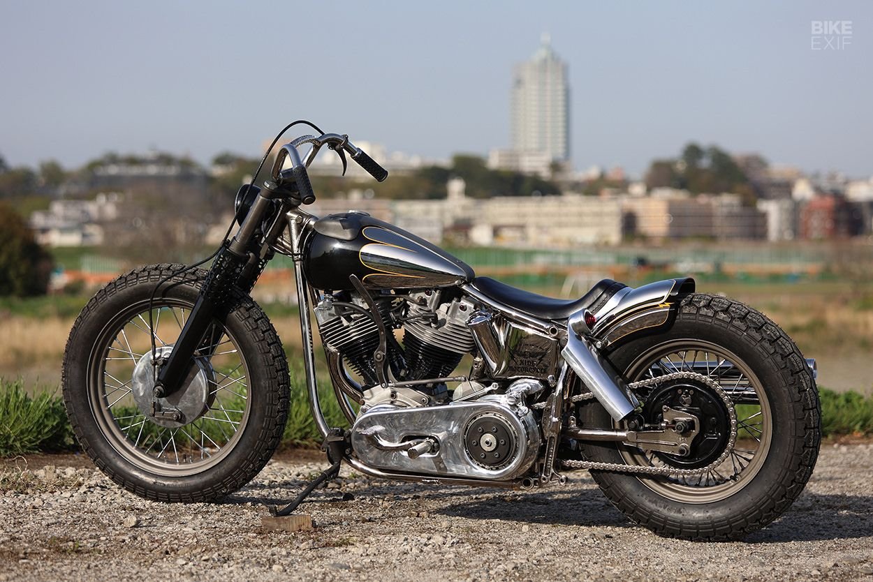

Here are two very different 21" setups. A Wide Glide chop style, and a 21" stuffed under the FLH fender.
I happen to like both. My bars will be similar to either.

I like the 21" on the front, both examples above look good. If you want to keep the fender, cool look, I recommend lowering the fender. Drill out the rivets holding the supports and install plates bringing it down closer to the tire, would look slick. I know they make kits for newer bikes, might be able to work on a Shovel since HD didn't redesign that fender for 40 years, good luck.

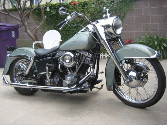

My goal will be like this pic below in a basic function. ...A sweet bike I found on A Dennis Kirk Garage page.

If you are after this look I think that the front fender here is late model, the sides are not as full. Maybe designed for a larger diameter wheel ?
that bike is a beauty. nothing looks out of place

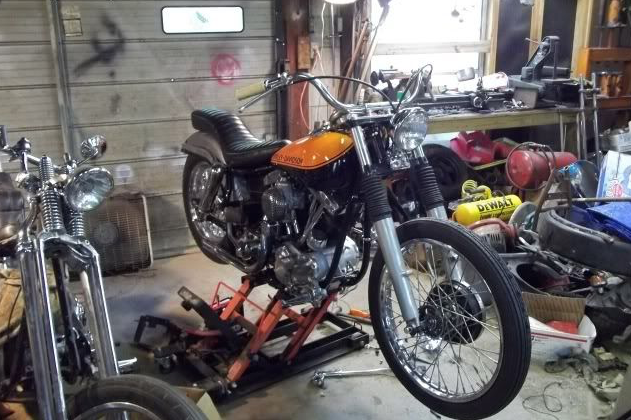

I believe I have made a decision on wheel diameters. 16" rear and 19" front. I think that will be enough of large diameter bias in front.
For a visual reference on 19/16 wheels here is a pic solely for wheel size. Not a direction I would go, but I like the wheel size balance.
