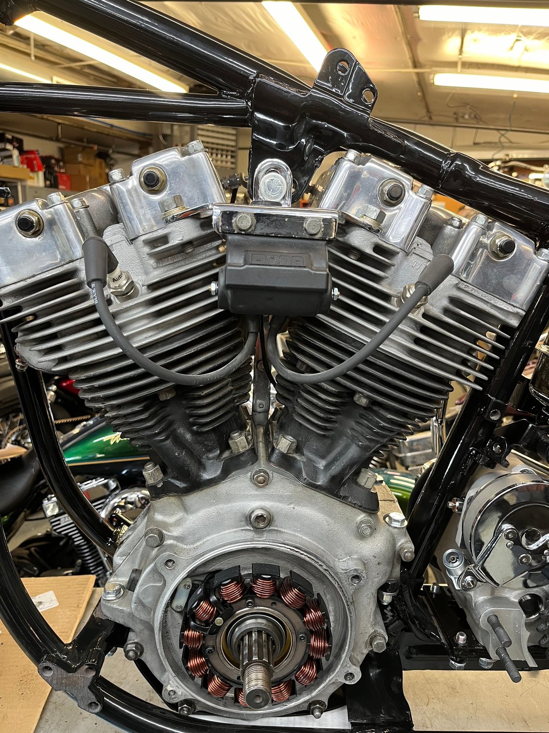

More progress. Noticeable details on my style build... With thanks to my refurbisher, a one man show. A long ways to go yet.

A little more on this bike. It will be a restomod. Parts & parts sourcing beyond the bike that it is.
As to panz question, 2000 era sliders with 2003 era Sportster caliper. Its a combo my refurbisher is familiar with. Mechanically sound is the goal.
His knowledge & skill will be credited when we get through this. We're on a roll.

More progress on Frankenstein. Oil lines & electrical are in. Basic custom wiring vs a stock harness. A few legal bits missing but are pre wired.
As seen here proper fitment of the exhaust is not set in place yet.
An interesting mix of old, older and newer than '73 will be on the bike. Personality but not purist.
As it works out a lot of parts have been needed, more than I expected. But I will have a better bike for it. Still some original patina here & there.
My refurbisher friend is competent and works at a good pace. Thankfully he has experience in Knuckles, Pans & Shovelheads. And cross matching parts between era's if/when needed. I think maybe for a better more interesting bike. Funny, my bike is not the only FX built up as FLH. I'm a bit surprised at that.
