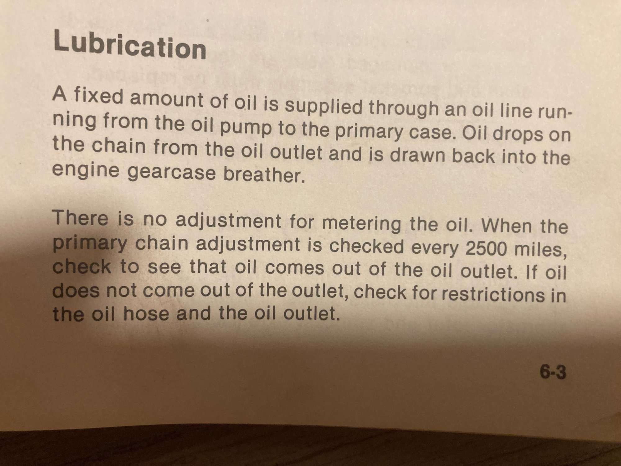

Originally Posted by Baird
The adjustment screw, is for the rear chain only. The manual quote pictured is wrong. I might guess its not an official HD publication.
The oil flow is controlled by the timing of the breather valve and partial vacuum in the crankcase.
Rethinking this, you are correct. The adjustment screw is for the rear chain. Thanks for correcting that.
Paul

Originally Posted by jimessbee
I am glad it looks ok to you, but the service manual says there is no adjustment.
mine has a adjuster

does have adjuster screw
Old Sep 24, 2023 | 05:14 PM
john lee's Avatar
john lee
Joined: May 2018
Posts: 2,171
Likes: 435
From: australia
sorry its the rear oil adjuster
I am having a hard time imagining negative ramifications of it being too much. But would love insight.
from where I'm sitting, it looks like there is so much oil coming out, the primary won't be able to suck it all back out.
carl

It's been a while since I watched the oil flow from the primary chain oiler, but the amount of oil is about what I remember. The chain does a good job of slinging the oil around to the parts that require it. But I did incorrectly remember that the screw on the oil pump controls oil to the rear chain.
That said, many people eliminate the oiler and return because you are cycling oil from the primary that likely has some metal shavings and clutch material into the engine oil. And, notice that they do not do it that way on newer bikes. I changed mine over a long time ago and simply change the primary oil once a year.
Paul
